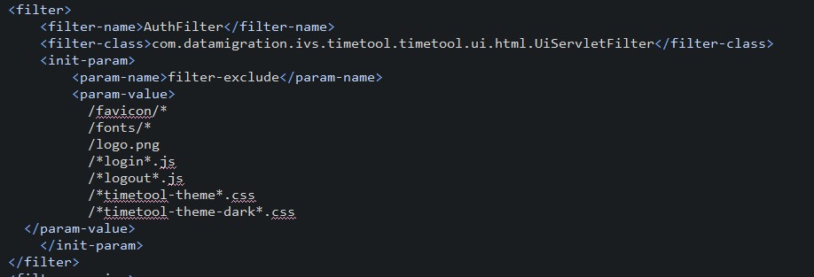

Today i tried migrating my Java Scout 10 Project to the Scout 11 version. I did all the steps from the migration guide. But if i run project, i get the following error:
org.eclipse.scout.rt.ui.html.UiServlet.sendNotFound(UiServlet.java:275) - 404_NOT_FOUND: GET /login.html - MDC[]
I also changed all the entrypoints, i changed the filter of the web.xmls, i changed the start script to the new one.
I just don´t know what to do, i also made a new hello world project to compare it but i couldnt find any big differences.
Can anyone help?
