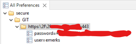

You're trying to encode it in the URI which suggest it's going to be visible if you look at the clone's URI later which also seems not ideal for the same security reasons.
I just let Git prompt me for the password and then let it save the password in secure storage:
index.php/fa/42914/0/
Why not just use that approach?
Re: Git-upload-pack not permitted on Github [message #1857516 is a reply to message #1857515] Sun, 12 February 2023 07:14 Go to previous message
Thanks for responding Ed...ah, great idea!
I additionally tried entering the creds into secure storage as a Preference task before the clone. It picks them up, problem solved!
