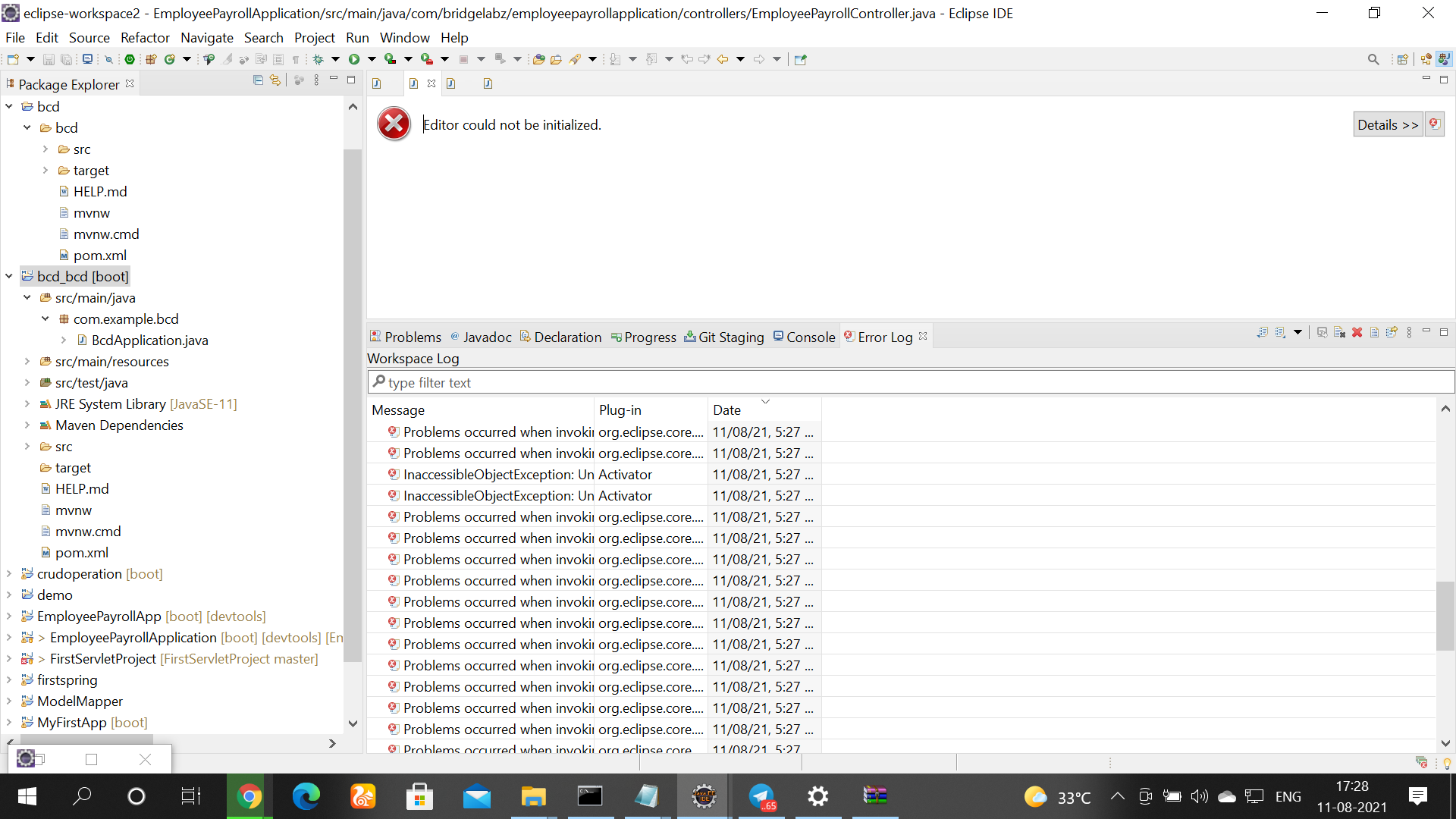

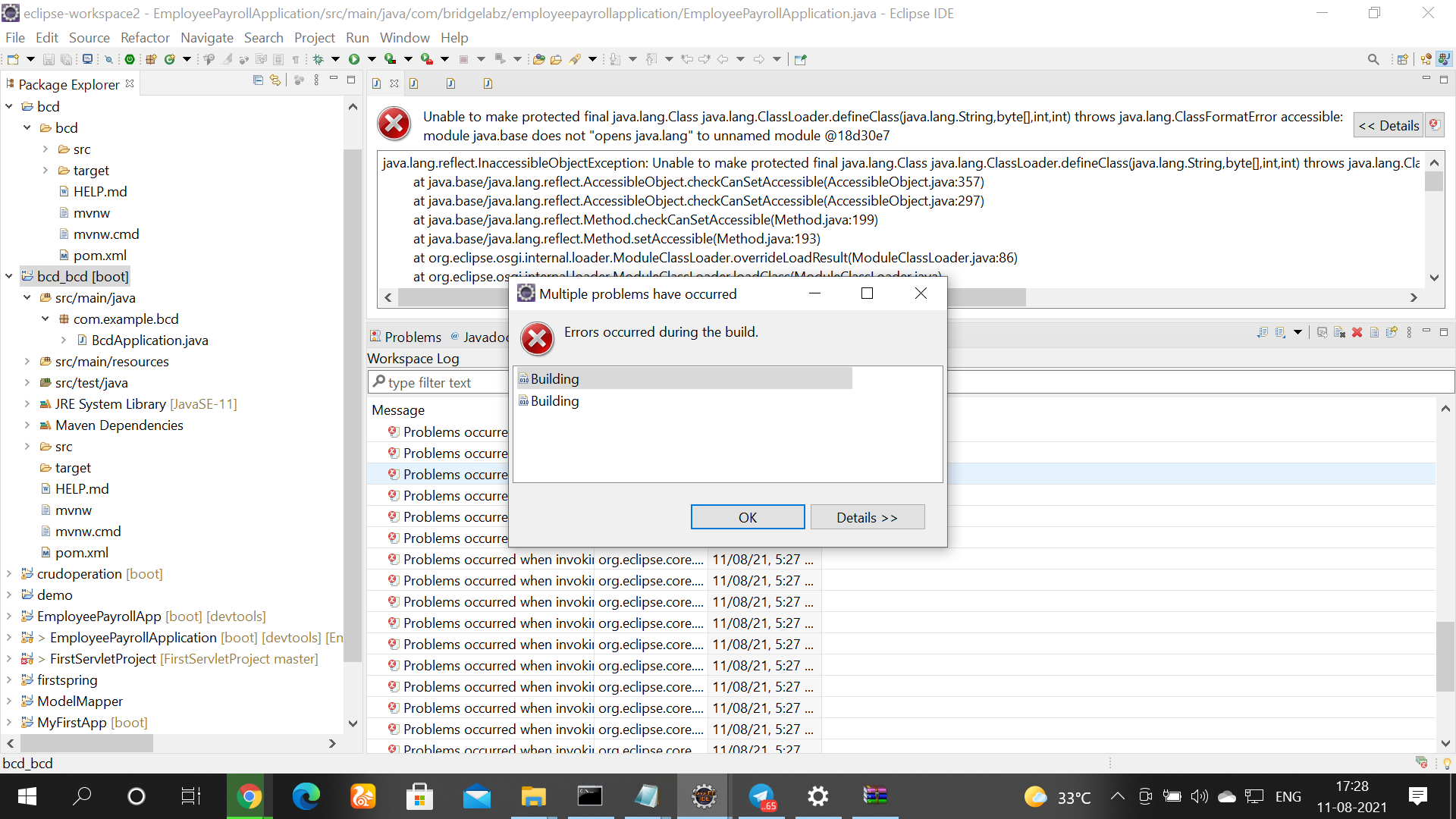

I'm getting build error on any progress i initiate(even is cleaning the project).
Also, getting "editor could not be initialized " error on eclipse startup.
Please help me out.

The issue is resolved.
Current JRE version was 16, After downgrading the version to 11 It's working.
