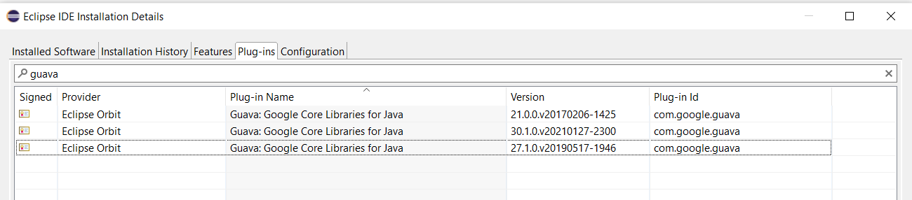

Hello
I just discovered the following "com.google.guava plug-ins" in my eclipse installation details (see the screenshot below).
I am not sure if they are the ones causing the error, but I tried to uninstall them without success because there is no uninstall button in the plug-in tab.
I searched in the "installed software" tab but there is no trace of eclipse Orbit, or guava at all. The same thing applied for the plugin directory on my laptop as I tried to remove the guava plug-in manually but could not find it.
How can I uninstall guava? and which one of these versions I am supposed to remove based on my EMF compare version ( EMF Compare 3.3.13 with Eclipse Modeling Tools Version: 2020-12 (4.18.0)).
