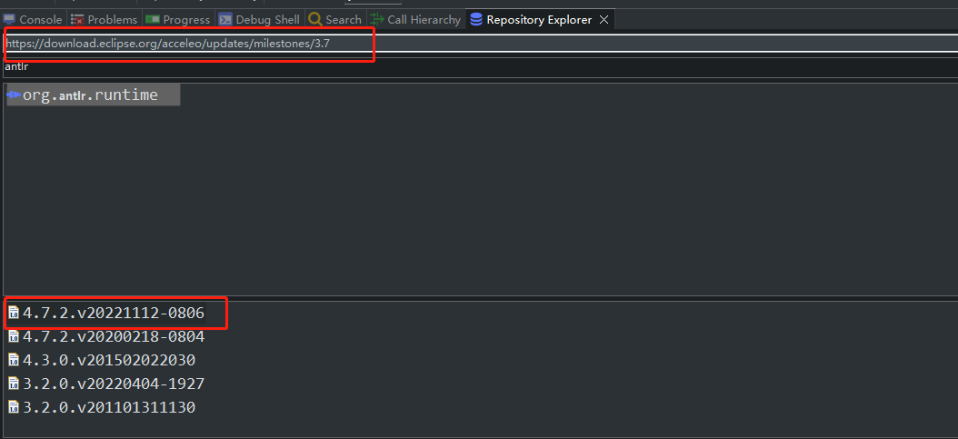

I can see the version in https://download.eclipse.org/acceleo/updates/milestones/3.7
as in the attachments
How can I use it? add in the pom.xml?

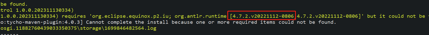

Cannot complete the install because one or more required items could not be found.
Software being installed: RCP Product 1.0.0.202311100121 (wellcontrol 1.0.0.202311100121)
Missing requirement: RCP Product 1.0.0.202311100121 (wellcontrol 1.0.0.202311100121) requires 'org.eclipse.equinox.p2.iu; org.antlr.runtime [4.7.2.v20221112-0806,4.7.2.v20221112-0806]' but it could not be found
[ERROR] [76a098d6-24a9-4b1b-a74d-cd406c8a9373][extension>org.eclipse.tycho:tycho-maven-plugin:4.0.3] Cannot complete the install because one or more required items could not be found.
Where is the iu should be installed?

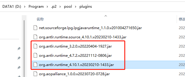

In my project only 3.2.0 org.antlr.runtime is used, there is no place for version 4.7.2. It feels like this 4.7.2 is also coming from the referenced repository. i am very confused about this.
Or is there any way to manually add a dependency file on 4.7.2.
The attachment shows that there are antlr.runtime files of some versions in the local file system.
[Updated on: Sat, 11 November 2023 02:35] by Moderator

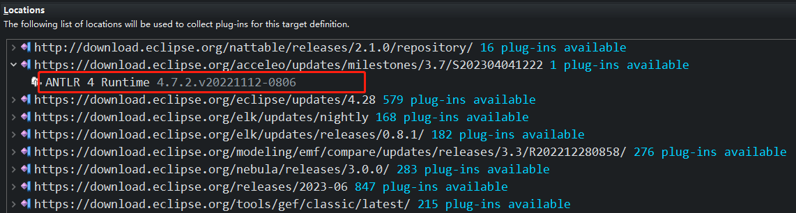

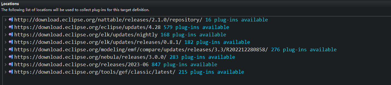

		<location includeAllPlatforms="false" includeConfigurePhase="true" includeMode="planner" includeSource="true" type="InstallableUnit">
			<repository location="https://download.eclipse.org/acceleo/updates/milestones/3.7/S202304041222"/>
			<unit id="org.antlr.runtime" version="4.7.2.v20221112-0806"/>
		</location>
It has been confirmed that this target file has been set as active target platform.
But the reported error remains unchanged.
Relevant information is provided in the attachments
