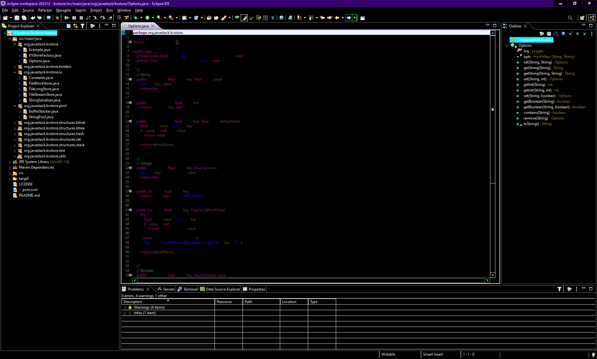

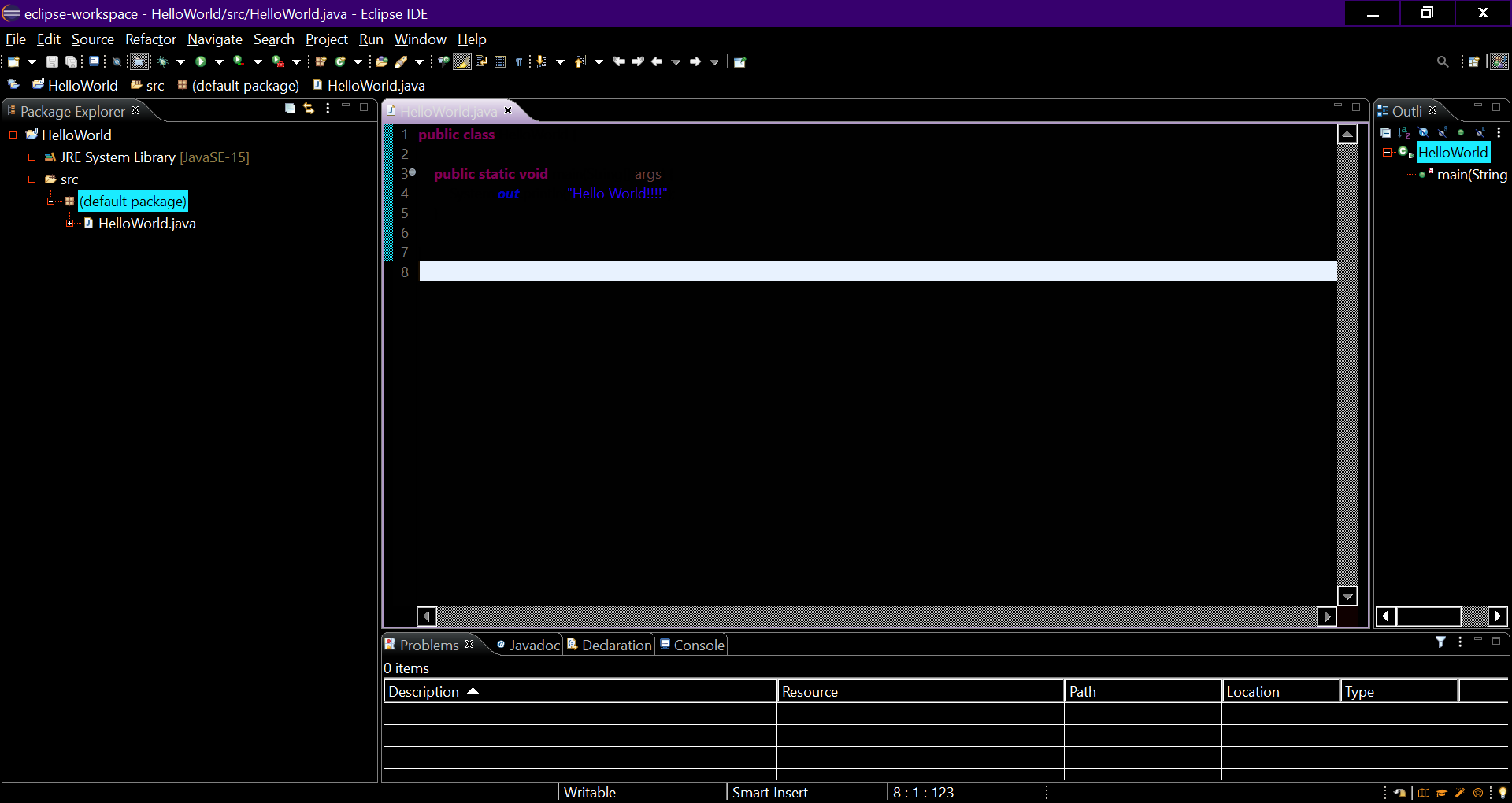

I'm a new user of Eclipse IDE. I am visually impaired and must use a high contrast black color scheme in all of my UI experiences. As such, I have my Windows OS setting for High Contrast Mode set to on and I have selected an OS color scheme of high contrast black. I guess they call this "dark mode" these days.
I haven't been able to get the Eclipse IDE's editor pane to do anything useful with these settings. Apparently when the OS mode is set to "High Contrast" the available color theme options are severely (totally) limited. That wouldn't be a problem if the resulting settings were usable. But the editor pane shows most of the text as black on black or dark colors on black ... effectively invisible to me and unusable.

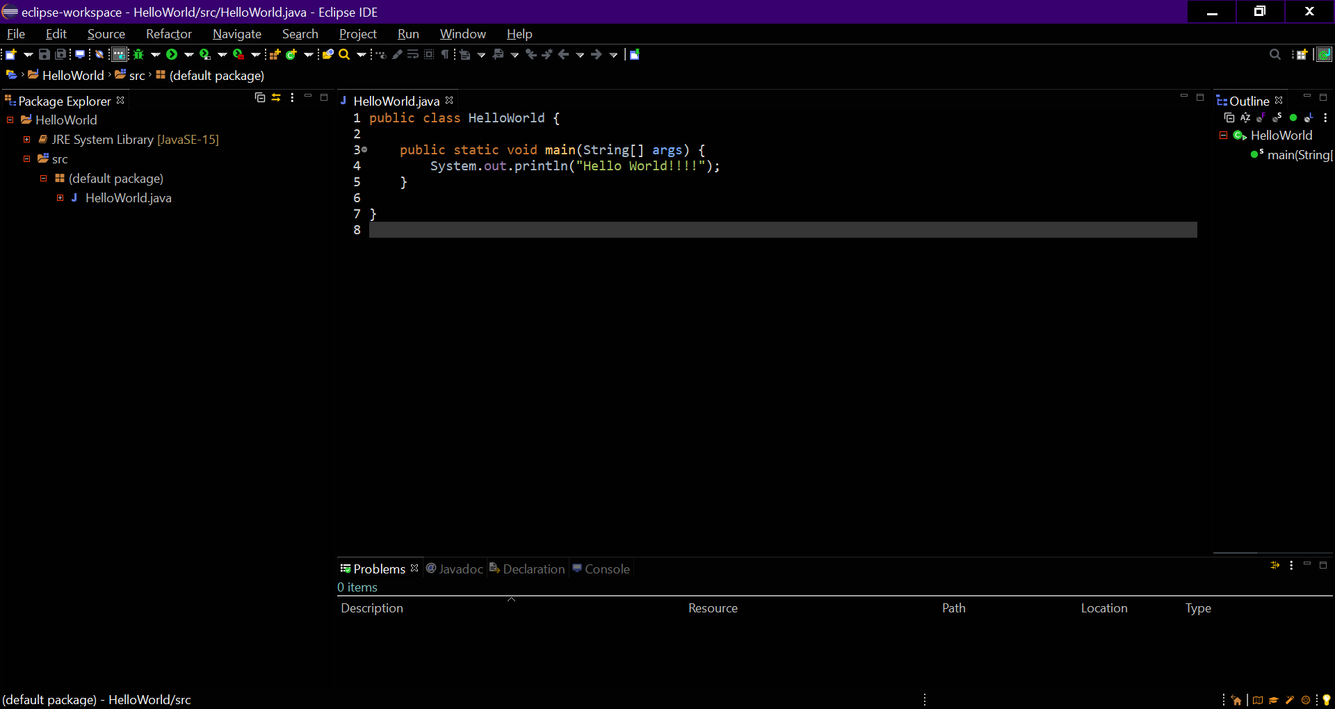

This would be a minimally better result:
