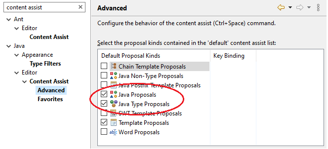

I had a similar problem. Installed Eclipse 4.22 and tried to use it with an old workspace from version 4.8. Got an empty autocomplete window, without any java types or methods listed. Problem solution was to check the entry "Java Proposals" in Content Assist Advanced configuration dialog:
index.php/fa/41627/0/
After checking both like showed in picture many entries in autocomplete were duplicated.
After the fix I took a look to version 4.8 configuration. A "Java Proposals (Code Recommenders)" was enabled in old workspace which is absent in new version 4.22. Therefore Java autocomplete was disabled after upgrade.
