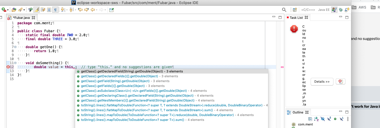

Re: Bug: Auto-complete doesn't work for Java in eclipse 2021-03 [message #1840877 is a reply to message #1840876] Tue, 27 April 2021 17:49 Go to previous messageGo to next message
index.php/fa/40411/0/I found the "Error log view"
I attached a log and a screenshot.
The UI doesn't make it easy to search for conflicting bindings...
Open Type was conflicting with Go To Symbol in Workspace
Deleting the "Open Type" resolved the conflict, but I still have the other errors in the log,
and Auto-Complete is still broken.
If I close eclipse and restart it,
on the first .
it says "No default proposals"
if I hit ^space, "No template proposals"
if I hit ^space, "No template SWT proposals"
if I hit ^space, it DOES find a bunch of "chain template proposals", through getClass() and toString()...
I can also repeat this by just typing ^space after a period...
Attached is a screen capture of the non-empty chain template proposals...
[Updated on: Tue, 27 April 2021 18:47] by Moderator

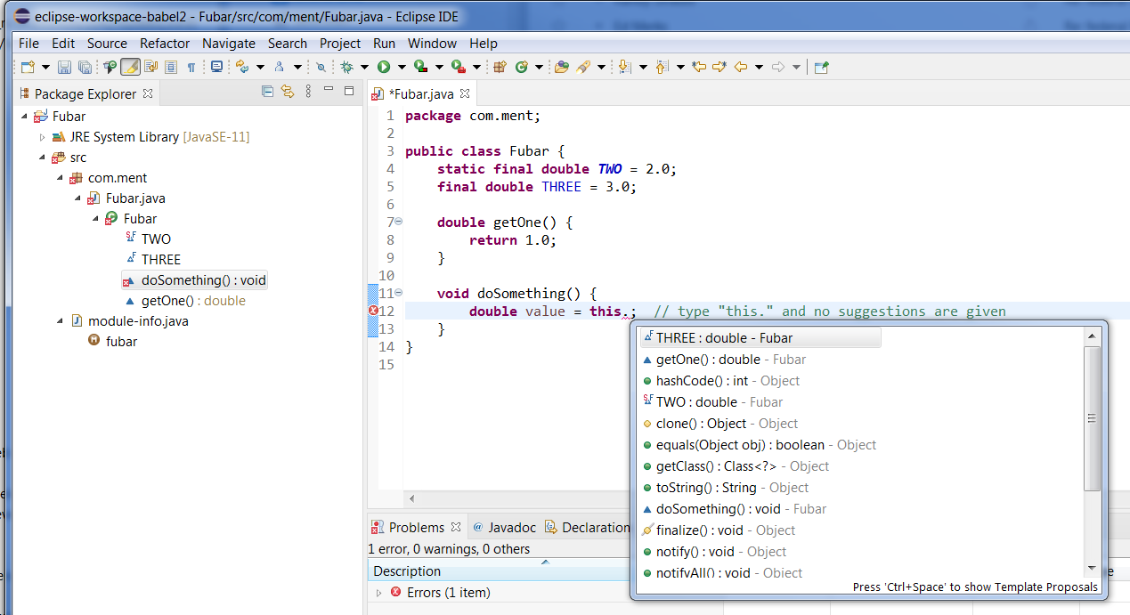

Re: Bug: Auto-complete doesn't work for Java in eclipse 2021-03 [message #1840885 is a reply to message #1840879] Wed, 28 April 2021 03:32 Go to previous messageGo to next message
It works for me:
index.php/fa/40414/0/
It looks like you used the same workspace with different Eclipse installations that have perspective not in the Java IDE you are currently using. This leads to some of the things in the error log.
The key binding conflict is something I've complained about but no one fixes. I'm not sure you can make it go away manually, but it doesn't generally cause problems. The Mylyn thing is also annoying and an old problem.
I don't see anything in the log that explains your Java problem...

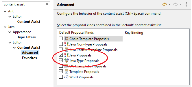

Re: Bug: Auto-complete doesn't work for Java in eclipse 2021-03 [message #1849828 is a reply to message #1840857] Thu, 03 February 2022 11:41 Go to previous messageGo to next message
I had a similar problem. Installed Eclipse 4.22 and tried to use it with an old workspace from version 4.8. Got an empty autocomplete window, without any java types or methods listed. Problem solution was to check the entry "Java Proposals" in Content Assist Advanced configuration dialog:
index.php/fa/41627/0/
After checking both like showed in picture many entries in autocomplete were duplicated.
After the fix I took a look to version 4.8 configuration. A "Java Proposals (Code Recommenders)" was enabled in old workspace which is absent in new version 4.22. Therefore Java autocomplete was disabled after upgrade.
[Updated on: Fri, 04 February 2022 09:15] by Moderator
