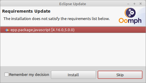

Shortly after each time I start Eclipse 3-21 the eclipse updater opens to say "P2 Director (Eclipse IDE for JavaScript and Web Developers (2020-06))" needs to be manually installed. When I to do that there is a whole stream of red error messages about conflicts (I can add those if it will help?)

The error messages couldn't hurt, but then you should already have the P2 Director installed in a normal situation. What is "Eclipse 3-21" and where did it come from?

Please see attachment for first error massage.

Re: P2 Director Problem [message #1840354 is a reply to message #1840337] Tue, 13 April 2021 02:18 Go to previous messageGo to next message
From what I see here, this is a 2020-06 version or is trying to update to a 2020-06 version.
The dialog that comes up has a prompt that you can say "no don't do this" and also "remember not to do this again". One problem in general with updating this IDE at all is that epp.package.javascript is not in the 2021-03 release so you won't be able to update to a new version of that.

Re: P2 Director Problem [message #1840365 is a reply to message #1840363] Tue, 13 April 2021 05:11 Go to previous messageGo to next message
So your IDE probably updated at least some parts to 2021-03. But the folder name '/home/b/eclipse/javascript-2020-06/eclipse' suggests the installation itself is a year old...
The initial message, if I understand it correctly, just comes up because what you have installed doesn't match the product catalog entry that was used to create the installation. It's okay to ignore that and do your updates manually using Help -> Check for Updates...
If I were you, I would try to just create a new 2021-03 installation from scratch and see if that one works better. You'll most likely want "Eclipse IDE for Enterprise Java and Web Developers" given the Java Script package was removed.
