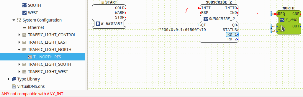

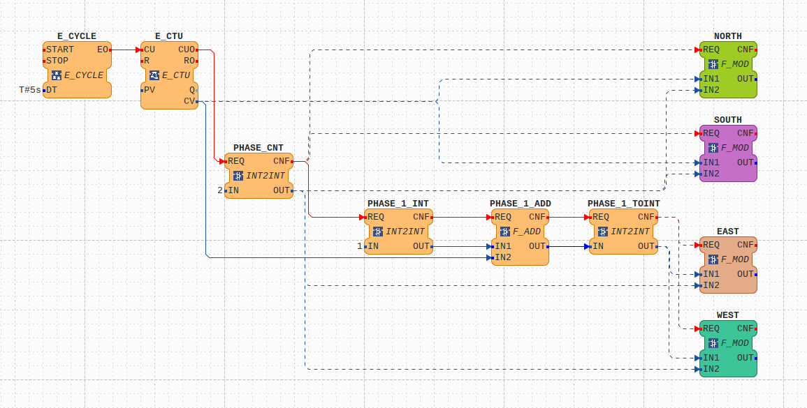

This is my application:
index.php/fa/40325/0/
The application toggles between two phases: "PHASE_0" and "PHASE_1".
"PHASE_0" :
    NORTH.out == SOUTH.out == 1
    EAST.out == WEST.out == 0
"PHASE_1" :
    NORTH.out == SOUTH.out == 0
    EAST.out == WEST.out == 1
I used the following types:
- PHASE_CNT = INT2INT
- PHASE_1_INT = INT2INT
- PHASE_1_ADD = F_ADD
This works fine running on one runtime.
But spreading it on multiple systems using PUBLISH_2 and SUBSCRIBE_2 I have a problem on subscribing:
I can't connect e.g. "SUBSCRIBE_2.RD1 ---> NORTH.IN1":index.php/fa/40326/0/
Re: SUBSCRIPE can not convert "ANY" to "ANY_INT" [message #1840341 is a reply to message #1840328] Mon, 12 April 2021 16:18 Go to previous messageGo to next message
the problem is that SUBSCRIBE in its current from is not allowed to determine the datatype only from the data packet information but also from where it is connected to. In 4diac IDE 1.13.1 and earlier we therefore have not allowed connections between the any types. We relaxed that in the upcoming 4diac IDE 1.14.0. However this will just result in run-time problems. In your case you need to insert an FB that clearly defines the data type (for you INT) on receiver side as well.
Re: SUBSCRIPE can not convert "ANY" to "ANY_INT" [message #1840375 is a reply to message #1840328] Tue, 13 April 2021 09:07 Go to previous message
Placing a "UNIT2UINT" converter before "NORTH.IN1/SOUTH.IN1/..." and a "INT2INT" before "...IN" does solve my problem.
Thank you for the hint.
