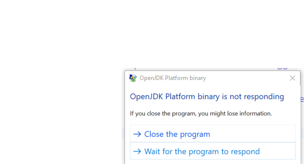

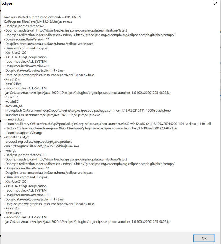

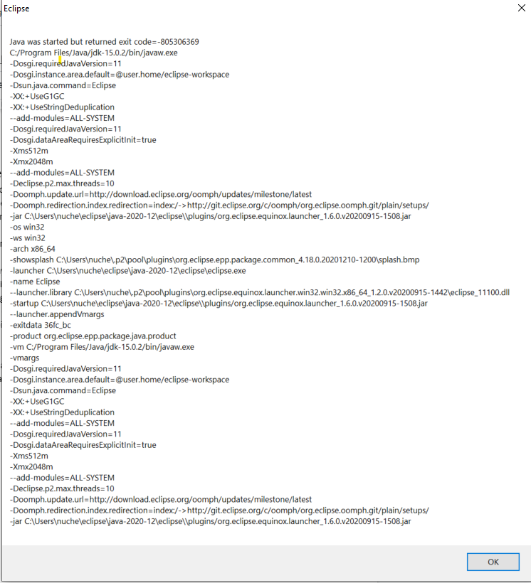

I wondered if anyone could help me please and many thanks for your support, in advance.
My eclipse IDE keeps crashing. Below are screenshots of the messages that appear and contents in the log file which keep showing up and which I think are mostly relevant (They all seem to be just warning so I don't understand why it crashes).
I also tried fixing it by deleting the .metadata folder and by running eclipse with -clean option. I don't want to uninstall eclipse yet because I've done quite a lot of configuration and plugin installments.
This is the content of the log file that keeps from the time of the last crash:

Re: Eclipse keeps crashing [message #1839596 is a reply to message #1839592] Wed, 24 March 2021 08:07 Go to previous messageGo to next message
UPDATE:
I noticed that it happens a lot when I navigate within the Outline tab of a given open source file in eclipse, to jump quickly from one method or variable to another.
As well as the above, I also tried switching to a new workspace in case the old was corrupt.

Re: Eclipse keeps crashing [message #1839604 is a reply to message #1839596] Wed, 24 March 2021 09:29 Go to previous messageGo to next message
Is it really a JVM crash? I have noticed JVM crashes too (with Oracel 11.0.9) but it usually only happens very early after starting, and then doesn't happen anymore so I've not worried to much about it. You might try a newer/different JVM if it's really a JVM crash.
Re: Eclipse keeps crashing [message #1839608 is a reply to message #1839604] Wed, 24 March 2021 11:08 Go to previous messageGo to next message
You mean, you'd wait a bit after starting it before using it (or in my case before using the Outline tab) and then use it no problem? Interesting, now that you've said it, I tried operating the Outline and it didn't crash. You're right, I also noticed, when I start operating the Outline, intensively, immediately after restarting, it crashes much faster than when operating it a while after.
So, I didn't say the JVM crashed. I thought it's eclipse.
Also (not sure if it's related) I initially had JRE 15 but for some reason I kept getting warnings that JRE 11 must be used (I'll post a screenshot next time it happens) so I changed to 11 (by changing the JRE system library in the build path from jdk-15 to using jdk-11) BUT now eclipse keeps automatically reverting it to 15 (JavaSE -11 (JDK-15.0.2) ) every time I restart the IDE.
Momentarily it is on JDK-15 fully (also JRE) and I'll look-out (not) for the next crash. In any event, thanks so much for your tip.
P.S. As well as the above, I also tried switching to a new workspace in case the old was corrupt.
I'm just wondering whether it's worth trying to uninstall eclipse. I use it with maven and spring-boot.
Re: Eclipse keeps crashing [message #1839630 is a reply to message #1839608] Wed, 24 March 2021 16:20 Go to previous messageGo to next message
I now took notice - it still happens to me even if long after having started eclipse. And I am using JDK 15 now. Eclipse is version 2020-12/4.18
Anyway, I can't imagine coding in eclipse without using the Outline tab.

Re: Eclipse keeps crashing [message #1839644 is a reply to message #1839630] Thu, 25 March 2021 01:57 Go to previous messageGo to next message
I couldn't find any Bugzilla with that error and I wouldn't expect at that point that it's possible for the deltas to be null. Perhaps you should consider updating to the latet 2021-03 release....
Re: Eclipse keeps crashing [message #1839653 is a reply to message #1839644] Thu, 25 March 2021 05:01 Go to previous messageGo to next message
Ed, thanks for your comment. I updated it (I thought the whole time I had the latest version) but of no avail. As soon as I just hover over the Outline panel, eclipse freezes for good - until I quit and re-open it. After quitting, eclipse pops up an error window as per the attached.
Nothing much changed in the log:
