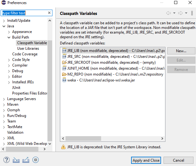

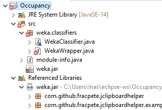

I've done this before in the past with success, and I'm not sure why it's not working now? I've checked the classpath variable in Eclipse and added the path to weka.jar because it wasn't there previously as suggested by someone but the imports still aren't working. I've provided some screenshots to try and help illustrate the error and what seems to me to be no issue with the location of the jar file and classpath. Thanks for any help :)

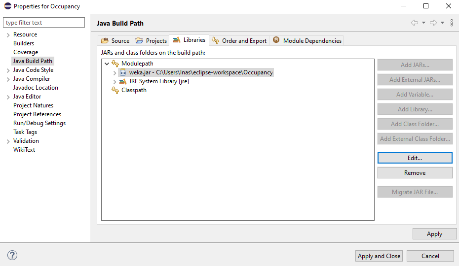

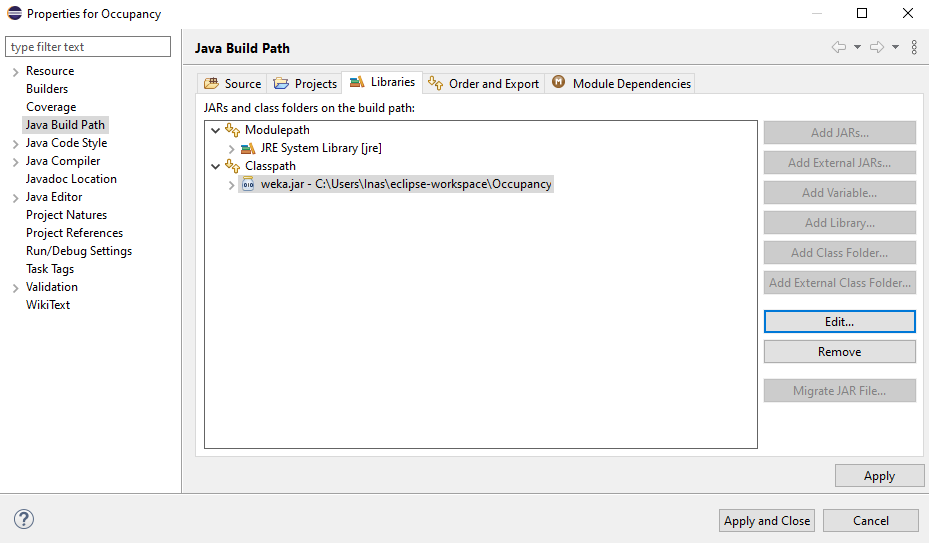

Thanks for the reply :) in the attachment "Screenshot eclipse3" of my original post, I share a photo of the Classpath variable section of the Preferences window where we can see the path to the weka.jar file at the bottom.
I tried removing the jar from the classpath variable and adding it to the modulepath instead (eclipse did not allow for the same jar file to be added to both classpath and modulepath), refreshed the project and tried to run it again but the imports were still not working. I've attached screenshots of the jar file in the classpath and then the modulepath in case I did it incorrectly? I also saw there was the option to add a variable (rather than a jar) to the classpath and modulepath so I tried using those instead of the jar file directly, but this did not work either.

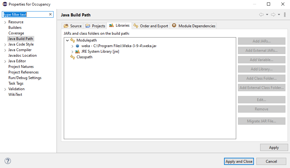

And after rereading your answer and seeing that you were talking about the library not the jar file, I added the library to the module path. For this I had to create a new user library which I called weka, and the imports still do not work. I've included this screenshot as well again in case I've done it incorrectly.

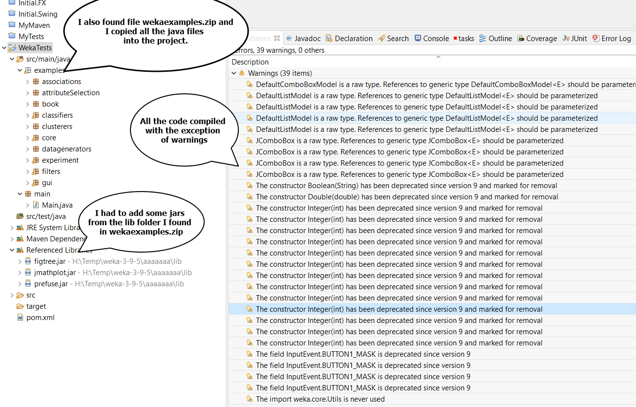

First I want to say that I have no experience with Weka and I just wanted to see if the problem relate to Eclipse.
After downloading "Other platforms" (https://prdownloads.sourceforge.net/weka/weka-3-9-5.zip)
I found file weka-src.jar and inside was a pom.xml that point me to https://search.maven.org/artifact/nz.ac.waikato.cms.weka/weka-dev/3.9.5/jar
So I created a Maven project with Weka dependency:
<dependency>
<groupId>nz.ac.waikato.cms.weka</groupId>
<artifactId>weka-dev</artifactId>
<version>3.9.5</version>
</dependency>
I also found file wekaexamples.zip and I copied all the java files into the project.
I had to add some jars from the lib folder I found in wekaexamples.zip
All the code compiled except some warnings (raw type, deprecated method etc.) .
I use:
- Eclipse 2021-03 (4.19.0).
- openjdk-16_windows-x64_bin.zip
The pom is set to java 16:
<properties>
<project.build.sourceEncoding>UTF-8</project.build.sourceEncoding>
<maven.compiler.target>16</maven.compiler.target>
<maven.compiler.source>16</maven.compiler.source>
</properties>
index.php/fa/40199/0/
I hope my experience will be of help
Regards.

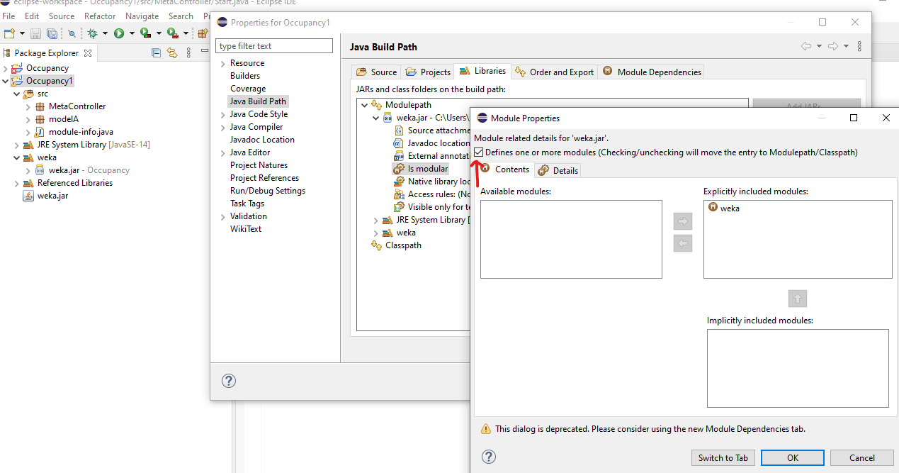

Answering my own question because I found the solution: I had to check the "Defines one or more modules" checkbox in the Module Properties window of the weka.jar modulepath (accessed via the Build Path option on the dropdown from right-clicking the project). I've attached the screenshot showing so.
I do still have an error on an import of a classifier "Only a type can be imported. weka.classifiers.trees.j48 resolves to a package" which I am now trying to solve, but otherwise all my imports are now working.
