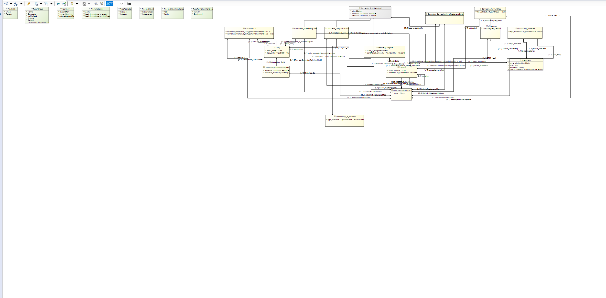

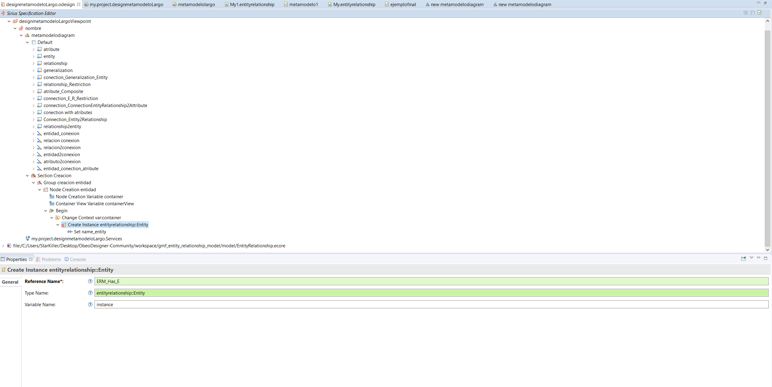

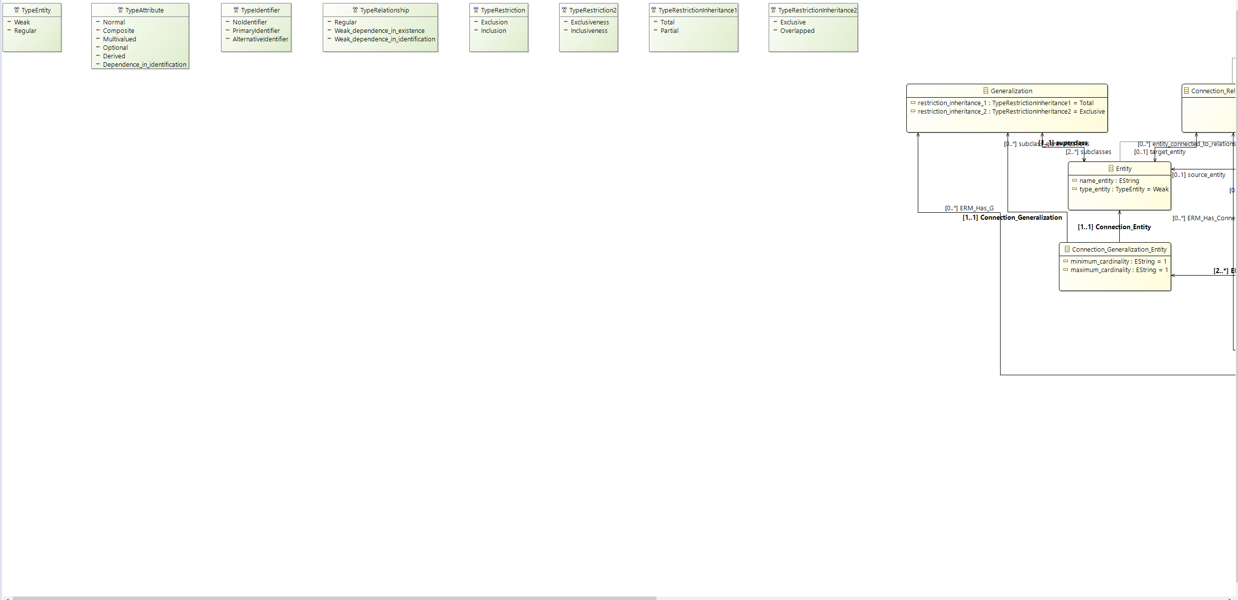

Hi, Im trying to do a viewpoint Specification project, about this metamodel, but the creation tools are not working. I search in a lot of tutorials but I dont find the solution.

It's difficult to tell from the metamodel screenshot, it is too small to read the details.

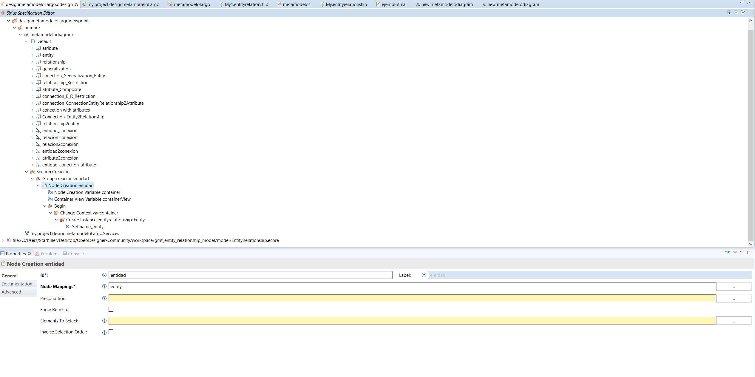

If you are trying to create a new "Entity", you must define the creation tool on a type which can *contain* and Entity, and give the name of the containment feature in the "Reference name".
The "Create Instance" operation will create an instance of the type you tell it, but it must be able to attach it to the current element in the model (on which the tool has been invoked) via the reference you tell it to use.

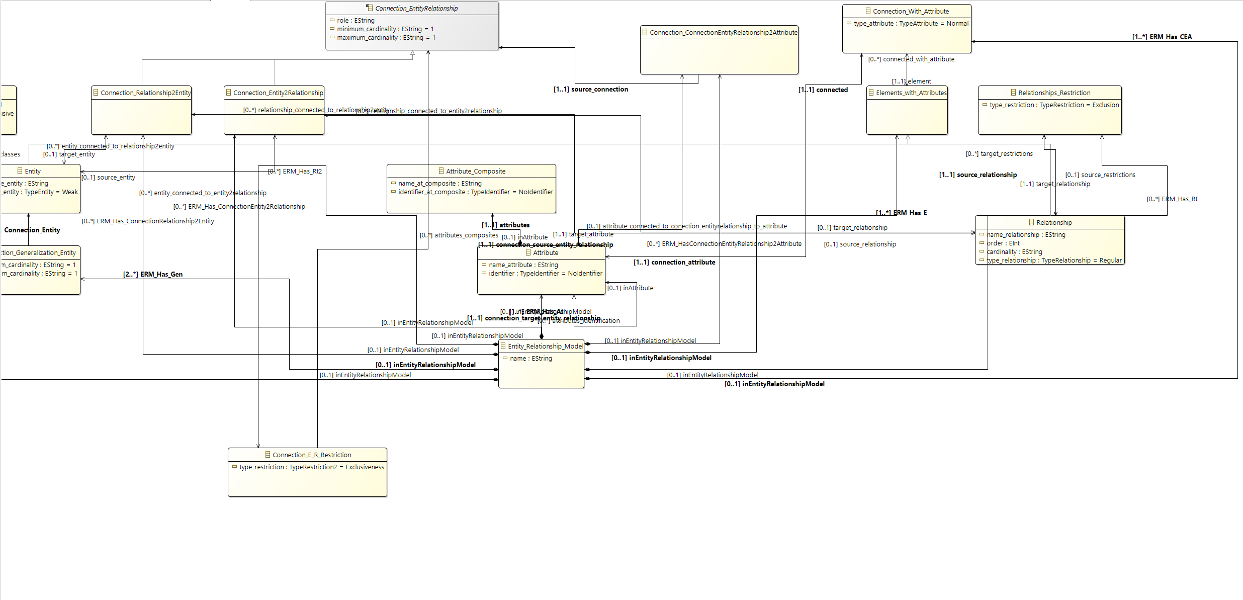

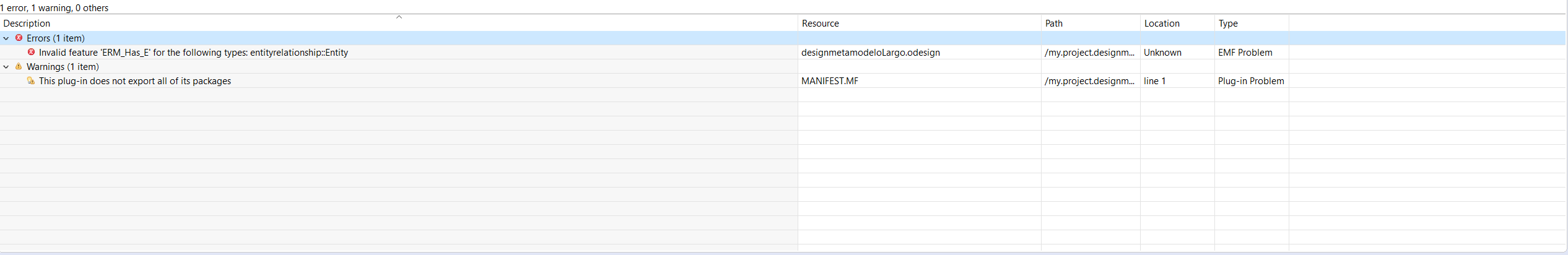

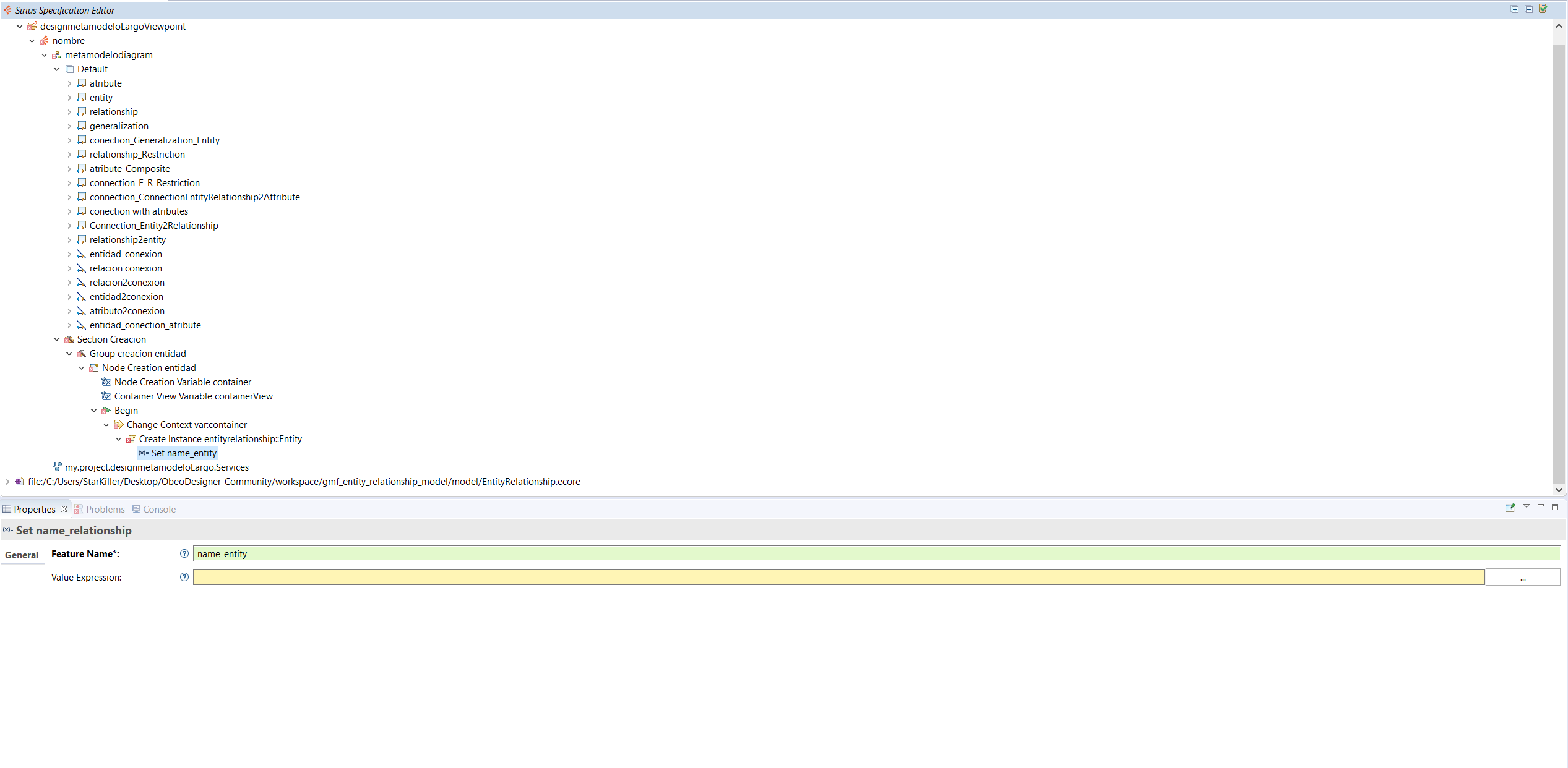

yes, I want to create an entity. I solve some mistakes that I did but still empty the palette. I upload a bigger photo of the metamodel thanks for your help
