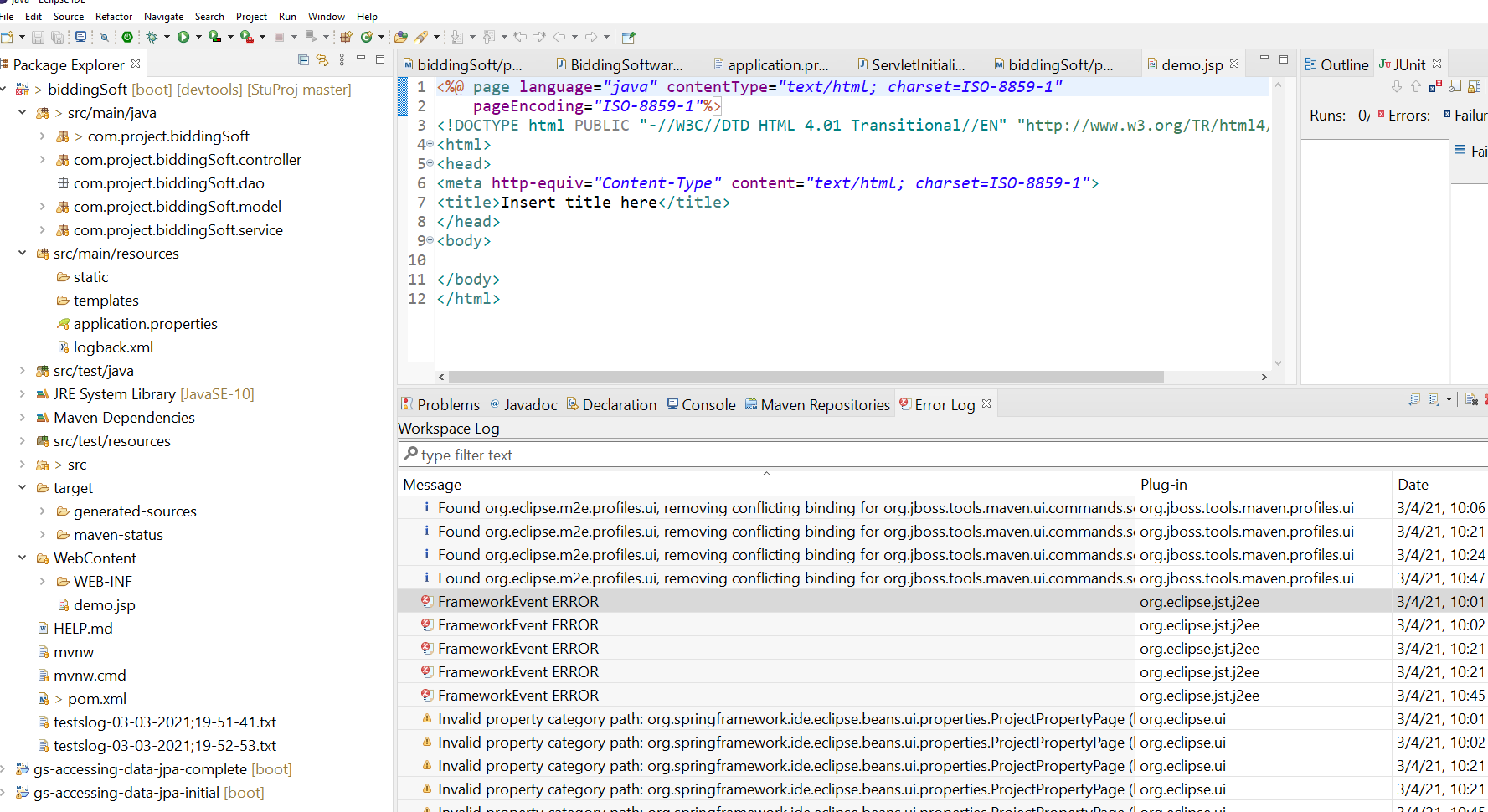

Could anybody be so kind and help me out in deciphering this error? I know that at some point I tried adding (or converting it to) a jsp component to my app although I initailly created it as a spring boot WAR. Many thanks!

You are using an old version of J2EE on an Eclipse 4.18 (2020-12). In Eclipse 4.17, method Platform.getJobManager() was removed (after having been deprecated for a long time, and having been marked as "will be removed" for two years). In 2018, two years before the removal, J2EE updated its code accordingly.
So: to fix, install a recent version of J2EE. Or use the pre-packaged "Eclipse IDE for Enterprise Java Developers", which should come with the right version of these J2EE bundles. (You are currently using the plain "Eclipse IDE for Java Developers".)
Re: FrameworkEvent ERROR in error log after restarting eclipse [message #1838911 is a reply to message #1838797] Tue, 09 March 2021 02:33 Go to previous message
Thank you! That worked.
Much appreciated!!
