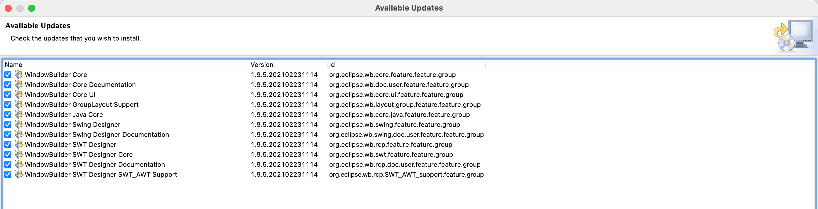

WindowBuilder Update 1.9.5 202102231114 Failing [message #1838478] Thu, 25 February 2021 16:44 Go to next message
An error occurred while collecting items to be installed
session context was:(profile=epp.package.jee, phase=org.eclipse.equinox.internal.p2.engine.phases.Collect, operand=, action=).
No repository found containing: osgi.bundle,org.eclipse.wb.core,1.10.1.202102231114
No repository found containing: osgi.bundle,org.eclipse.wb.core.databinding,1.9.1.202102231114
No repository found containing: osgi.bundle,org.eclipse.wb.core.java,1.9.2.202102231114
No repository found containing: osgi.bundle,org.eclipse.wb.core.lib,1.9.1.202102231114
No repository found containing: osgi.bundle,org.eclipse.wb.core.ui,1.10.0.202102231114
No repository found containing: osgi.bundle,org.eclipse.wb.doc.user,1.9.1.202102231114
No repository found containing: osgi.bundle,org.eclipse.wb.layout.group,1.9.1.202102231114
No repository found containing: osgi.bundle,org.eclipse.wb.os,1.9.1.202102231114
No repository found containing: osgi.bundle,org.eclipse.wb.os.macosx,1.9.1.202102231114
No repository found containing: osgi.bundle,org.eclipse.wb.rcp,1.9.1.202102231114
No repository found containing: osgi.bundle,org.eclipse.wb.rcp.SWT_AWT,1.9.1.202102231114
No repository found containing: osgi.bundle,org.eclipse.wb.rcp.databinding,1.9.1.202102231114
No repository found containing: osgi.bundle,org.eclipse.wb.rcp.databinding.emf,1.9.1.202102231114
No repository found containing: osgi.bundle,org.eclipse.wb.rcp.doc.user,1.9.1.202102231114
No repository found containing: osgi.bundle,org.eclipse.wb.rcp.nebula,1.9.1.202102231114
No repository found containing: osgi.bundle,org.eclipse.wb.rcp.swing2swt,1.9.1.202102231114
No repository found containing: osgi.bundle,org.eclipse.wb.runtime,1.9.1.202102231114
No repository found containing: osgi.bundle,org.eclipse.wb.runtime.lib,1.9.1.202102231114
No repository found containing: osgi.bundle,org.eclipse.wb.swing,1.9.1.202102231114
No repository found containing: osgi.bundle,org.eclipse.wb.swing.FormLayout,1.9.1.202102231114
No repository found containing: osgi.bundle,org.eclipse.wb.swing.FormLayout.lib,1.9.1.202102231114
No repository found containing: osgi.bundle,org.eclipse.wb.swing.MigLayout,1.9.1.202102231114
No repository found containing: osgi.bundle,org.eclipse.wb.swing.MigLayout.lib,1.9.1.202102231114
No repository found containing: osgi.bundle,org.eclipse.wb.swing.databinding,1.9.1.202102231114
No repository found containing: osgi.bundle,org.eclipse.wb.swing.doc.user,1.9.1.202102231114
No repository found containing: osgi.bundle,org.eclipse.wb.swing.java6,1.9.1.202102231114
No repository found containing: osgi.bundle,org.eclipse.wb.swing.jsr296,1.9.1.202102231114
No repository found containing: osgi.bundle,org.eclipse.wb.swt,1.9.1.202102231114
No repository found containing: osgi.bundle,org.eclipse.wb.swt.widgets.baseline,1.9.1.202102231114
No repository found containing: org.eclipse.update.feature,org.eclipse.wb.core.feature,1.9.5.202102231114
No repository found containing: org.eclipse.update.feature,org.eclipse.wb.core.java.feature,1.9.5.202102231114
No repository found containing: org.eclipse.update.feature,org.eclipse.wb.core.ui.feature,1.9.5.202102231114
No repository found containing: org.eclipse.update.feature,org.eclipse.wb.doc.user.feature,1.9.5.202102231114
No repository found containing: org.eclipse.update.feature,org.eclipse.wb.layout.group.feature,1.9.5.202102231114
No repository found containing: org.eclipse.update.feature,org.eclipse.wb.rcp.SWT_AWT_support,1.9.5.202102231114
No repository found containing: org.eclipse.update.feature,org.eclipse.wb.rcp.doc.user.feature,1.9.5.202102231114
No repository found containing: org.eclipse.update.feature,org.eclipse.wb.rcp.feature,1.9.5.202102231114
No repository found containing: org.eclipse.update.feature,org.eclipse.wb.swing.doc.user.feature,1.9.5.202102231114
No repository found containing: org.eclipse.update.feature,org.eclipse.wb.swing.feature,1.9.5.202102231114
No repository found containing: org.eclipse.update.feature,org.eclipse.wb.swt.feature,1.9.5.202102231114
