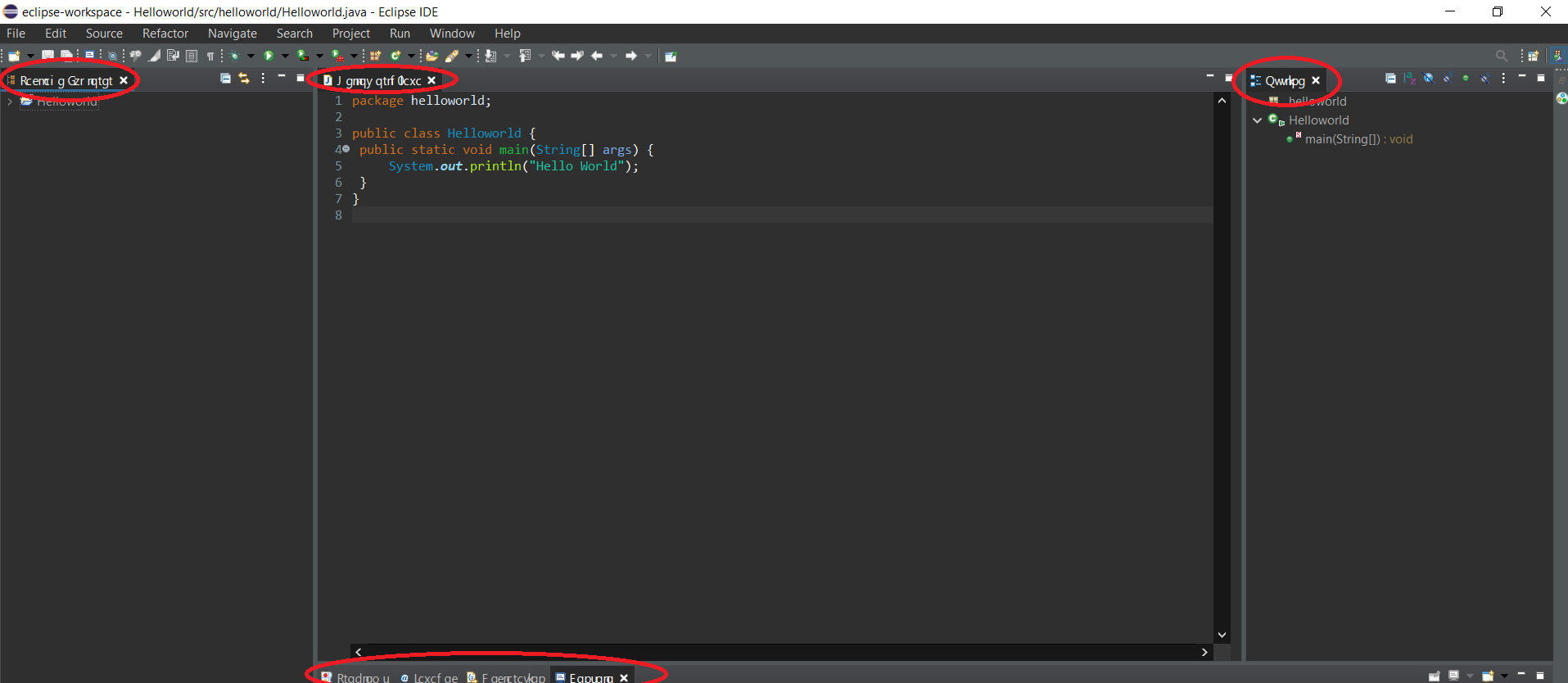

gibberish titles [message #1838378] Tue, 23 February 2021 14:52 Go to next message
index.php/fa/40036/0/
I have tried uninstalling eclipse and then reinstall it.
I used different mirrors for installer download.
tried resetting the default setting.
please help me solve this problem.
Re: gibberish titles [message #1838396 is a reply to message #1838378] Wed, 24 February 2021 00:32 Go to previous messageGo to next message
You might try running with eclipse.exe -vmargs -Dfile.encoding=UTF-8 and if that works, you can add -Dfile.encoding=UTF-8 to the end of the eclipse.ini. It looks like an encoding problem, but it could also be a font issue so you might look at the font preference and see if things look mangled there too.
Re: gibberish titles [message #1840743 is a reply to message #1838396] Fri, 23 April 2021 04:55 Go to previous messageGo to next message
Ok I will try
Re: gibberish titles [message #1840746 is a reply to message #1838378] Fri, 23 April 2021 05:33 Go to previous message
Thank you It worked
There was problem in the font.
