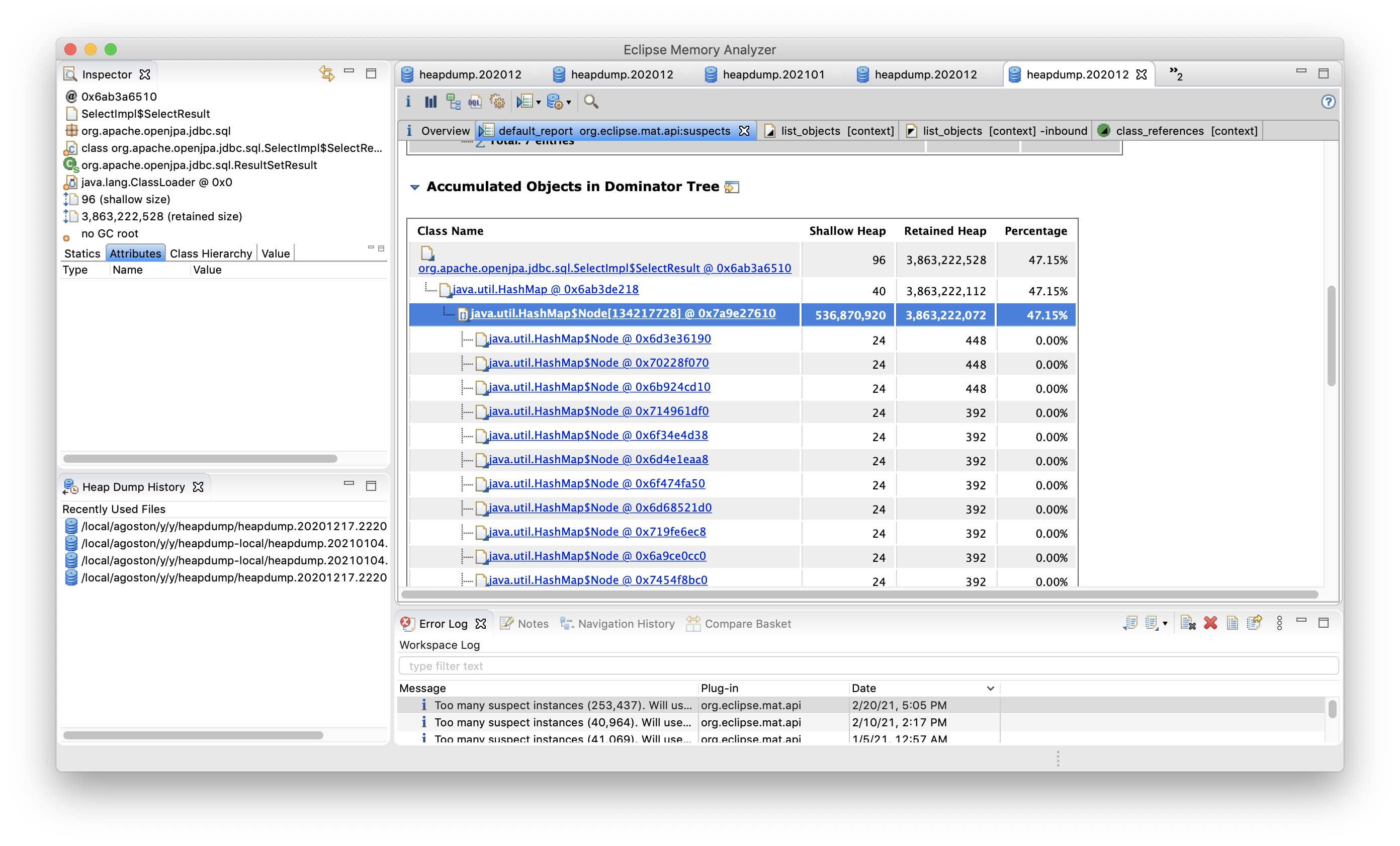

I've got a *huge* memory dump, with an apparent 3.8G memory leak.
(I've had to increase the heap size for MAT to about 12G for it to be able to read the hprof file at all.)
Now when I click on the org.apache.openjpa.jdbc.sql.SelectImpl$SelectResult object that seems to be the culprit, shouldn't I see its fields in the inspector window on the Attributes tab? (Actually, if I click on any object, the Attributes tab stays empty.)
Any idea why it doesn't?
index.php/fa/40026/0/
(Note that in the screenshot I had just clicked on the SelectResult instance, it just doesn't change the selection with the blue brackground -- another symptom...?)
Thanks!

I don't know why it would do that.
Also it isn't switching to a new object when you have moved down to the HashMap$Node[] array.
Pressing the double array locks the inspector view so it doesn't change to a new object, however it is not pressed here.
I don't see any errors in your error log.
You could try creating a new inspector view to see if that helps: Window > Inspector
Does it ever work - on smaller dumps or after restarting MAT?
