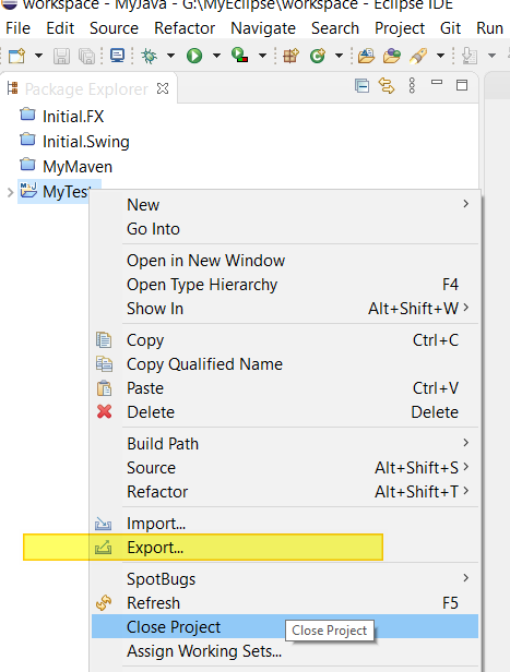

Re: Eclipse Project for a Java Package? [message #1837165 is a reply to message #1837155] Sat, 23 January 2021 02:21 Go to previous messageGo to next message

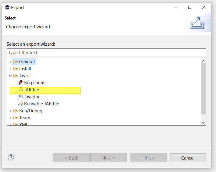

To create a jar you can use export:
index.php/fa/39812/0/
index.php/fa/39813/0/

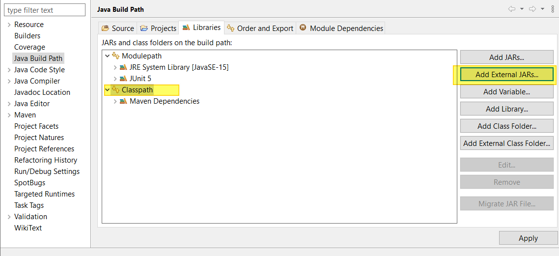

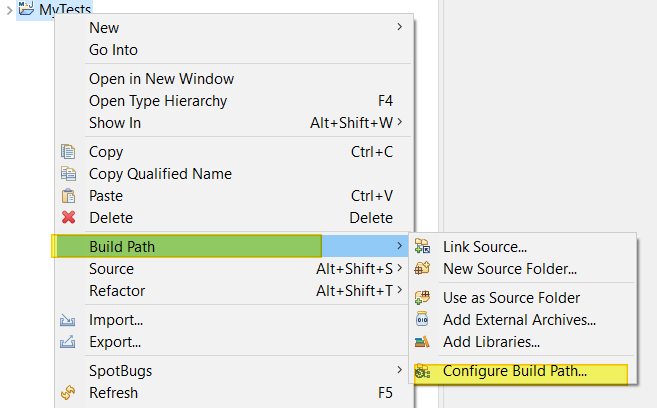

To reference a jar you can use the build path:
index.php/fa/39811/0/
index.php/fa/39810/0/
For documentation use search help for "export jar" , "Java Build Path"

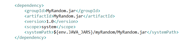

If you use maven:
To reference a local jar :
index.php/fa/39814/0/

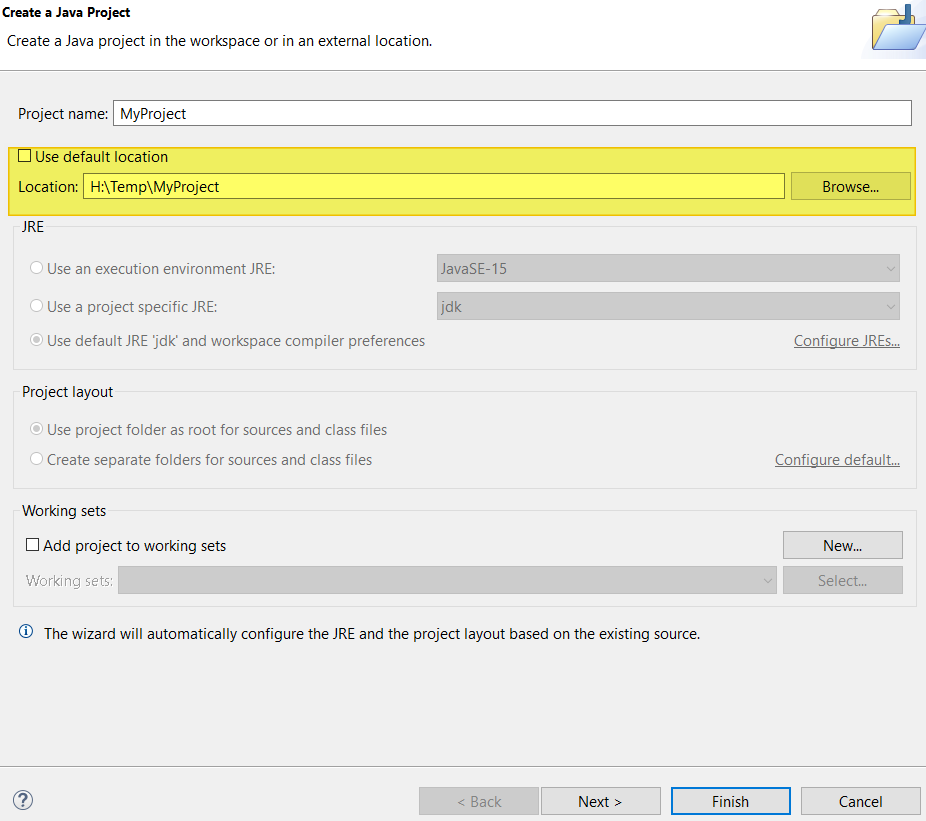

Re: Eclipse Project for a Java Package? [message #1837177 is a reply to message #1837176] Sat, 23 January 2021 11:51 Go to previous messageGo to next message
Maybe I am missing something but it looks like you need a "new Java" project.
If you want you can set it up outside the default location (Eclipse workspace).
index.php/fa/39816/0/

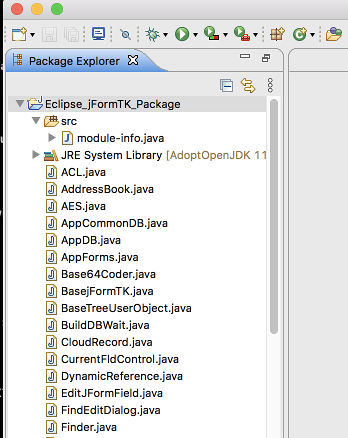

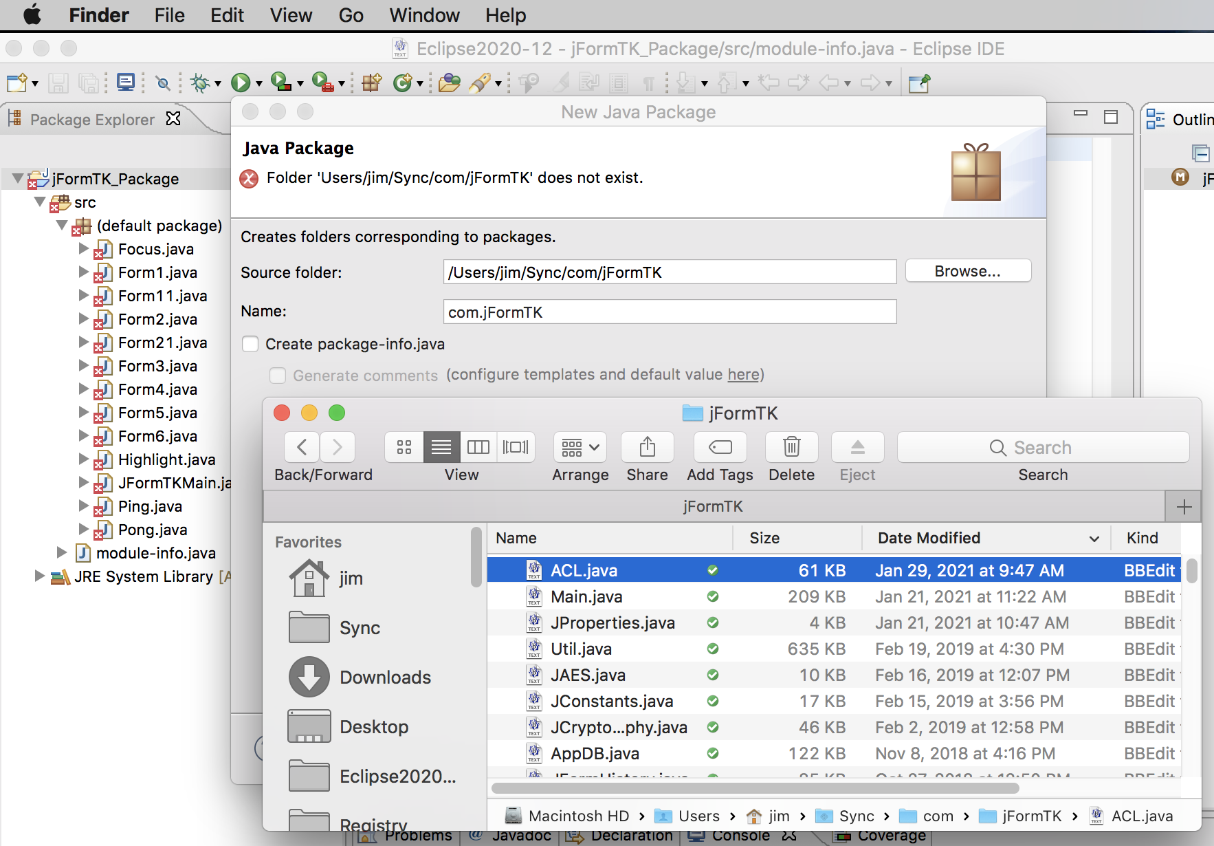

Yes all I am looking for now is how to setup an Eclipse Project for my Java Package [jFormTK].
I followed you setup instructions [thanks] and got the attached result.
Note: I do not know how to include the screen show in this text? Therefore I made a .png and attached it [Eclipse_jFormTK_Package.png].
I have WhatsApp on my Mac but have never used it. I tried to use it, updated the .app file but it then asked me to process what looks like a Bar Code via my WhatsApp' application on my Android cell. When I tried to load WhatsApp on my cell I did not have room for it...
Anyway the .png image of my 'Package Explorer' did not look right to me. I think I need my external source files to be in an Eclipse Package?
Jim Crowell

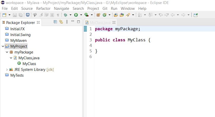

Re: Eclipse Project for a Java Package? [message #1837184 is a reply to message #1837183] Sat, 23 January 2021 13:57 Go to previous messageGo to next message
Jim,
"I think I need my external source files to be in an Eclipse Package?"
True,
It should look like something like that:
index.php/fa/39819/0/
- create a package.
- move your code into the created package.
Eitan.
Re: Eclipse Project for a Java Package? [message #1837187 is a reply to message #1837184] Sat, 23 January 2021 15:32 Go to previous messageGo to next message
Attached is a image of my Package Explorer after doing what you suggested last.
It looks good me but I was surprised to see my package under the default package.
Is that right?
The error red flags I think are because I need to setup my external libraries in the Class Path.
Jim...

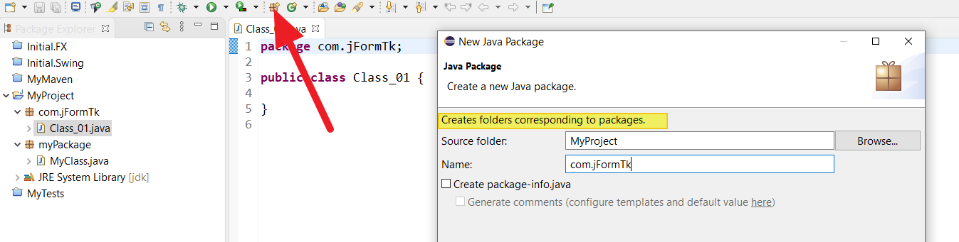

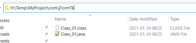

Re: Eclipse Project for a Java Package? [message #1837192 is a reply to message #1837187] Sun, 24 January 2021 01:49 Go to previous messageGo to next message
Jim,
As far as I can tell from Attachment: PackageExplorer2.png your you need to create package com.jFormTk .
index.php/fa/39821/0/
This will create folders: com\jFormTk
index.php/fa/39823/0/
index.php/fa/39822/0/
You need to move ONLY *.java files from its current location to jFormTk
Regards.

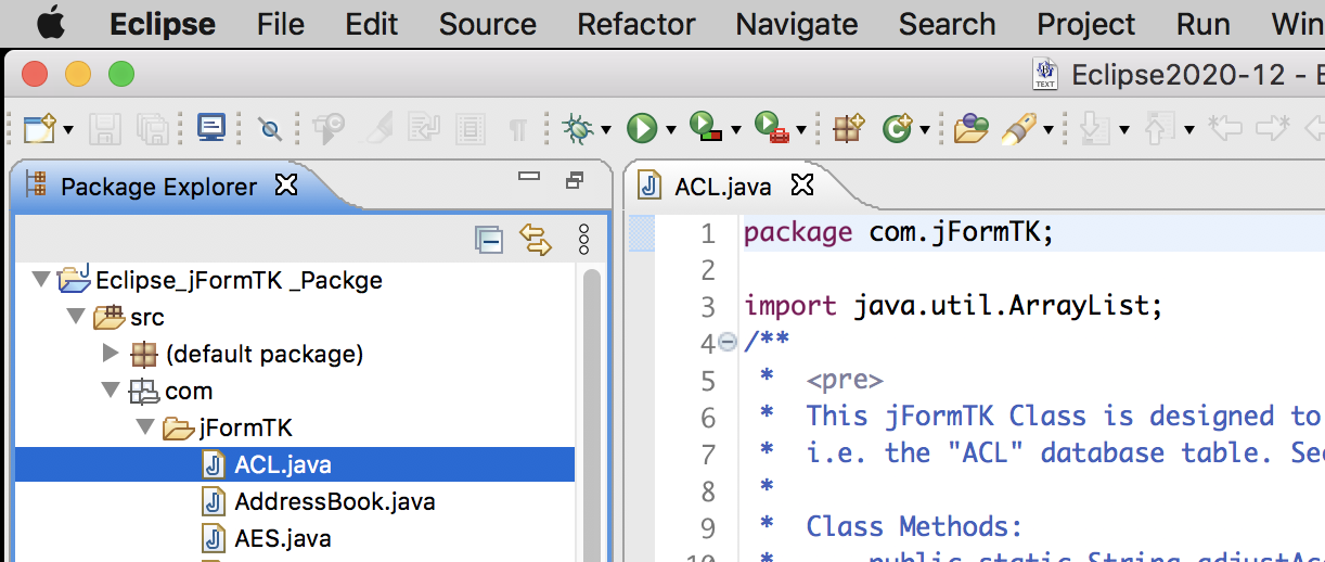

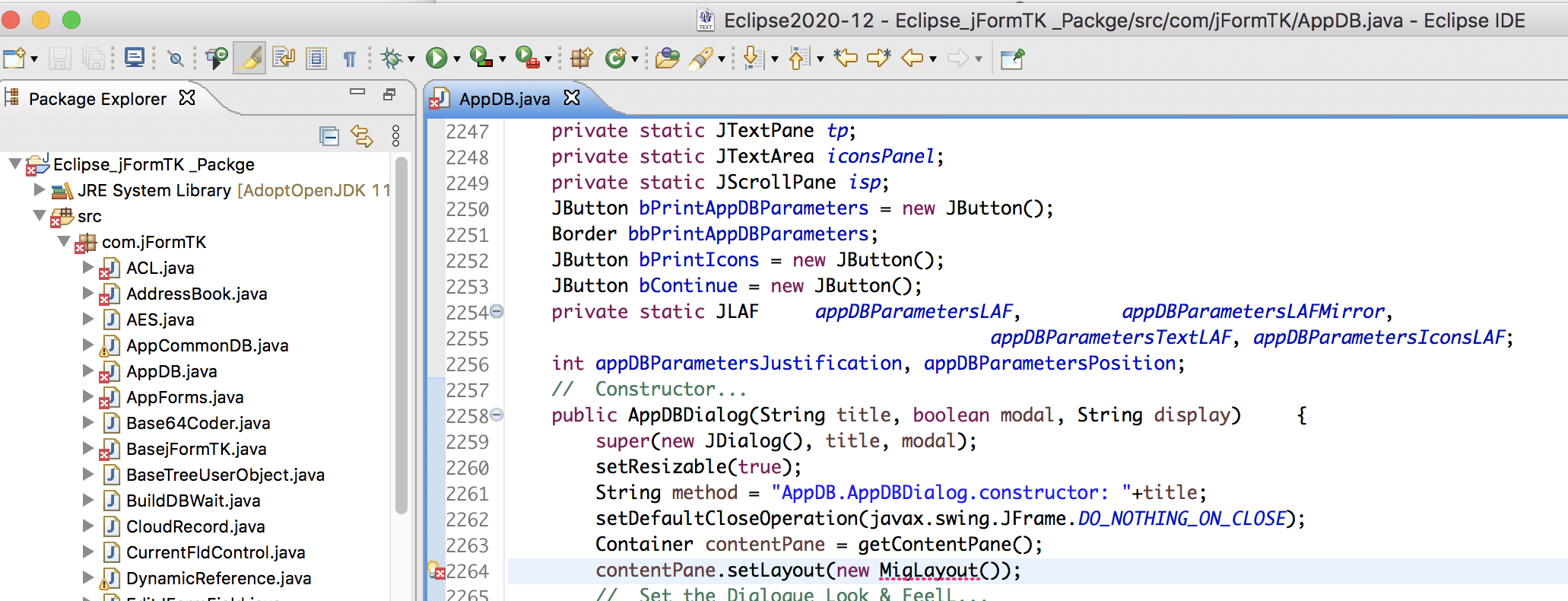

Re: Eclipse Project for a Java Package? [message #1837327 is a reply to message #1837192] Wed, 27 January 2021 10:34 Go to previous messageGo to next message
I thought I had my Eclipse Project setup properly until I started to re-code some com.jFormTK classes. I was trying to have Eclipse use an external folder but with my current setup I have copied the external folder files into my Eclipse Project and it's .java files are updated.
First is the package setup in Eclipse proper as shown in attachment 'PackageExplorer3.png? It seems OK since the 'package com.jFormTK' statement' is not showing an error.
Second, ideally I would like to have the 'com.jFormTK' package source be using the 'sync.com.jFormTK'. folder on my HDD. 'sync' is from the 'sync.com' server side storage service. Yesterday, I tried several options from the Eclipse.Import feature but I did not find anyway to do what I want.
Why do I want to use an external source folder?
In my past Eclipse setup I would manually copy the Eclipse source folder to my 'sync.com' account at the end of the work day iff I had made any changes to my 'jFormTK' package. I am trying to eliminate this step by having Eclipse store my changes directly to my off-site storage service.

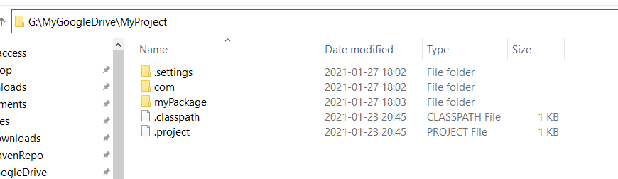

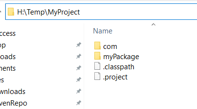

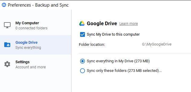

Re: Eclipse Project for a Java Package? [message #1837330 is a reply to message #1837327] Wed, 27 January 2021 11:12 Go to previous messageGo to next message
PackageExplorer3.png looks fine to me.
As I show in https://www.eclipse.org/forums/index.php?t=getfile&id=39816&
You can create you project any where you want.
For example I created a project under MyGoogleDrive so I can sync it up to the cloud.
index.php/fa/39840/0/
index.php/fa/39841/0/
[Updated on: Wed, 27 January 2021 11:15] by Moderator
