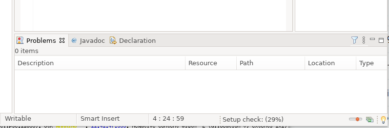

It is hanging in Setup Check, screenshot attached.
Re: Eclipse 2020-12 hangs forever [message #1837085 is a reply to message #1837079] Thu, 21 January 2021 15:14 Go to previous messageGo to next message
Interesting, so whatever "Setup check" is doing, it's blocking the wizard from continuing. Oomph has that string, but I'm not sure what it's doing, nor why it would block creating the project.
Re: Eclipse 2020-12 hangs forever [message #1837093 is a reply to message #1837085] Thu, 21 January 2021 23:32 Go to previous messageGo to next message
There are no problems in the log, and the Setup Check is a job that runs in the background, so not an indication of "the IDE hangs forever" because that wold suggest the IDE is unresponsive and cannot even paint. You can set Window -> Preferences -> Oomph -> Setup Tasks -> "Skip automatic execution at startup time" to true so that this background is not triggered. But in any case, the IDE is not hung and should be responsive to whatever activities you want to do. That job should complete or fail, though it involves network access so could take long time timeout. If you double click it, the Progress view should open and you can try to cancel the job as well.

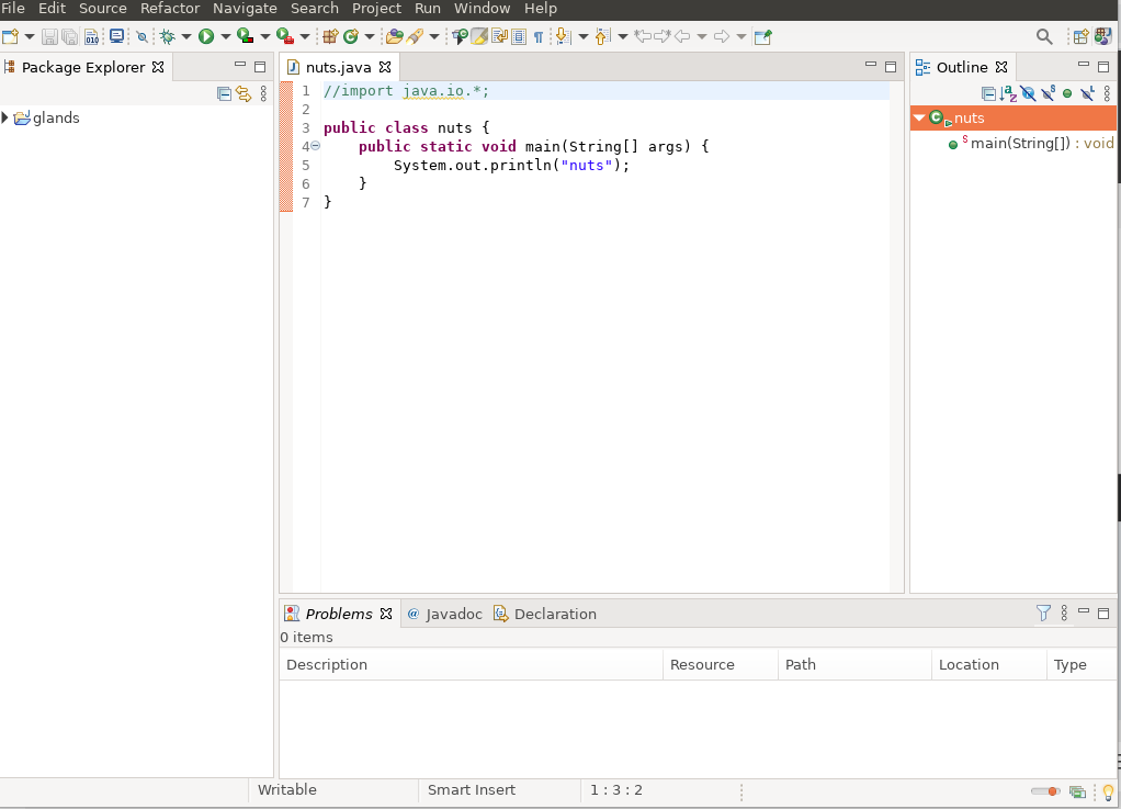

I can type text into an editor window and save to file. Once I select Run or Help the spinning progress wheel is displayed. Menu items are not selectable and the only way to stop the spinning wheel indicator is ^C. A screenshot is attached.
When I say "hangs forever" I mean the eclipse UI is completely unresponsive to any mouse or keyboard actions. I have let this run overnight, and the unresponsive state persists.

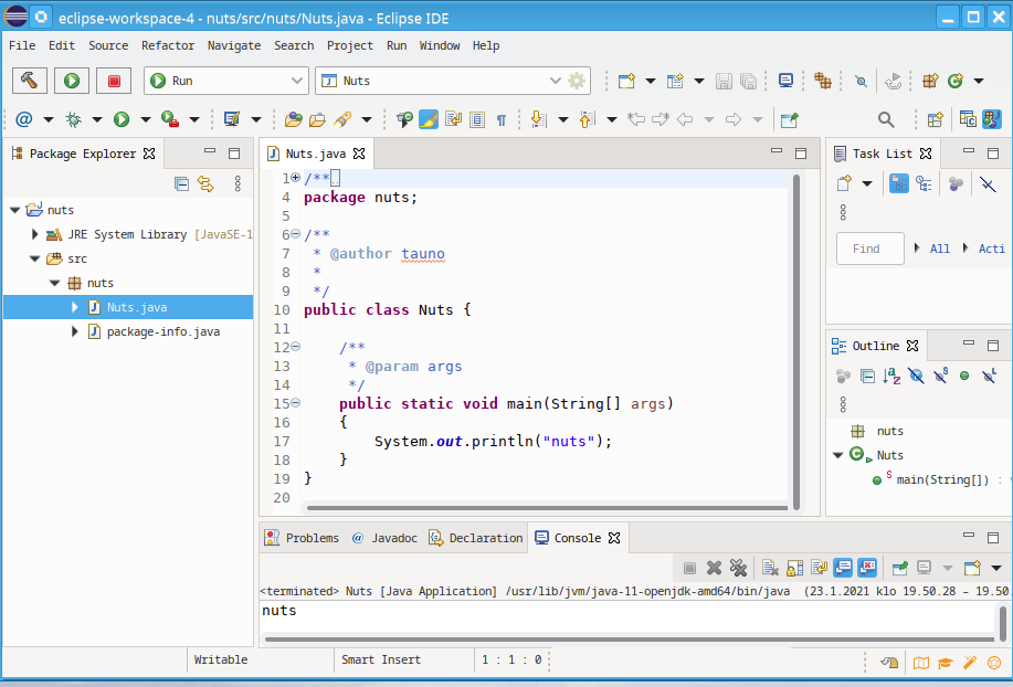

My guess is that there is something fishy with the JDK installation.
On my Kubuntu 18.04.5 LTS, the program runs fine, both on OpenJDK-11 and OpenJDK-8, which are both installable from Ubuntu repositories, see attached
screenshot.
