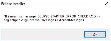

I downloaded the latest eclipse setup and tried to install it in my PC, but I get this error "NLS missing message: ECLIPSE_STARTUP_ERROR_CHECK_LOG in: org.eclipse.osgi.internal.messages.ExternalMessages". But when i used the same setup file in another PC, it got installed. Here both the PCs are installed with the same version of the Windows 10 and the Hardware is identical.
Now what am i missing here that I am unable to install it.
Before I posted this question I saw a lot of similar question related to the same error with Eclipse. But for those all problems the error occurred after installing the Eclipse while opening the workspace. Hence the solution given to them don't work much for me..
For me I get this error the moment I run the setup.
Please help me. I need to deliver a project.
I have attached the Screenshot

That message is defined as:
ECLIPSE_STARTUP_ERROR_CHECK_LOG=An error has occurred. See the log file\n{0}.
So something has gone horribly wrong at startup of the installer, so wrong that even messages could not be loaded.
You could try this newer/latest version of the installer:
http://www.eclipse.org/downloads/download.php?file=/oomph/products/eclipse-inst-jre-win64.exe
Or download and unzip a package:
The 2020-12 release will be available later today.

Thanks for the throwing the light on it. Well I kind a did the work around. It seems that I had some permission issues with the 'Drive C:' so I went on to copy the C/C++ Package in the other drive and I tried running it. And GUESS WHAT!!! It successfully is working finely.
Thanks for guiding me through this. Will Never forget your help.
