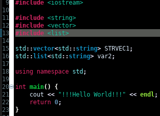

  • Are the the includes flagged like the #include<NOSUCH> below?
    index.php/fa/39538/0/

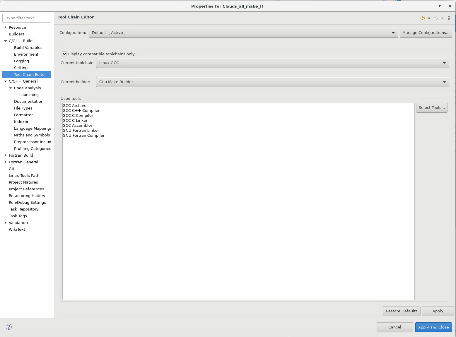

But where to set the compiler? Is it project/properties/c-c++build/Tool Chain Editor? It certainly looks like it is
the correct place. However I still have some 3rd party open source software that still have some unresolved.

Even with a Makefile Project you should select a tool chain.
${COMMAND} is set to the compiler in the tool chain.
${INPUTS} is set to a C or C++ file depending on the language.
Note that it expects GCC or a derivative.
${FLAGS} is always empty for me.
Alternately, you could just replace ${COMMAND} with the appropriate compiler.
Using your native GCC should be acceptable.

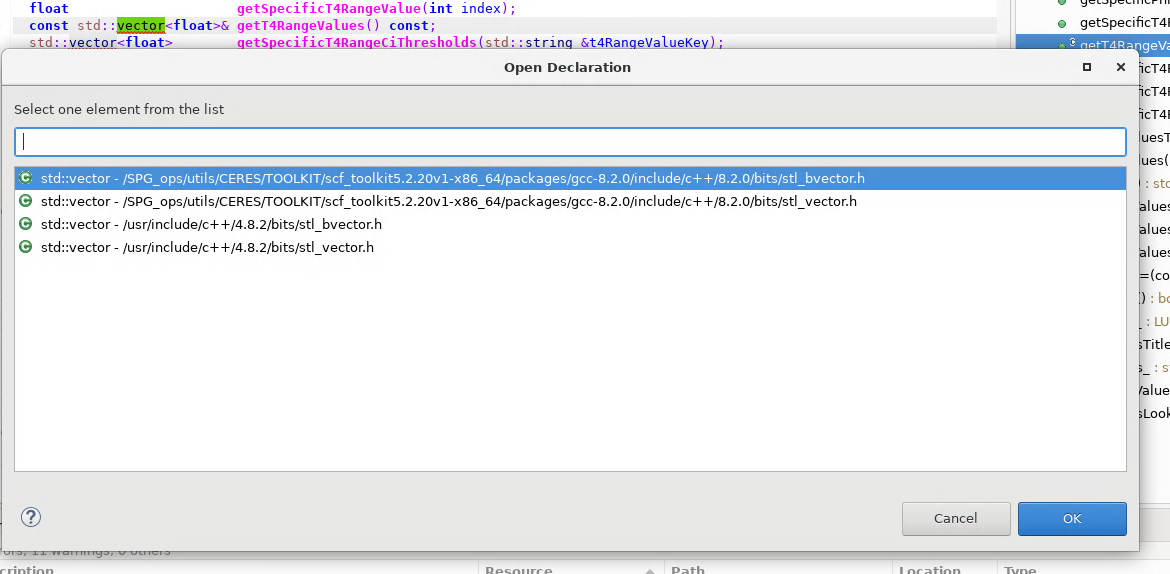

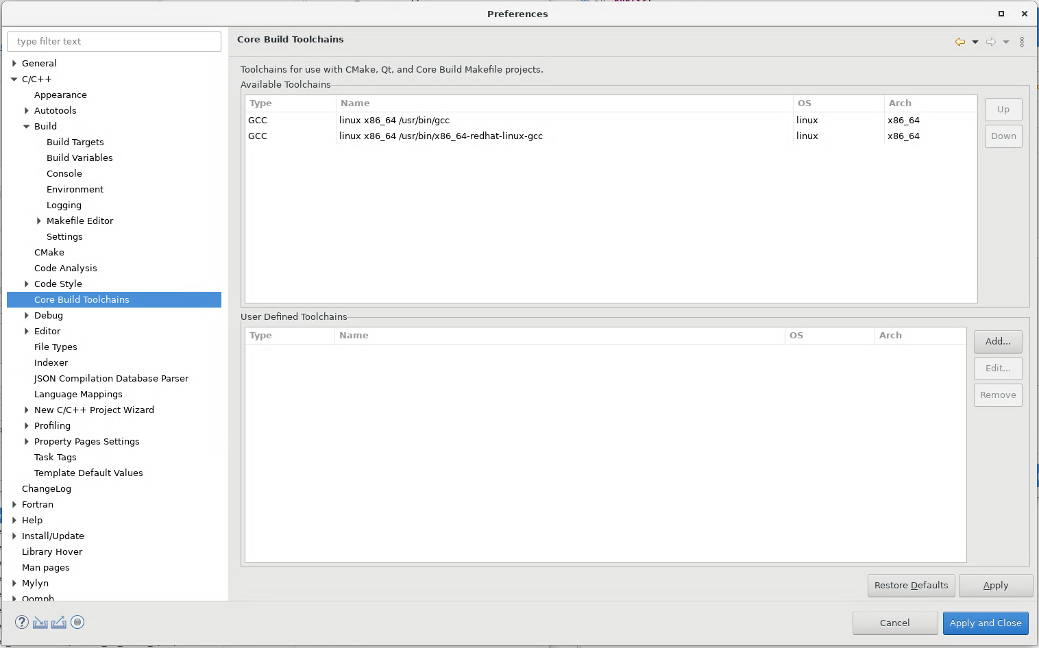

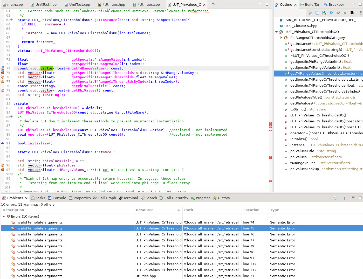

index.php/fa/41254/0/This error is still occurring. It's also occurring for vectors of float data types.
I first noticed it yesterday (11/2/2021). And it is now happening on opening files that haven't changed since last commit to git (when none of these errors were occurring).
So it seems like something has happened in Eclipse that is causing this since my last commit on October 19 2021.
Tried rolling back eclipse to a previous installation from September in the Installation History, but that made no difference.
I've attached some screen images showing these errors which simply weren't there a week or so ago.
I looked at the document referenced in the previous replies and have to admit that I felt as though I was in way over my head, but did manage to enter a path for a compiler after doing a "which gcc" in a terminal window - can't remember how to get to that setting now (yikes!) but that didn't make any difference anyway.
I've included some screenshots of some other settings in the hopes that maybe someone will see something that could help. Starting to get worried about time lost on this - anybody have any ideas about how to fix this?

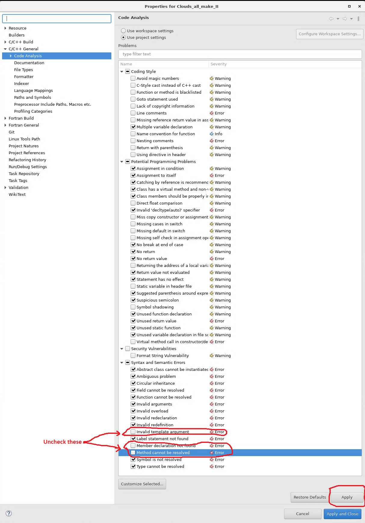

This is my temporary work around until I can come up with a better more proper solution.
Under Project Settings, C/C++ General, CodeAnalysis, uncheck the following options:
Invalid template argument,
Method cannot be resolved.
Click Apply.
Love to hear anyone's ideas for a better, less ad hoc fix :)
