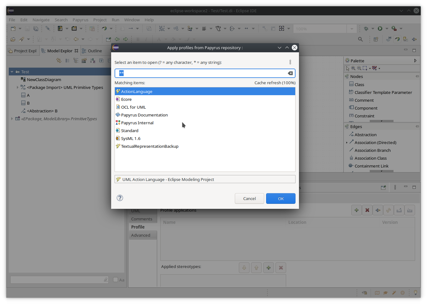

Thank you for the pointers Christian!
Thank you also Ed - at this stage I'm trying this Java option as it might be a little more better in performance.
I'm a little stuck.
First I create a very simple cut down Papyrus UML profile; simply create Papyrus UML profile project called test_profile2.
- Add "Requirement" Stereotype that extends UML Class Metaclass type.
I then created a second project; an EMF Project called test_profile2_emf.
During EMF Project wizard,
- Select "UML Model" in Select a Model Importer dialog.
- Select from workspace the test_profile2 Papyrus profile.uml file.
* Some errors about UML metamodel types are reported but project creates fine.
- Select "Test_profile2" by right-click and select Generate Model Code; Java code appears in src path of project.
* Some minor issue complaining about JDK version in MANIFEST.MF file, fixed by pointing to JavaSE-11.
After this point I have no idea how to "register" this Java project as a Papyrus registered profile similar to what SysML is - i.e. do I need to somehow install this as a plugin to Eclipse? Sorry C++ programmer here, my Java skills are rather new :)
Any pointers will be appreciated greatly.

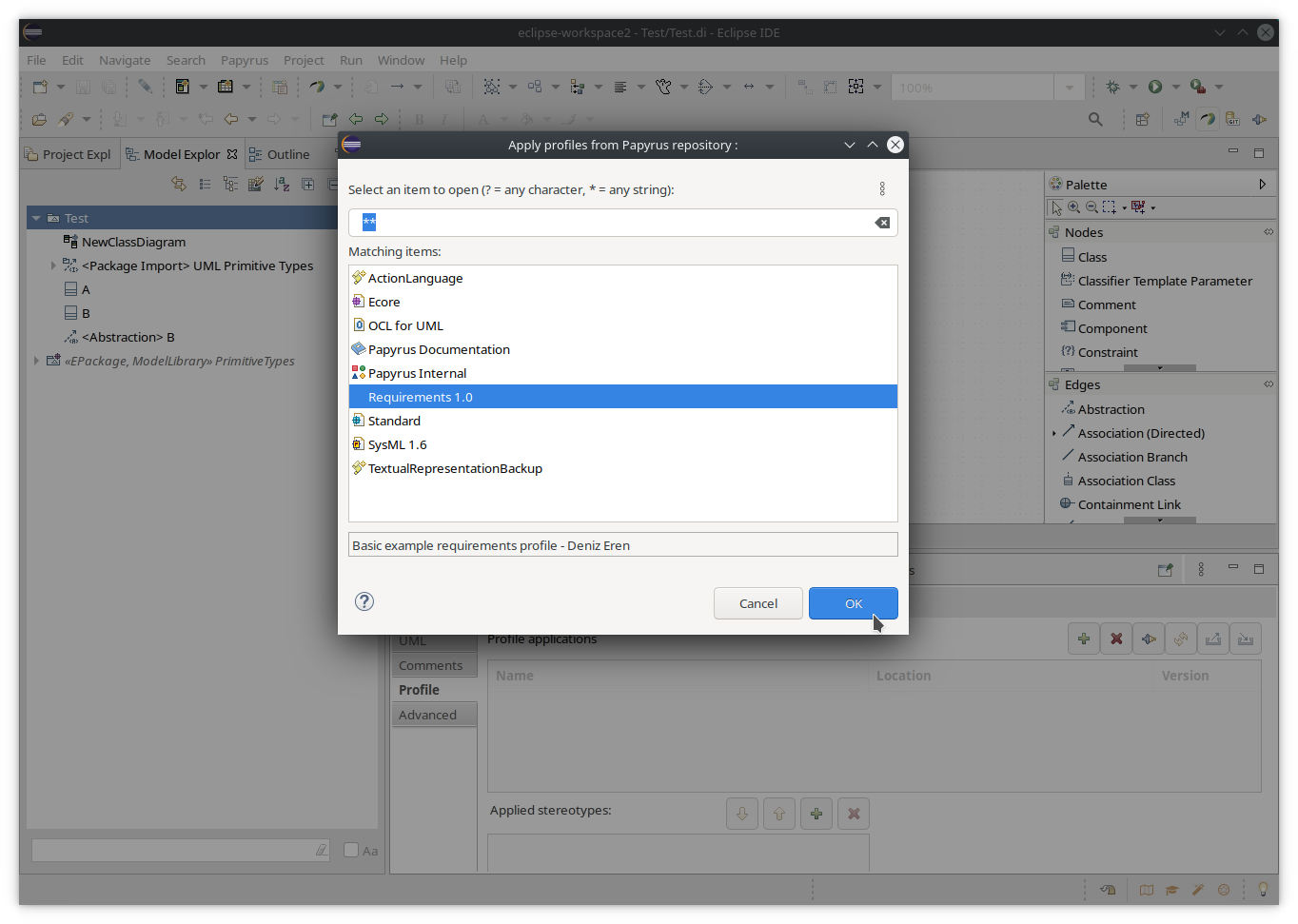

Re: Papyrus profiles with derived stereotype properties defined by same name operations [message #1835878 is a reply to message #1835860] Tue, 15 December 2020 11:10 Go to previous messageGo to next message
In the properties of the top GenModel element in the EMF generator model for your profile, if you select "11.0" in the "Compliance Level" property, then you won't have to tweak the manifest for JDK versions.
For registration of the profile in Papyrus, to make it easy to apply to models, follow the example of the SysML 1.6 plug-in, below. There is a Papyrus extension point on which you need to register the profile in your bundle's plugin.xml file. Note that SysML 1.6 additional registers a URI mapping in EMF to make abstract pathmap scheme URIs. This is optional, not required by Papyrus.

Re: Papyrus profiles with derived stereotype properties defined by same name operations [message #1835974 is a reply to message #1835878] Thu, 17 December 2020 09:26 Go to previous messageGo to next message
Hi Christian,
Thank you for all your help.
I tried different combinations using ecore profile with EOperation stereotype and without, also different combinations of operation names vs derived property names, but the final generated Java code seems to have "TODO" sections.
Is this the expected behaviour? Should I be expecting the OCL automatically get translated to Java as I am?

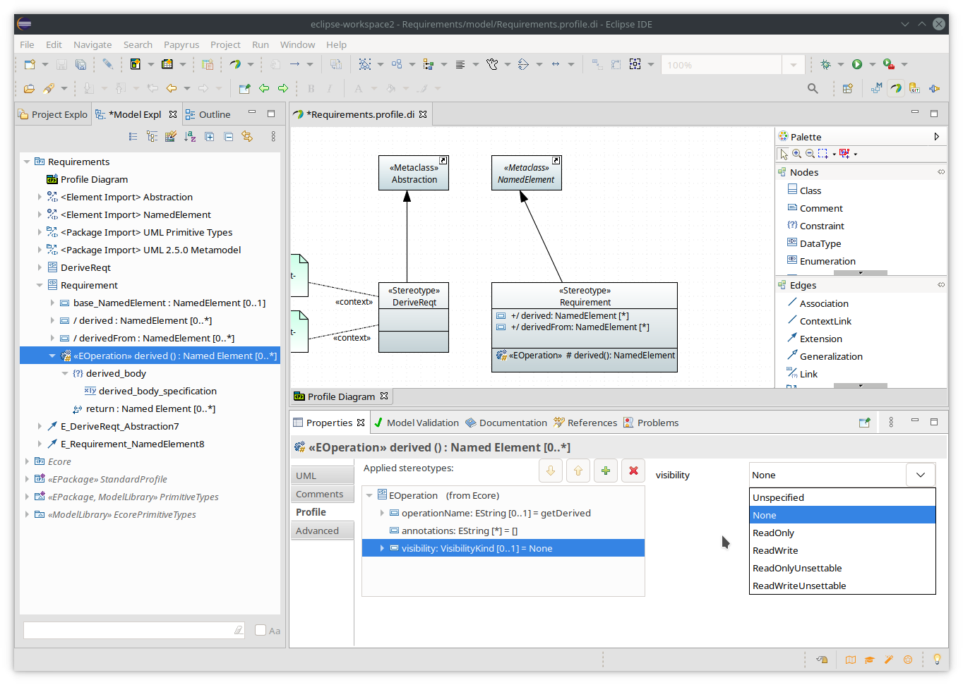

Re: Papyrus profiles with derived stereotype properties defined by same name operations [message #1835988 is a reply to message #1835974] Thu, 17 December 2020 13:57 Go to previous messageGo to next message
Hi, Deniz,
Find attached a version of your test_profile project that generates code as I think you are expecting. Compare this with the version that you originally attached to this thread, and you will see several changes:
- URI specified in the Profile element to generate a predictable namespace URI in the Ecore EPackage
- constraint names fixed to be valid Java identifiers (removing the leading numeric digits)
- derived properties made read-only (I think this is key to having the right code generated for them)
- derived-property shadow operations made
-- protected in the UML definition
-- renamed for Java in the «eOperation» stereotype
-- suppressed visibility (an Ecore concept) in the «eOPeration» stereotype
- body expressions fixed to navigate to the «requirement» stereotype application of the related elements, to conform to the operation return type (not to mention the derived property type)
In the generator model, I enabled the UML2 "operations" class generation pattern, although in this case they are not needed (and so not generated) because there are no operations that need to be filled in (no "TODO"s). You will see that the delegation to the modeled OCL constraints is generated in the RequirementImpl class.

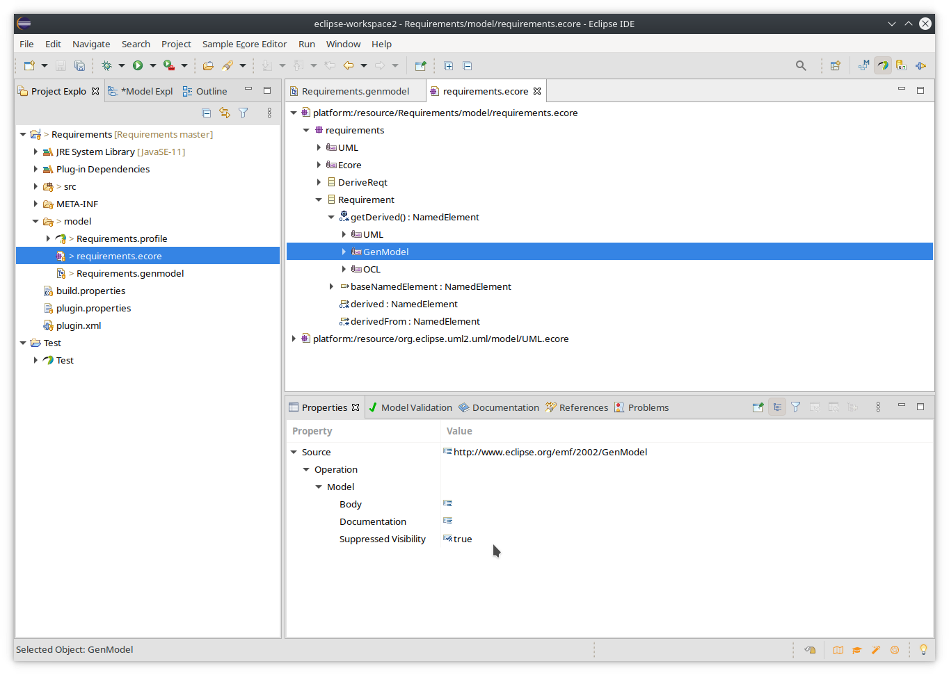

Re: Papyrus profiles with derived stereotype properties defined by same name operations [message #1836136 is a reply to message #1835988] Tue, 22 December 2020 05:45 Go to previous messageGo to next message
Hi Christian,
I am very close and once I am done I'll put up a detailed set of instructions here for future readers, which are struggling as I did, to follow.
One final item I'm stuck with is perhaps this suppressed visibility concept. I cannot see this visibility option in the Papyrus profile application of «EOperation» as shown in the capture image1.png
I do however I see an option in ecore file itself as seen in image2.png but that one is a boolean check "Suppressed Visibility" field. However I'm a little confused as the ecore file is generated from the Papyrus profile is it not? So this suppressed visibility should be set at the Papyrus profile level somehow, which I cannot see in the «EOperation» profile in image1.png

Re: Papyrus profiles with derived stereotype properties defined by same name operations [message #1836147 is a reply to message #1836136] Tue, 22 December 2020 09:06 Go to previous messageGo to next message
Hi, Deniz,
Right, sorry, the mapping from the Ecore Profile (UML) to "suppressed visibility" in the GenModel isn't as direct as my phrasing seemed to make it. Your attachment "image1.png" has it right: it is the "none" visibility kind in the Ecore stereotypes for properties and operations. This attribute of the stereotype is picked up by the UML importer when it creates the GenModel element for the operation, to set the property that you show in "image2.png". There is no representation of this visibility concept in Ecore, unless perhaps it be via a codegen-specific annotation.
So, I think you have the complete picture here.

Hi Christian,
Thank you for all this help, this is getting close...
When I define the plugin.xml file as per the default generated version as shown below, there are issues:
<plugin>
   <extension point="org.eclipse.emf.ecore.generated_package">
      <!-- @generated Requirements -->
      <package
            uri="http://www.eclipse.org/model/requirements"
            class="requirements.RequirementsPackage"
            genModel="model/Requirements.genmodel"/>
   </extension>
</plugin>
Papyrus registered profile application doesn't list the custom created "Requirements" profile as shown in image4.png.
When I define additional entension point for org.eclipse.papyrus.uml.extensionpoints.UMLProfile as shown below, I can access the registered profile application in Papyrus, however I cannot apply the "Requirement" Stereotype to any Class:
<plugin>
   <extension point="org.eclipse.emf.ecore.uri_mapping">
     <mapping
           source="pathmap://resources/model/"
           target="platform:/plugin/Requirements_1.0.0/model/">
     </mapping>
   </extension>
   <extension point="org.eclipse.papyrus.uml.extensionpoints.UMLProfile">
     <profile
           description="Basic example requirements profile"
           name="Requirements 1.0"
           path="pathmap://resources/model/Requirements.profile.uml"
           provider="Deniz Eren">
     </profile>
   </extension>
      <package
   </extension>
</plugin>
Papyrus registered profile application does list the custom created "Requirements" profile, but it cannot be applied to any of the classes A or B as shown in image5.png, image6.png and image7.png. After applying the Stereotype the "Applied Stereotypes" section of the class Profile is empty and later I get error messages reporting detached Stereotypes.
The only version I can get working is when I remove the generated extension org.eclipse.emf.ecore.generated_package, but that's just the same as applying Requirements.profile.uml as a non-registered profile and I suspect it isn't even using the Java generated code, as all the Constraints supplier_is_requirement and client_is_requirement behave as they would when you just apply non-registered profile Requirements.profile.uml:

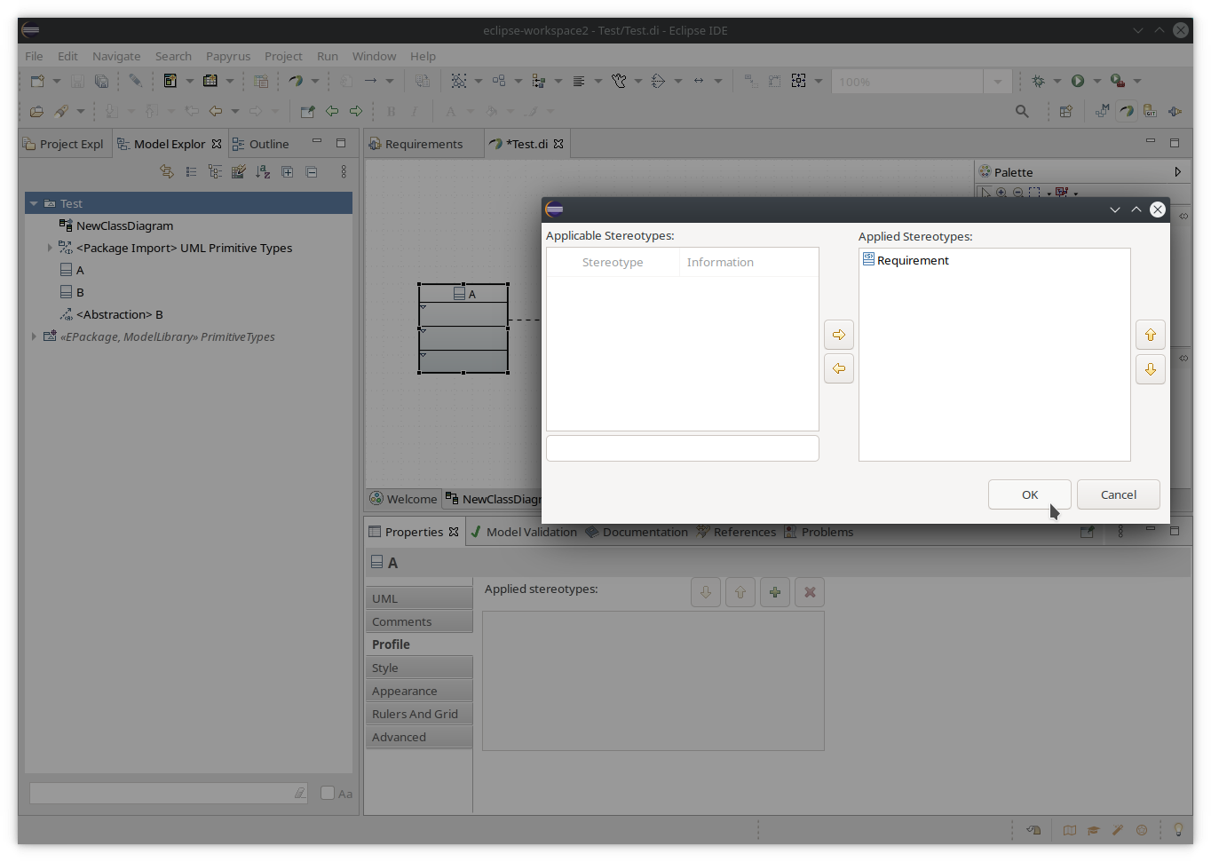

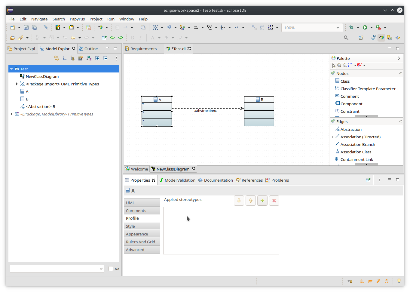

Re: Papyrus profiles with derived stereotype properties defined by same name operations [message #1836361 is a reply to message #1836235] Wed, 30 December 2020 02:52 Go to previous messageGo to next message
Hi Christian,
Happy to raise any bug reports once the issue is resolved, but I now tried with and without the dynamic profile definition with no luck.
So I went back to the drawing board to eliminate any unknowns, I re-installed eclipse (the new eclipse/modeling-2020-12). I stopped trying to get the fancy derived property working and just have a simple Stereotype extending an Abstraction, with no other contents. I followed the text book description of static profiles from documentation:
https://help.eclipse.org/2020-12/topic/org.eclipse.papyrus.uml.diagram.profile.doc/target/generated-eclipse-help/users/generatingStaticProfiles.html?cp=74_0_1_8_5
But when I try to create a Papyrus UML model to apply this registered profile, it allows me to find and apply it to the package, but when I try to apply it to an Abstraction element it doesn't display the Stereotype. I looked in the Test.uml file and see:
<xmi:XMI xmi:version="20131001" xmlns:xmi="http://www.omg.org/spec/XMI/20131001" xmlns:ecore="http://www.eclipse.org/emf/2002/Ecore" xmlns:testplugin="http://www.mycompany.com/Testplugin/1" xmlns:uml="http://www.eclipse.org/uml2/5.0.0/UML">
  <uml:Model xmi:id="_slOegEpsEeu6tYPtsHWdHw" name="Test">
    <packageImport xmi:type="uml:PackageImport" xmi:id="_srHEEEpsEeu6tYPtsHWdHw">
      <importedPackage xmi:type="uml:Model" href="pathmap://UML_LIBRARIES/UMLPrimitiveTypes.library.uml#_0"/>
    </packageImport>
    <packagedElement xmi:type="uml:Class" xmi:id="_BozpMEpxEeuASrB-BFX7sQ" name="A"/>
    <packagedElement xmi:type="uml:Class" xmi:id="_CSxzQEpxEeuASrB-BFX7sQ" name="B"/>
    <packagedElement xmi:type="uml:Abstraction" xmi:id="_C_GtwEpxEeuASrB-BFX7sQ" client="_BozpMEpxEeuASrB-BFX7sQ" supplier="_CSxzQEpxEeuASrB-BFX7sQ"/>
    <profileApplication xmi:type="uml:ProfileApplication" xmi:id="_A4bVIEpxEeuASrB-BFX7sQ">
      <eAnnotations xmi:type="ecore:EAnnotation" xmi:id="_A4fmkEpxEeuASrB-BFX7sQ" source="http://www.eclipse.org/uml2/2.0.0/UML">
        <references xmi:type="ecore:EPackage" href="http://www.mycompany.com/Testplugin/1#/"/>
      </eAnnotations>
      <appliedProfile xmi:type="uml:Profile" href="pathmap://MYLANG_PROFILE/testplugin.profile.uml#_wMd84EpqEeuF1anrashfZA"/>
    </profileApplication>
  </uml:Model>
  <testplugin:Stereotype4 xmi:id="_DwEQoEpxEeuASrB-BFX7sQ"/>
  <testplugin:Stereotype4 xmi:id="_aopK4EpxEeuASrB-BFX7sQ"/>
</xmi:XMI>
The Stereotype application segment references unknown xmi:id's also as expected, being reported as dangling stereotypes by Papyrus:
So as you can see I'm just trying to get a simple static profile working now and no luck. I've attached the profile and model I tried to replicate from the documentation link above.
I also tried to experiment with the location I'm installing the plugin, i.e. /home/deniz/eclipse/modeling-2020-12/eclipse
The way I'm installing the plugin to my workspace is by clicking on File -> Export -> Select Plug-in Development [Deployable plug-ins and fragments] -> Install into host. Repository: /home/deniz/eclipse/modeling-2020-12/eclipse
Is there something obviously wrong with what I'm doing? Because I'm just after getting a "hello world" Papyrus static profile plug-in working now ONLY ....
Your help is appreciated!

Hi Ed, hi Christian,
The issue of getting a basic Papyrus static profile working is now SOLVED!
Next step is for me to return to the original issue of getting the derived property magic working as discussed early on with Christian (will post future comment to summarise that when I get it working). However, in this comment I'm summarising the findings of getting the basic static profile working and how to get past the "base_Class" to "baseClass" naming issue and resultant static profile failure as discussed above.
Firstly on an unrelated note, because I want to also use the SysML 1.6 profile (for purposes other than the items discussed in this thread), I installed Eclipse Modelling Version 2020-06. Looking at the SysML 1.6 Git repository the last officially tested version seems to be 2020-06 as of this date. Also I tried 2020-12 and it gives some strange string error, so for the time being I'm using 2020-06.
Then using the Eclipse Marketplace I installed SysML 1.6 and via the dependencies it installed Papyrus for UML 4.8.0. Just mentioning versions for future reference just in case it is important to future readers, however the features discussed are common for a long time. I am also not sure if the issues discussed are bugs or expected behaviour. Anyway, I am writing this comment for future readers that have come across the same issues.
Firstly I followed the Generating Static Profiles section of the Papyrus Guide:
https://help.eclipse.org/2020-12/topic/org.eclipse.papyrus.uml.diagram.profile.doc/target/generated-eclipse-help/users/generatingStaticProfiles.html?cp=73_0_1_8_5
UML Import Options seemed unimportant/irrelevant to me and at least the Papyrus Guide didn't have any further documentation on what exactly these Options do. In short - do NOT overlook or underestimate these options! Here are my findings...
In the UML Import section after clicking on your profile.uml model or clicking "Load" with the default Options as shown also in the Papyrus Guide, there will be a number of warnings given such as: "Feature 'UML::Element::ownedElement' should be annotated as a union and made non-changeable".
Originally I was clicking on "Process All" to make these warnings go away, however I stopped doing that and instead ignored the warnings and clicked Next.
Then followed the rest of the Papyrus Guide and set the Extensions etc...
To test (most would know this but thanks to Christian this was a good learning for me) - from the menu click on "Run" -> "Run Configurations" then under the tab "Eclipse Application" create a new configuration. If you check the "Plug-ins" tab you will see the default settings "all workspace and enabled target plug-ins" will mean your test profile "com.mylanguage.profile" will be installed to the test workspace instance that will start when you Run the configuration.
Inside the Run configuration Eclipse environment create a simple Papyrus UML model and apply your registered profiled and it will all work as expected!

For future readers that are also interested in static profiles, attached is my now working solution. It contains the static profile within a small Git repo and a "Test" UML model that utilises it.
I have not been able to get the EOperation auto-generated derived property method to work, however I prefer to use the same way SysML solves this problem, by manually coding the desired behaviour in Java.
In the example here, check the class RequirementImpl for the hand coded Java for getDerived and getDerivedFrom functions. For example:

You haven't identified why the OCL code generation doesn't work.
Once I reload the genmodel I can generate code with plenty of OCL-derived code. The Requirement::derived() operation has code, but the getDerived() does not since it derives from a Property without any initializer to define its functionality.
If you want to use the crazy UML idiom that X == X() you need an enhanced CG or a modified UML loader. There is a fudge along these lines to support the CG of the UML metamodel, but I'm afraid I forget where. I recommend that you use a sensible policy of defining a property behaviour on the property rather than relying on a non-standard redirection to a conicidentally same-named operation.

Thank you for the reply! I actually didn't realise the functions generated named "derived()" and "derivedFrom" are actually the OCL constraints I've created within the same named operations.
The OCL now works! Greatly appreciated! See further how I got it working...
I just made the simple change where I invoke derived() from getDerived() and derivedFrom() from within getDerivedFrom() instead of custom Java code, and it all works fine:
