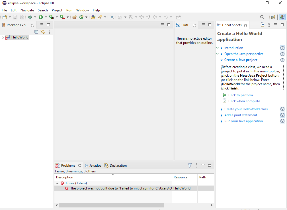

I'm very very new to Java, and I am finding the whole experience hard to understand.
For starters, I was trying to run the hello world application on Eclipse. This is a fresh install of the latest Java 15, followed by the latest install of Eclipse 2020-09 (4.17.0).
As soon as I try to create the HelloWorld project following the built-in tutorial, I am confronted with the following error.
The project was not built due to "Failed to init ct.sym for C:\Users\Owner\AppData\Local\Temp\eoi6CE0.tmp\plugins\org.eclipse.justj.openjdk.hotspot.jre.minimal.stripped.win32.x86_64_14.0.2.v20200815-0932\jre\lib\jrt-fs.jar". Fix the problem, then try refreshing this project and building it since it may be inconsistent
This error message happens as soon as I create the project (Step 1). I haven't even entered in any code yet.

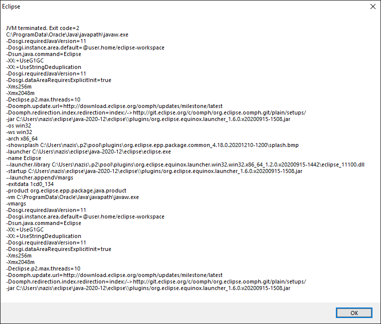

Dear Ed Merks
I have Installed jdk 15.0.1
Then Installed Eclipse 2020 12
and facing same problem
and when I close the IDE and start it again it wont start and shows a white screen with JVM terminated Exit code = 2 and lots of other lines

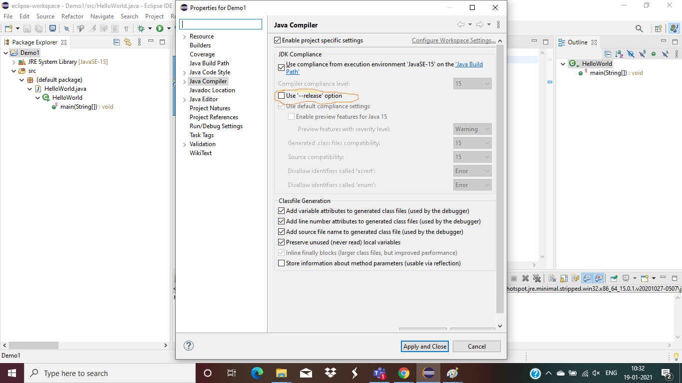

The workaround is the following: open the project properties by right-clicking on it in the package explorer. Go to the Java Compiler section and uncheck the Use '--release' option box. Select Yes to rebuild the project.

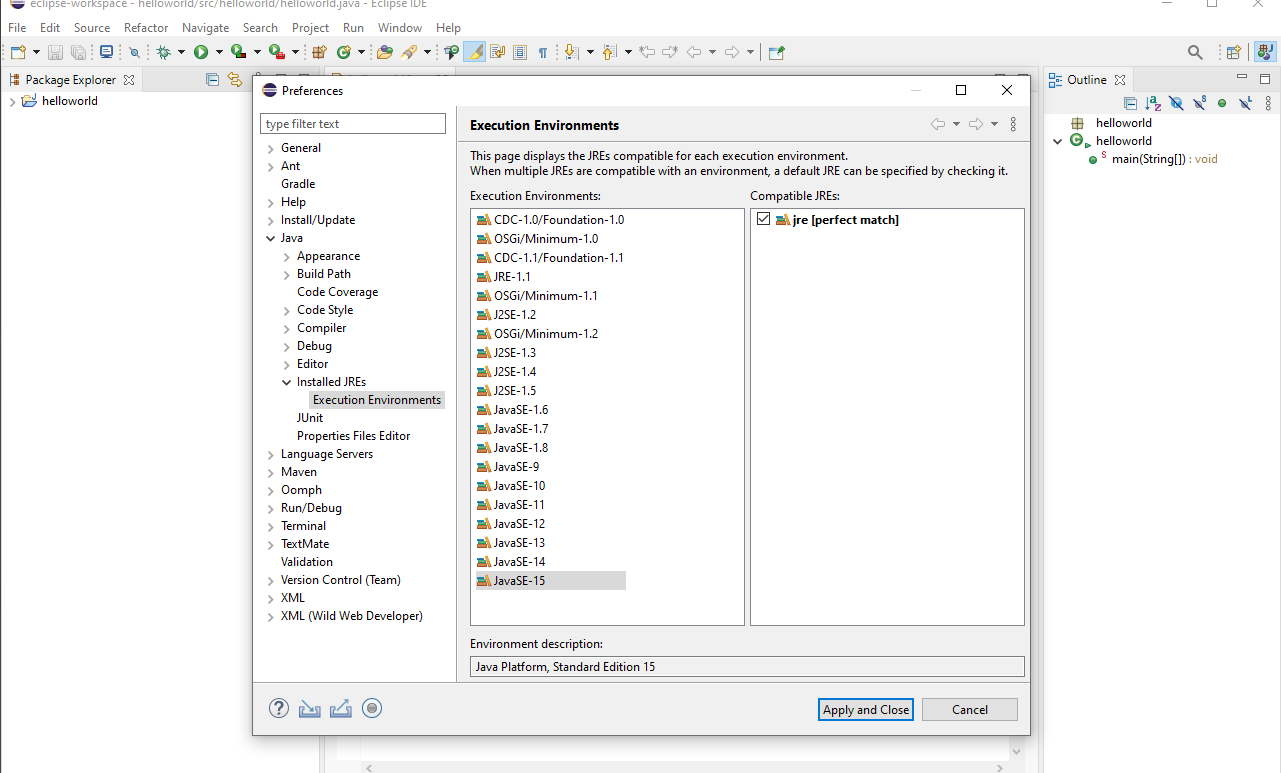

I am a complete noob, but this fixed problem for me:
window-preferences-java(dropdown)-installed JREs(dropdown)-execution environments
there i clicked on last execution environment (JavaSE-15)
then in Compatible JREs I put a check mark at jre
then apply and close
done :)
