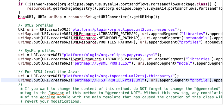

Hello all together
according to https://wiki.eclipse.org/Acceleo/FAQ
These lines should be added to the "registerPackages(...)" method to access UML/SysML profiles.
Map<URI, URI> uriMap = resourceSet.getURIConverter().getURIMap();
// UML2 profiles
URI uri = URI.createURI("platform:/plugin/org.eclipse.uml2.uml.resources");
uriMap.put(URI.createURI(UMLResource.LIBRARIES_PATHMAP), uri.appendSegment("libraries").appendSegment(""));
uriMap.put(URI.createURI(UMLResource.METAMODELS_PATHMAP), uri.appendSegment("metamodels").appendSegment(""));
uriMap.put(URI.createURI(UMLResource.PROFILES_PATHMAP), uri.appendSegment("profiles").appendSegment(""));
// SysML profiles
uri = URI.createURI("platform:/plugin/org.eclipse.papyrus.sysml");
uriMap.put(URI.createURI(SysmlResource.LIBRARIES_PATHMAP), uri.appendSegment("librairies").appendSegment(""));
uriMap.put(URI.createURI("pathmap://SysML_PROFILES/"), uri.appendSegment("model").appendSegment(""));
// For RTSJ (real time Java)
uri = URI.createURI("platform:/plugin/org.topcased.uml2rtsj.thirdparty/");
uriMap.put(URI.createURI("pathmap://RTSJ_PROFILE/rtsj.uml"), uri.appendSegment("profile").appendSegment(""));
I simply added them to the method and changed @Generated to @Generated NOT. But Java does not recongnize the code... I have something like this:
Does anyone know why?
Re: UML/Sysml Profile.. [message #1835736 is a reply to message #1835661] Fri, 11 December 2020 01:15 Go to previous message
Screenshots are a very poor partial way of reporting problems. For instance what is the hover text on your red squiggles. My guess is that you haven't bothered to use an imports quickfix.
