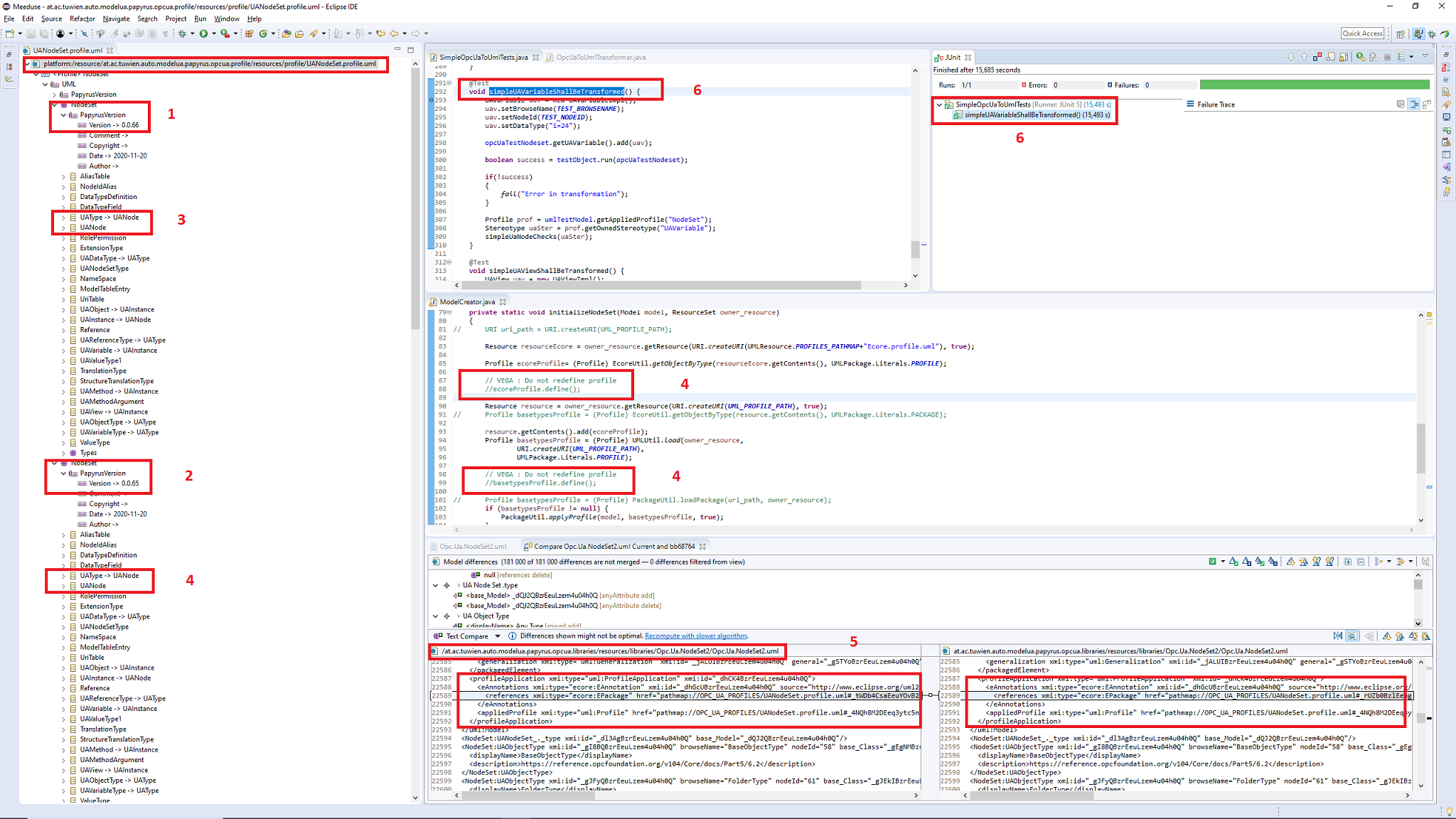

Re: JUnit Test UML Model setValue IllegalArgumentException [message #1835886 is a reply to message #1835835] Tue, 15 December 2020 13:38 Go to previous messageGo to next message
Hello Christoph,
Finally I got the environment set faster than expected.
I debugged your test case, and I think all your problems arise because your profile is defined several times.
Take a look you look at the attached image.
index.php/fa/39562/0/
You will notice on the left of the figure that you have 66 definitions of your profile.
Every time you define a profile, a new EPackage is created that defines the EClasses that are instantiated when you apply the stereotype. For example, you can notice that there are two EPackages NodeSet (version 66 numbered 1 and version 65 numbered 2) in the figure, with two different EClasses UAnode (numbered 3 and 4 respectively in the figure).
I looked at your library (Opc.Ua.NodeSet2/Opc.Ua.NodeSet2.uml) and it applies version 63 of the stereotypes of the profile.
In your test case, you create your model using the latest version of the profile, then apply the stereotypes to the model. This will create instances of version 66 of the EClass UAVariable.
Then you load your library (in method ModelCreator.loadBaseNodeSet), this will create instances of version 63 of the EClass UADataType to represent the applied stereotypes.
Then, you start your transformation and at some point it tries to set the value of the 'datatype' reference (in method OpcUaToUmlTransformer.transformUaDatatype), EMF verifies that the value that you are trying to set (dataTypeObject) is of type UAnode. The problem is that EMF is validating against version 66 of UAnode and your object is an instance of version 63 of UADataType that inherits from version 63 of UAnode. And from the point of view of EMF they are not the same class.
This is for the diagnostic, how to fix it?
1) The first thing that I noticed is that you programatically define the profile (in method ModelCreator.initializeNodeSet see number 4 in the figure). Do not do that, this creates yet another version of the EPackage. I commented this part of the code, as you can see in the figure.
2) The second thing that I did was to manually upgrade the library (see number 5 in the figure) to use the latest version (66) of the defined profile.
Once I did that, I could run the Junit test and it passed (see number 6). I only tried this test case, and run it manually (without maven). It may be other problems, I did not tried to understand your code, I simply tried to get to the point of the exception.

Re: JUnit Test UML Model setValue IllegalArgumentException [message #1836015 is a reply to message #1835971] Fri, 18 December 2020 04:30 Go to previous message
I just implemented your fix from your prior post in my code and it works. I checked your modified version of my ModelCreator and as I expected most code you commented code was code I copied and adapted in desperation.
I'm so annoyed that I didn't think that the issue was caused by having different versions of the profile. I ran some times into the same issue in other places in Papyrus, but it had a different
manifestation.
BR Christoph
