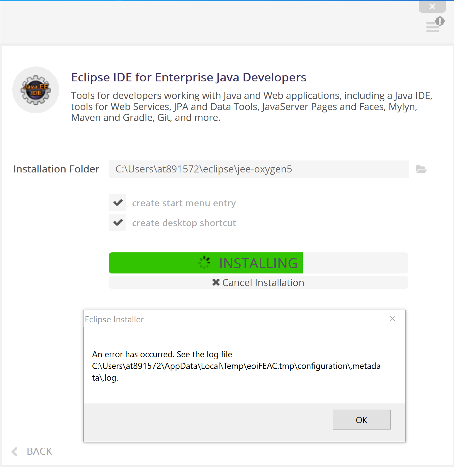

I'm trying to install Eclipse, but get en error.
Here is what in the log file:

Could you please advice what I can do with it?
