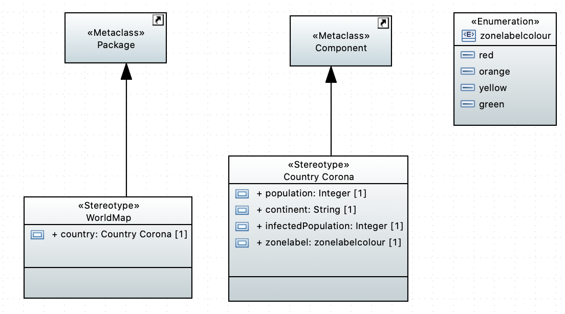

I was able to fix some of these stuff, but now I have another issue.
This is my model:

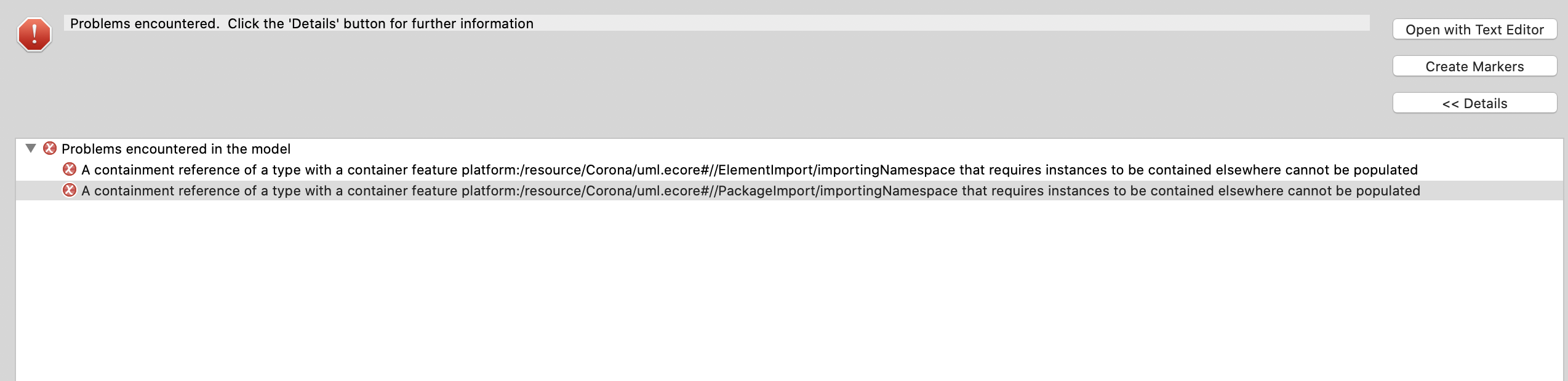

index.php/fa/39295/0/
When I generate the ecore, the .genmodel contains an error as follows:
index.php/fa/39296/0/]

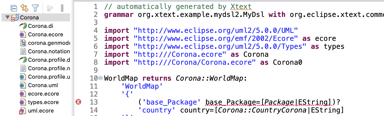

I then configure the project where the ecore and genmodel are into an xtext project . When I generate the xtext grammar for it I get the following:
index.php/fa/39297/0/
The error is:
Cannot find compatible feature base_Package in sealed EClass
   WorldMap from imported package http:///Corona.ecore: The existing
   reference 'base_Package' has an incompatible type 'Package'.
   The expected type is 'Package'.

Ok, so here I have uploaded my UML profile.
The steps I follow to generate the XText grammar are as follows:
Step 1
New -> Other -> EMF Generator Model
Filename:corona.genmodel
Model Importers: UML Model
Model URIs: platform:/resource/Corona/Corona.profile.uml
Root Packages: Corona
References generator models: ECore, Types, UML
Finish
Step 2
Right click on the project -> Configure-> Convert to Xtext Project
Step 3
New -> XText Project from existing ecore models
Add EPackages (corona.genmodel - /Corona)
Entry Rule: WorldMap Corona
Finish
When I do it this way, in the new generated grammar I have issues such as:
Line 15
Multiple markers at this line
- Couldn't resolve reference to EClassifier 'EString'.
- extraneous input '|' expecting RULE_ID
Line 19
- Cannot create type 'EDataType' in alias null
- The rule 'EDataType' may be consumed without object instantiation.
Add an action to ensure object creation, e.g. '{null}'.
- missing RULE_ID at ':'
