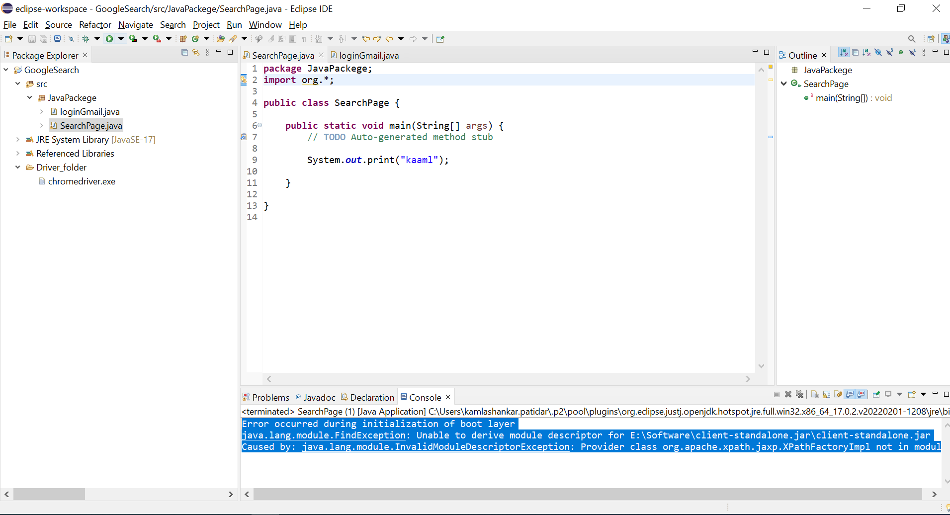

Re: Error occurred during initialization of boot layer [message #1850720 is a reply to message #1838802] Tue, 15 March 2022 08:13 Go to previous message
Hi there,
I'm getting also same error.
java.lang.module.FindException: Unable to derive module descriptor for E:\Software\client-standalone.jar\client-standalone.jar
Caused by: java.lang.module.InvalidModuleDescriptorException: Provider class org.apache.xpath.jaxp.XPathFactoryImpl not in module
  • Attachment: error.PNG
    (Size: 110.61KB, Downloaded 1188 times)
