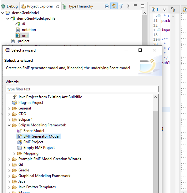

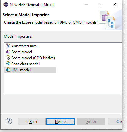

right-clik on the profile.uml file, then New -> Others -> Eclipse Modeling Framework -> EMF Generator Model [1], then on the next wizard page called Select A Model Importer, you must select UML model [2].
[1] index.php/fa/40295/0/
[2]index.php/fa/40296/0/
/Vincent

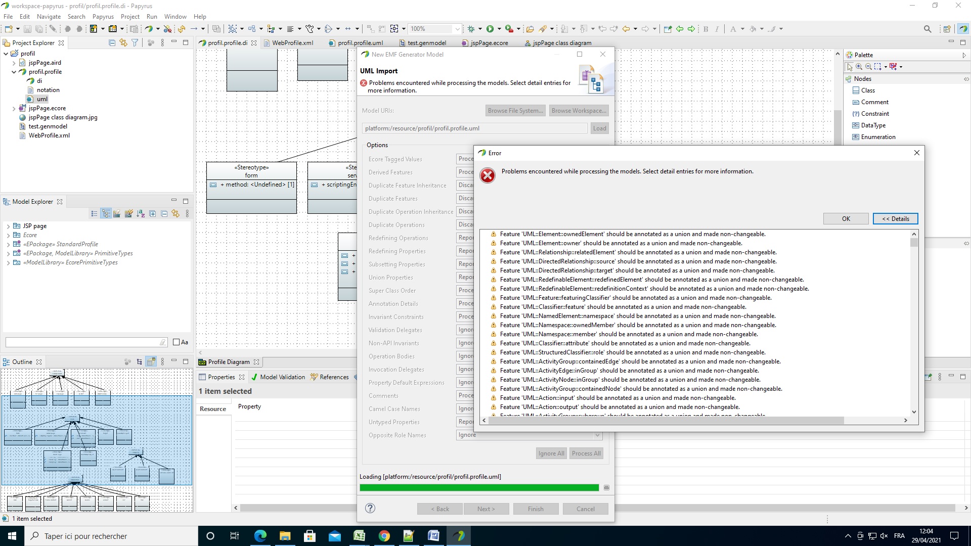

Re: Generate ecore model from UML Profile [message #1840949 is a reply to message #1840193] Thu, 29 April 2021 08:09 Go to previous messageGo to next message
hello
thank you for your feedback , sorry for the delay , I already did that but every time a message error appear
index.php/fa/40418/0/
  • Attachment: profil.jpg
    (Size: 656.28KB, Downloaded 1188 times)
Re: Generate ecore model from UML Profile [message #1840960 is a reply to message #1840949] Thu, 29 April 2021 09:36 Go to previous messageGo to next message
The 'union' messages are a common nightmare, but IIRC they are usually down to user error.
Have you tried following the tutorials?
Other users seem to manage ok, so you should be able to solve the problem, but if not there is no way anyone can help you from *.jpg. You must provide at least the *.uml and preferably a zipped project and Eclipse configuration text file.
Ed Willink

If you use the UML Model Editor to validate your profil.profile.uml you will see that many Stereotypes have duplicate base_Class properties which is guaranteed to cause chaos. I suspect that you may have accidentally done a bad cut and paste to create the prolific duplicates. Anyway, you should aim at a warning free UML Model Editor validation before trying to get anything else to work.
Ed Willink
