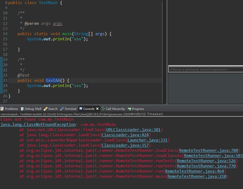

This is error image
index.php/fa/39149/0/

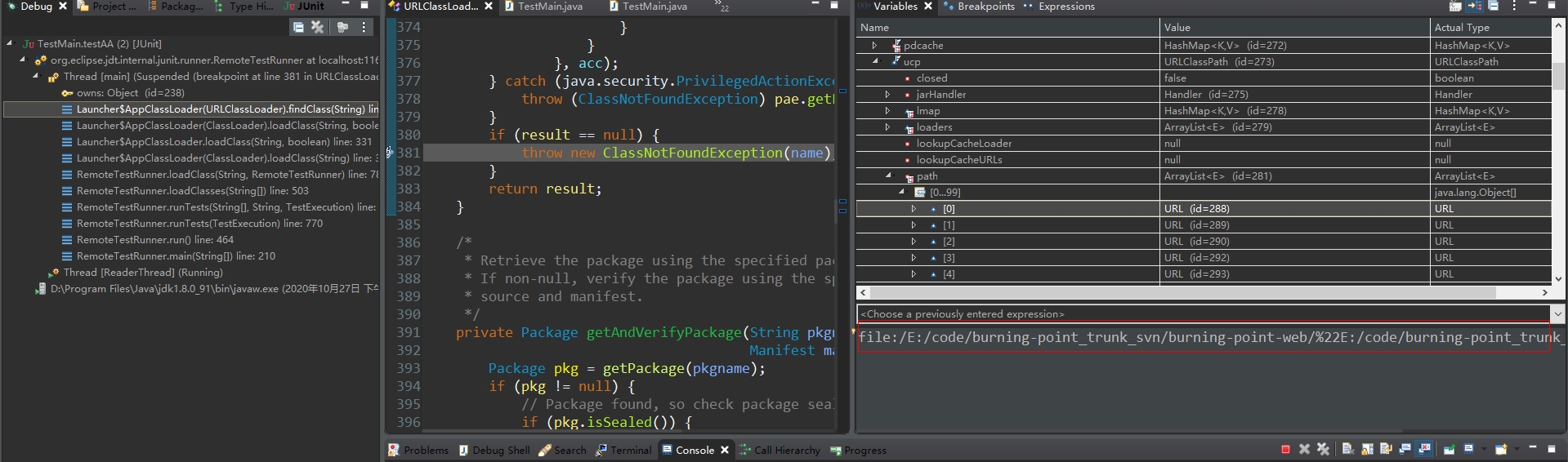

This is debug image.
index.php/fa/39151/0/
I find AppClassLoader path unusual.
path[0] = "file:/E:/code/burning-point_trunk_svn/burning-point-web/%22E:/code/burning-point_trunk_svn/burning-point-web/bin"
I guess this is the cause of the error. But don't know how to solve it.

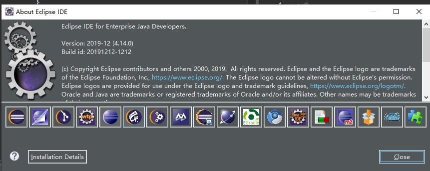

Eclipse version:
index.php/fa/39150/0/

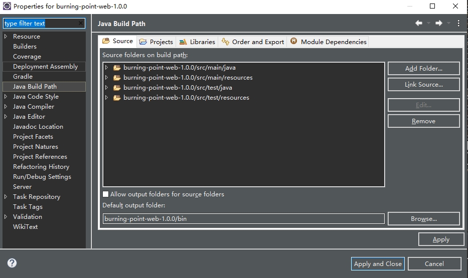

Project Build Config:
index.php/fa/39152/0/

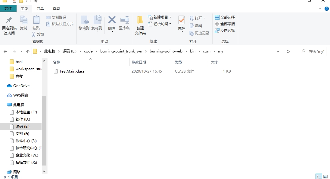

Project Bin :
index.php/fa/39153/0/

Are you able to successfully run the program having the main method as a Java application? This is to identify if the launching issue is only with the JUnit test or a general problem probably due to the path format.
