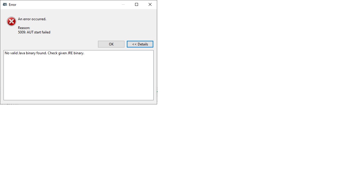

4. From the Jubula GUI I click the Start AUT button - I get two popup - I click 'Proceed' on the first one and then the error message:
"An error occurred. Reason: 5009 AUT start failed"
"No valid Java binary found. Check given JRE binary"
index.php/fa/39103/0/
Does anyone know what I might be missing in my setup please?

This error occurrs if there is some configuration problem with the AUT.
The error message ist misleading most of the time, because it says there is an issue with the JRE but that must not be the case.
Have a look into the jubula logs located in: %USER_HOME%/.jubula/logs . Maybe in one of the logs there is more information.
Also try to change some of the settings sometimes it is a simple configuration issue,
best regards
