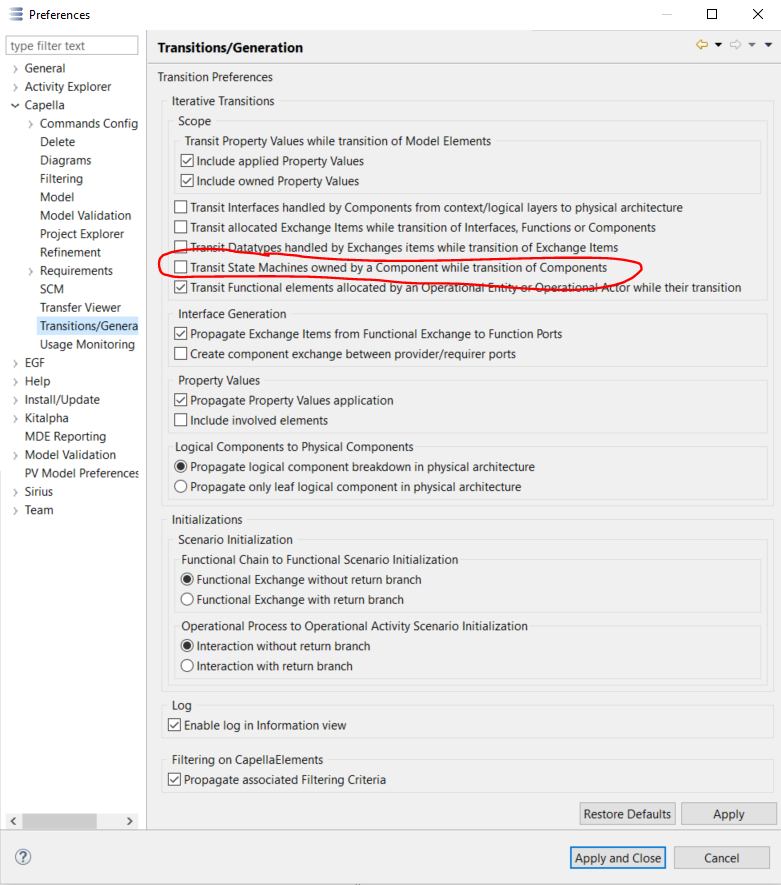

Re: Life phase analysis [message #1832745 is a reply to message #1832705] Thu, 24 September 2020 06:11 Go to previous messageGo to next message
Hi Thierry,
Not sure about the "cascade" your considering.
If transitions between engineering phases, the transition of state machines isn't included by default. However, you can add this using preferences
index.php/fa/38978/0/
If transition using the System to Subsystem addon, state machines should be transitionned.
Samuel
