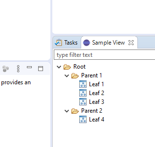

I expand out all the nodes in the Sample View
index.php/fa/38616/0/

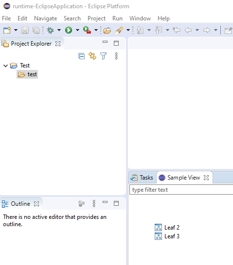

I select one of them ('Leaf 2' under 'Parent 1')
I then select the folder I created in the Project Explorer.
I then CTRL+ left click on the 'Leaf 2' node again.
The other nodes in the tree disappear.
index.php/fa/38617/0/
I can sort of paint them back in again by moving the mouse cursor over where they should be.

Re: FilteredTree repaint issues with DND enabled [message #1830274 is a reply to message #1830259] Wed, 22 July 2020 09:54 Go to previous messageGo to next message
This sounds a bit like this problem:
https://bugs.eclipse.org/bugs/show_bug.cgi?id=526694
No one seems to care to fix it, and then the bug gets closed because no one even responds...
Re: FilteredTree repaint issues with DND enabled [message #1830303 is a reply to message #1830274] Thu, 23 July 2020 02:28 Go to previous messageGo to next message
I have re-opened the bug report.
Can you attach the example to reproduce the issue to the bug report?
Re: FilteredTree repaint issues with DND enabled [message #1830359 is a reply to message #1830303] Fri, 24 July 2020 02:43 Go to previous messageGo to next message
Hi Rolf, my example code is attached. I think you're referring to Ed Merks' issue?
Re: FilteredTree repaint issues with DND enabled [message #1830375 is a reply to message #1830359] Fri, 24 July 2020 07:07 Go to previous message
Yes, can you add the code to the bug report https://bugs.eclipse.org/bugs/show_bug.cgi?id=526694
