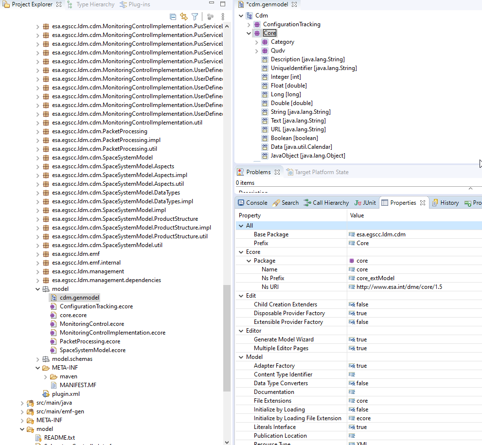

!ENTRY org.eclipse.emf.edit.ui 2 0 2020-07-13 10:50:28.571
!MESSAGE org.eclipse.core.internal.resources.ResourceException: Resource '/esa.egscc.ldm/model/core.ecore' does not exist.
!STACK 0

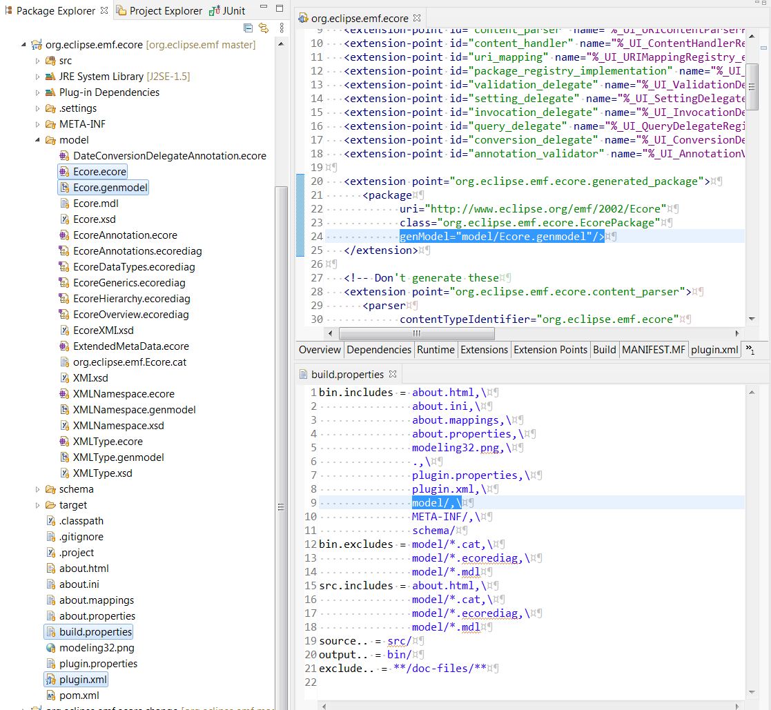

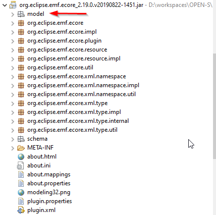

Re: Referenced model in a jar [message #1829874 is a reply to message #1829865] Mon, 13 July 2020 06:09 Go to previous messageGo to next message
Looking at your png, it suggests to me that you've made the model folder be also a Java package. Don't do that; putting the model in a "package" results in it being copied to the bin folder and result in it having a different relative at runtime than it does at development time.
I expect it to look like this:
index.php/fa/38564/0/
So the model folder is just a plan folder and the build.properties specifies the model folded is included in the binary plugin. The path of the *.genmodel is relative to the plugin and works that way at development time and at runtime via this same relative path.

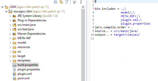

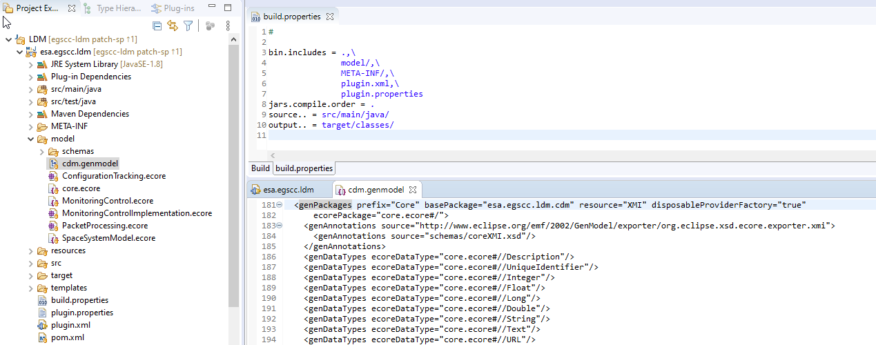

Re: Referenced model in a jar [message #1829878 is a reply to message #1829874] Mon, 13 July 2020 07:03 Go to previous messageGo to next message
Not sure why you think the model folder is a package. Perhaps I should have said that the picture is from the Plug-In Dependencies. When I look at the Ecore plug-in in the Plug-In Dependencies the model folder has the same symbol:
index.php/fa/38565/0/
Looking at our plug-in in the workspace gives this picture with a proper folder icon:
index.php/fa/38566/0/
  • Attachment: ecore2.png

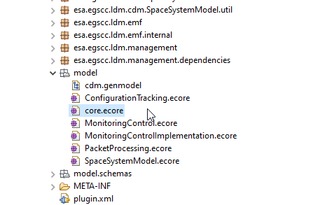

Ok, I will try to be more complete. The .genmodel is by the way visible in my first screenshot. Sorry for not showing the root - there are too many packages in the way.
Here is another workspace view:
index.php/fa/38567/0/

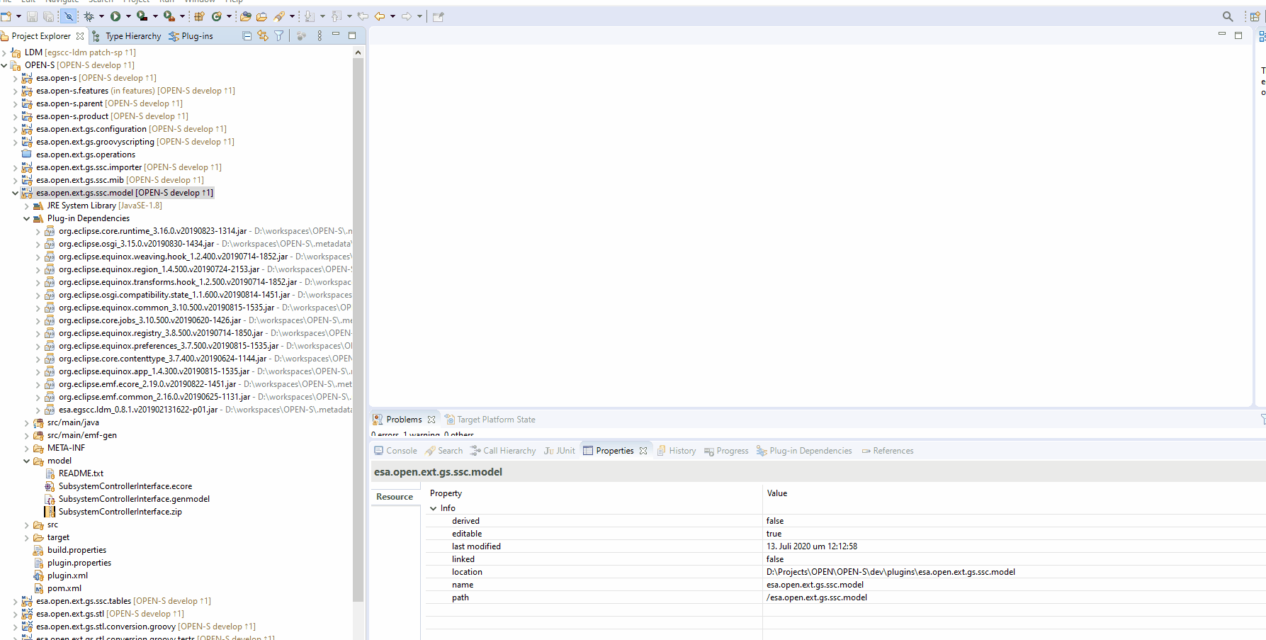

And here a plugin dependency view:
index.php/fa/38568/0/

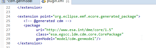

Here is the extension in plugin.xml:
index.php/fa/38569/0/
Thank you for spotting any potential issues and/or asking more questions :)

Re: Referenced model in a jar [message #1829886 is a reply to message #1829884] Mon, 13 July 2020 08:28 Go to previous messageGo to next message
That all appears to be in order, so I'm running out of ideas of what's going wrong. Could you show me the contents of the MANIFEST.MF? The fact that no URI is presented suggests that computing the map from Ecore models to their locations did not actually manage to load the *.genmodel...
Can you show me the dialog where you try to load the .../core/1.5 Ecore model from the target platform?
