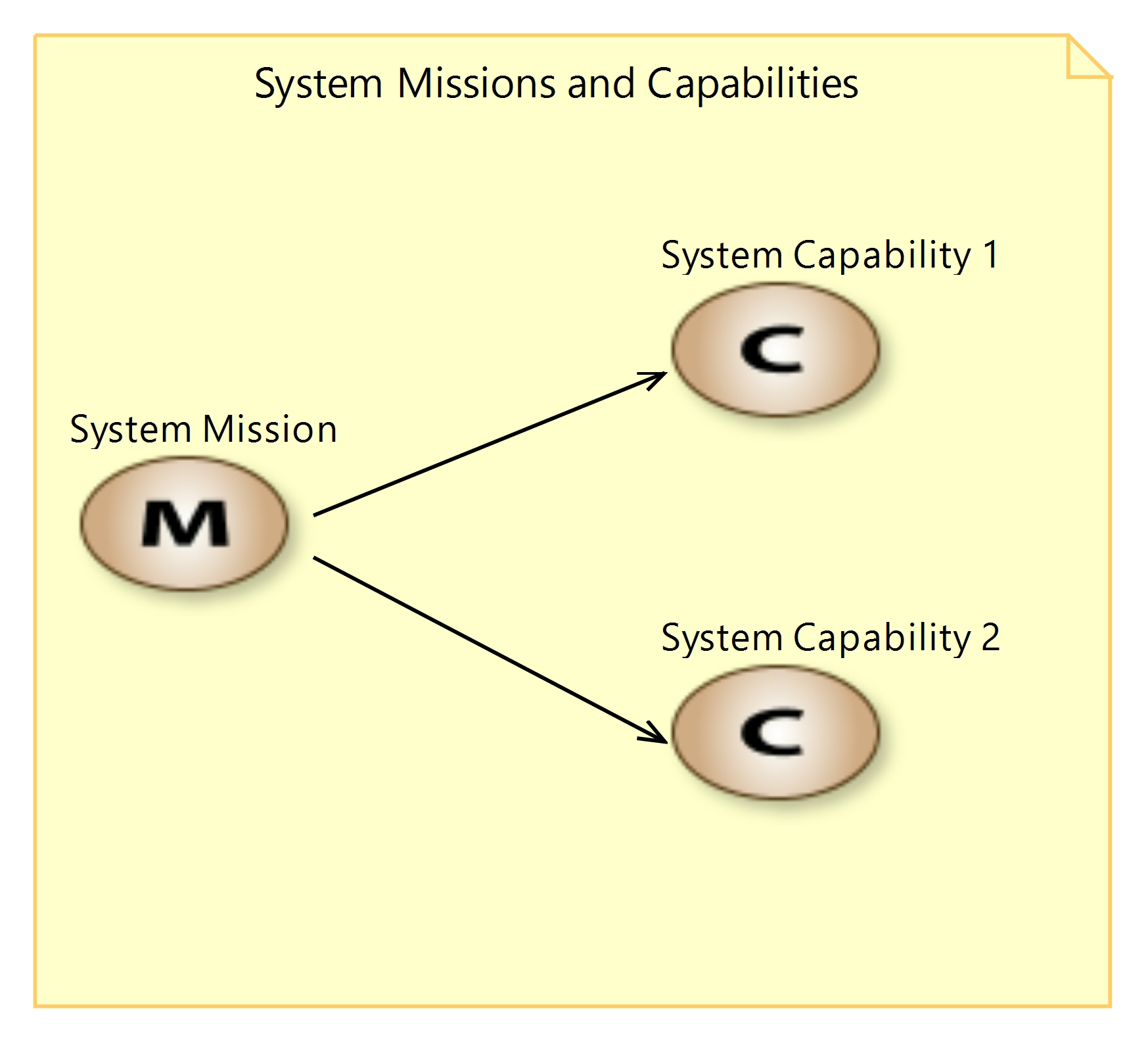

Re: Mission, Capabilities and Functions [message #1829360 is a reply to message #1829340] Wed, 01 July 2020 19:00 Go to previous messageGo to next message
First of all about capabilities. You can manipulate Capabilities in the 4 engineering perspectives (OA/SA/LA/PA) but they have different meanings depending on which perspective you are.
System Capabilities you have created are by definition Capabilities of the System, and as they are on the SA, they are expressing the need.
At the LA/PA level, they are Capability Realisations, so expressing the solution.
If you want to explicitly show you that they are System Capabilities, please find attached an example of how to do it using a Note.

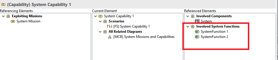

Also, about linking Capabilities with Functions: There is an "Involved System Functions" relation between Capabilities and Functions. This relation is automatically calculated based on the Function Scenario or Functional Chains you create under a Capability (but you can also manually enter functions here using the property tab).
This relation is easily seen using the semantic browser on a Capability (see the example attached).
I hope this helps.
