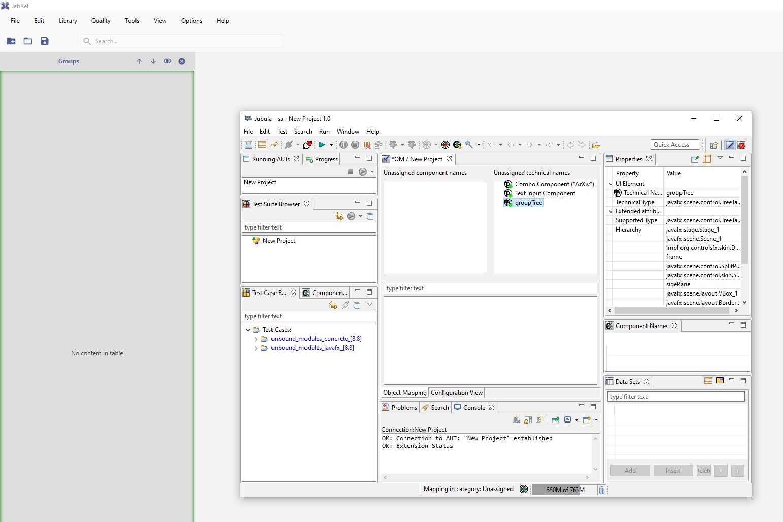

I have tested the latest JabRef version and i could map the components.
Please try again and do not use the --add-opens. It seems due to how it uses the javafx it has moved into another module or library(but i could not find out in the short time where it did move into). Maybe it is not necessary at all in that case. But even if it is necessary The only Problem is that some components might not work quite weill for the moment.
index.php/fa/38456/0/
best regards
Marvin Mueller
  • Attachment: JabRef.jpg
    (Size: 188.89KB, Downloaded 475 times)
