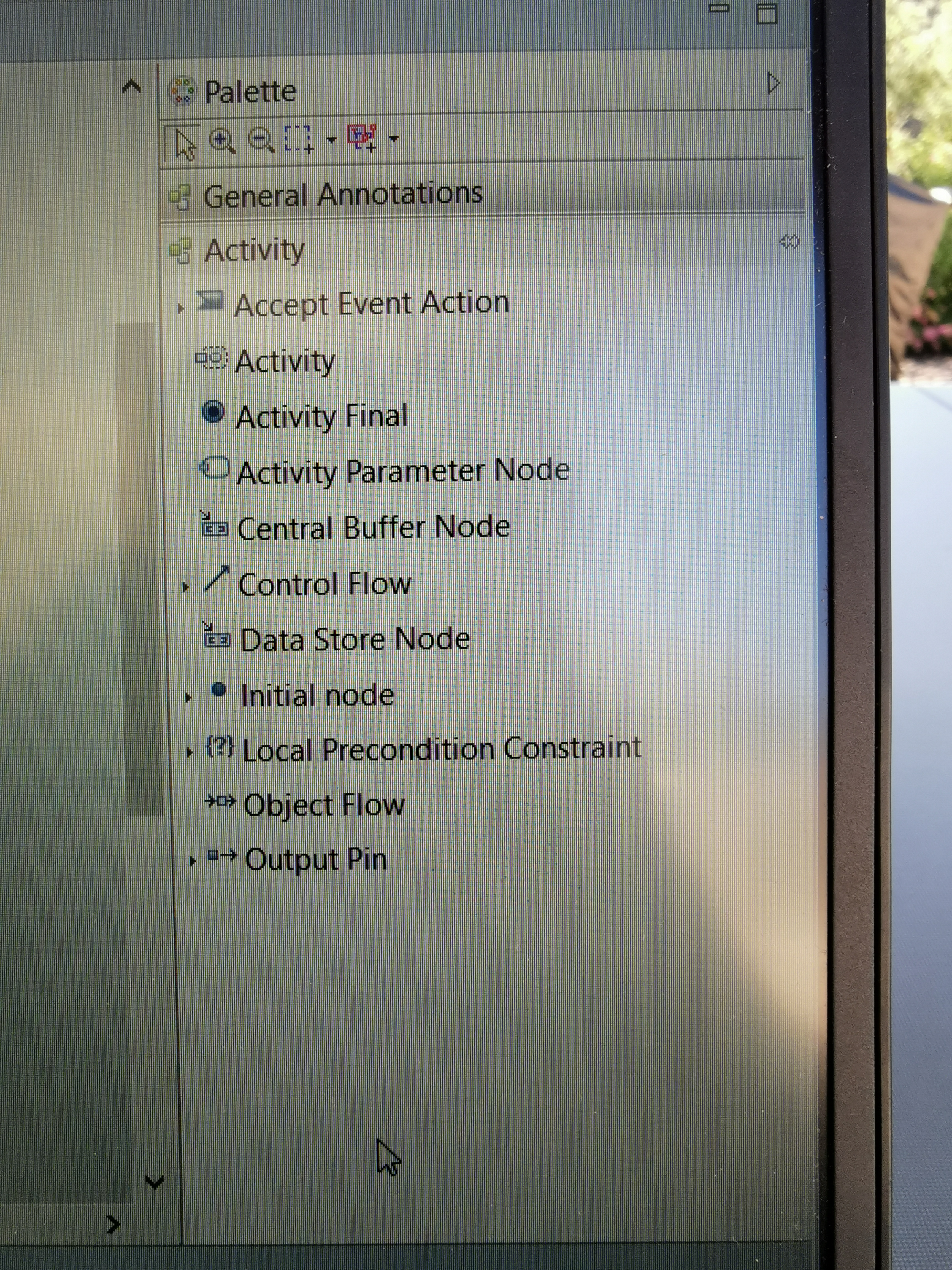

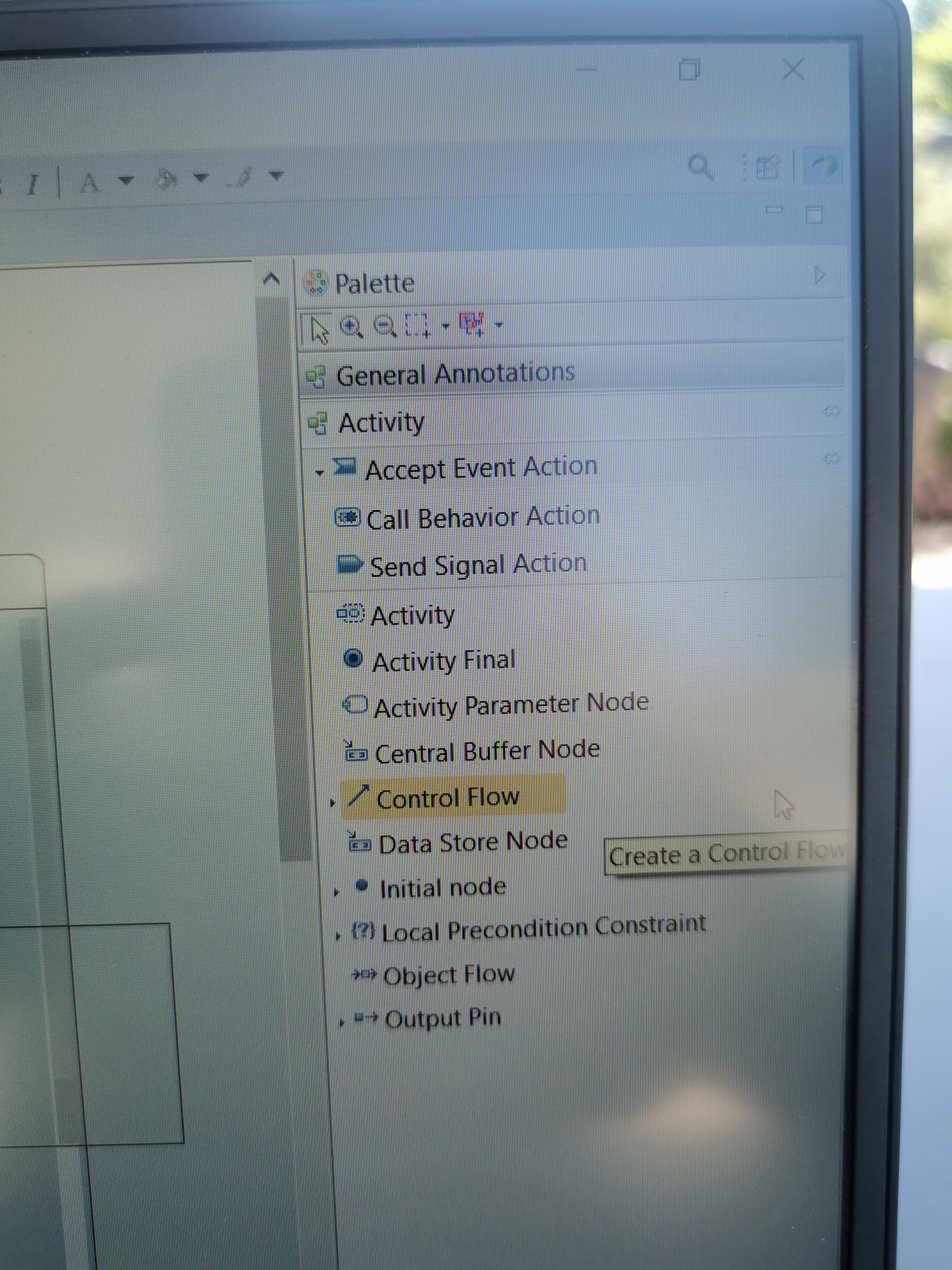

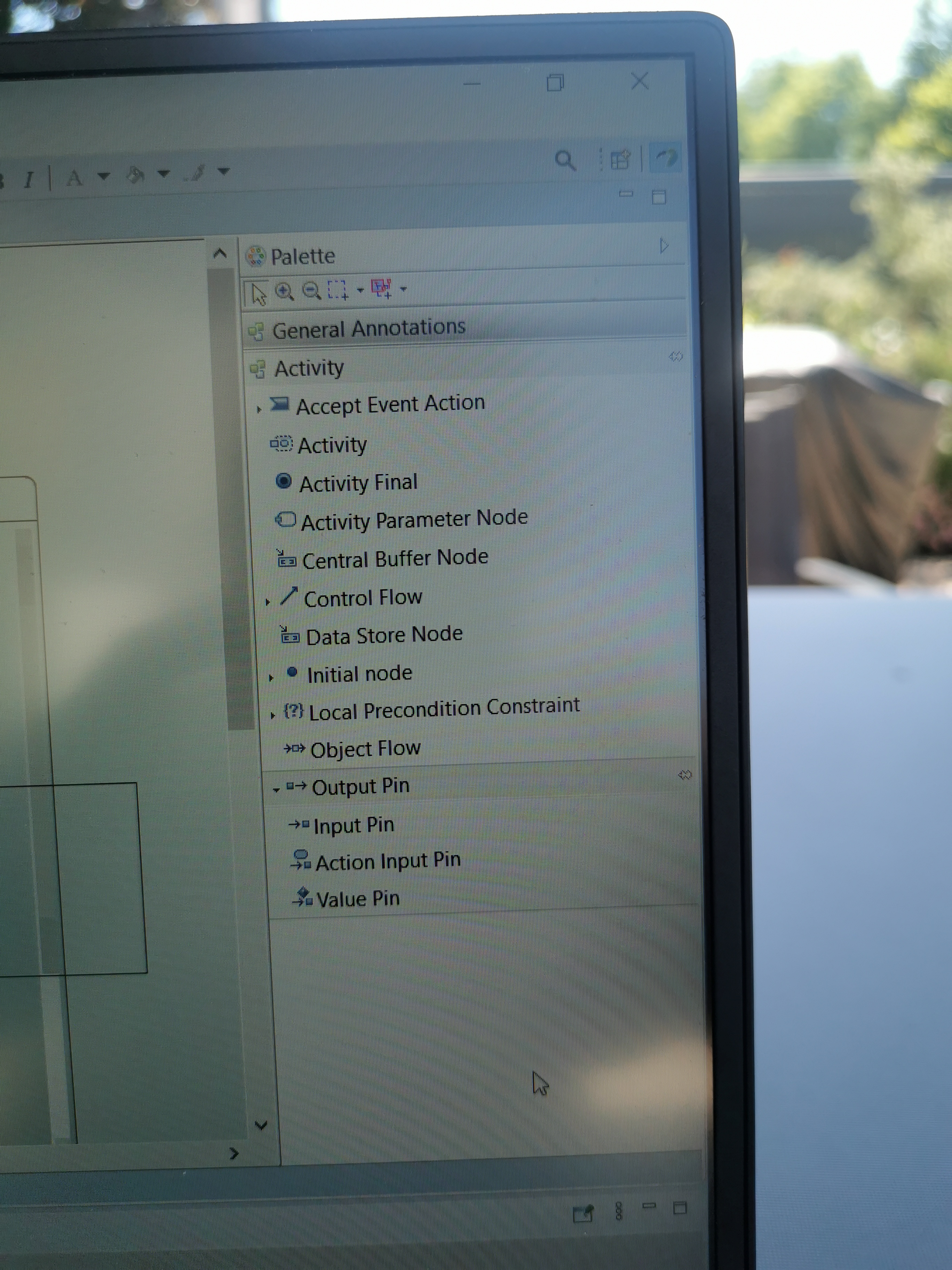

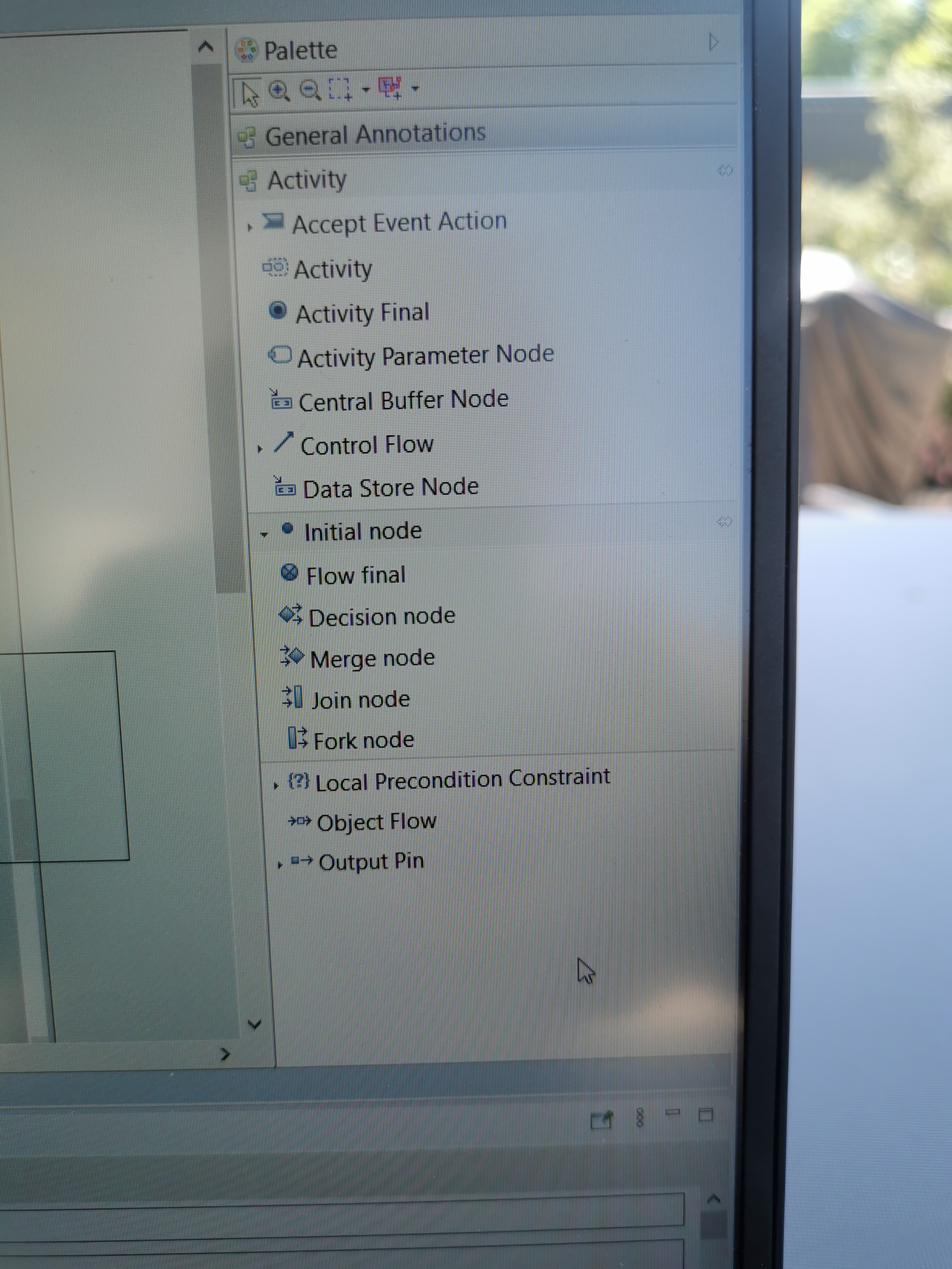

I don't have opaque action in my toolbar of activity diagram. Where I could find oaque action ?
thank you in advance for your help.

I don't have this tool group.
Re: Opaque Action [message #1829047 is a reply to message #1829041] Wed, 24 June 2020 06:24 Go to previous messageGo to next message
Is it stacked under the Accept Event Action?
HTH,
Christian
Re: Opaque Action [message #1829048 is a reply to message #1829047] Wed, 24 June 2020 06:31 Go to previous messageGo to next message
No
