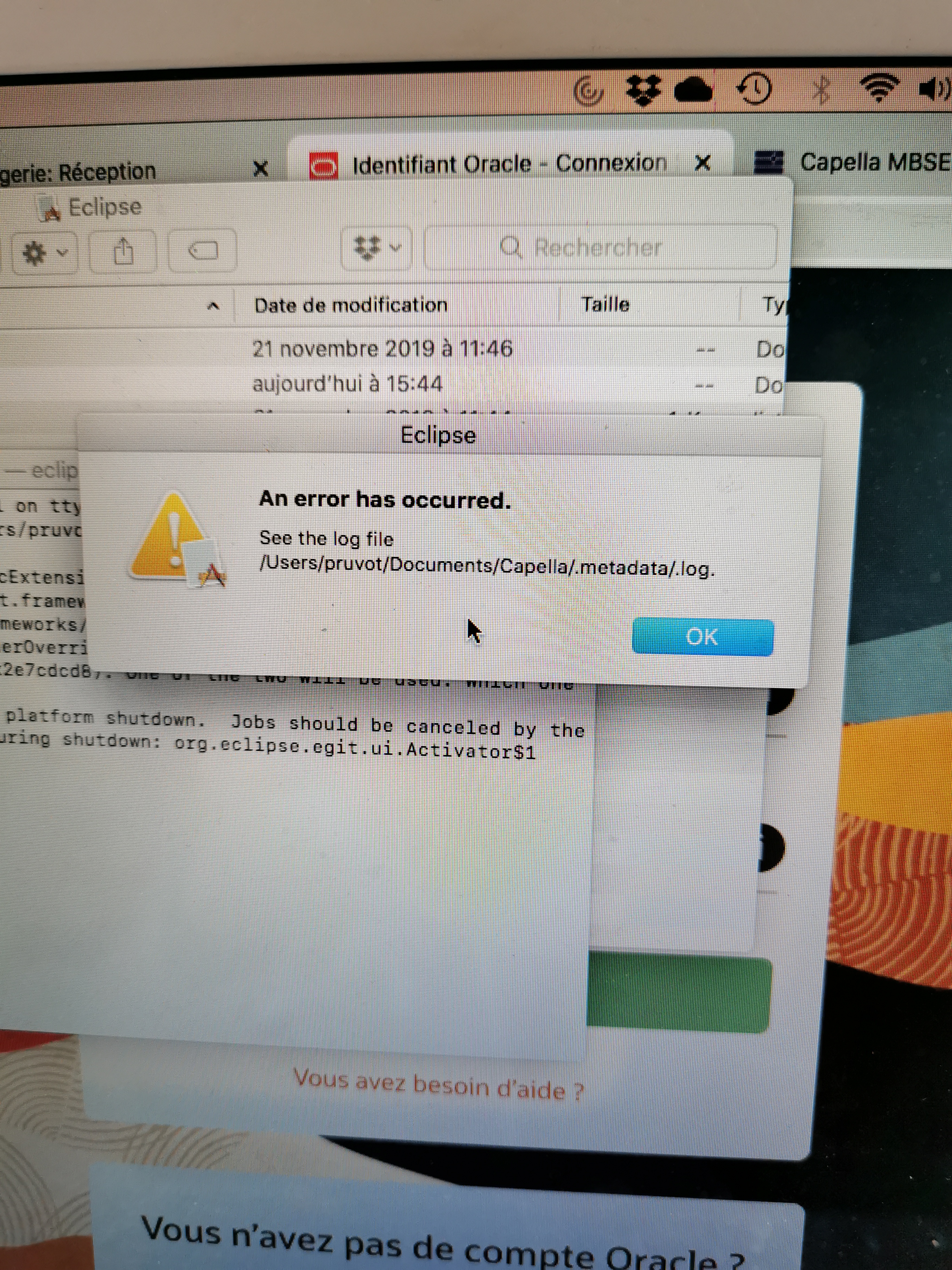

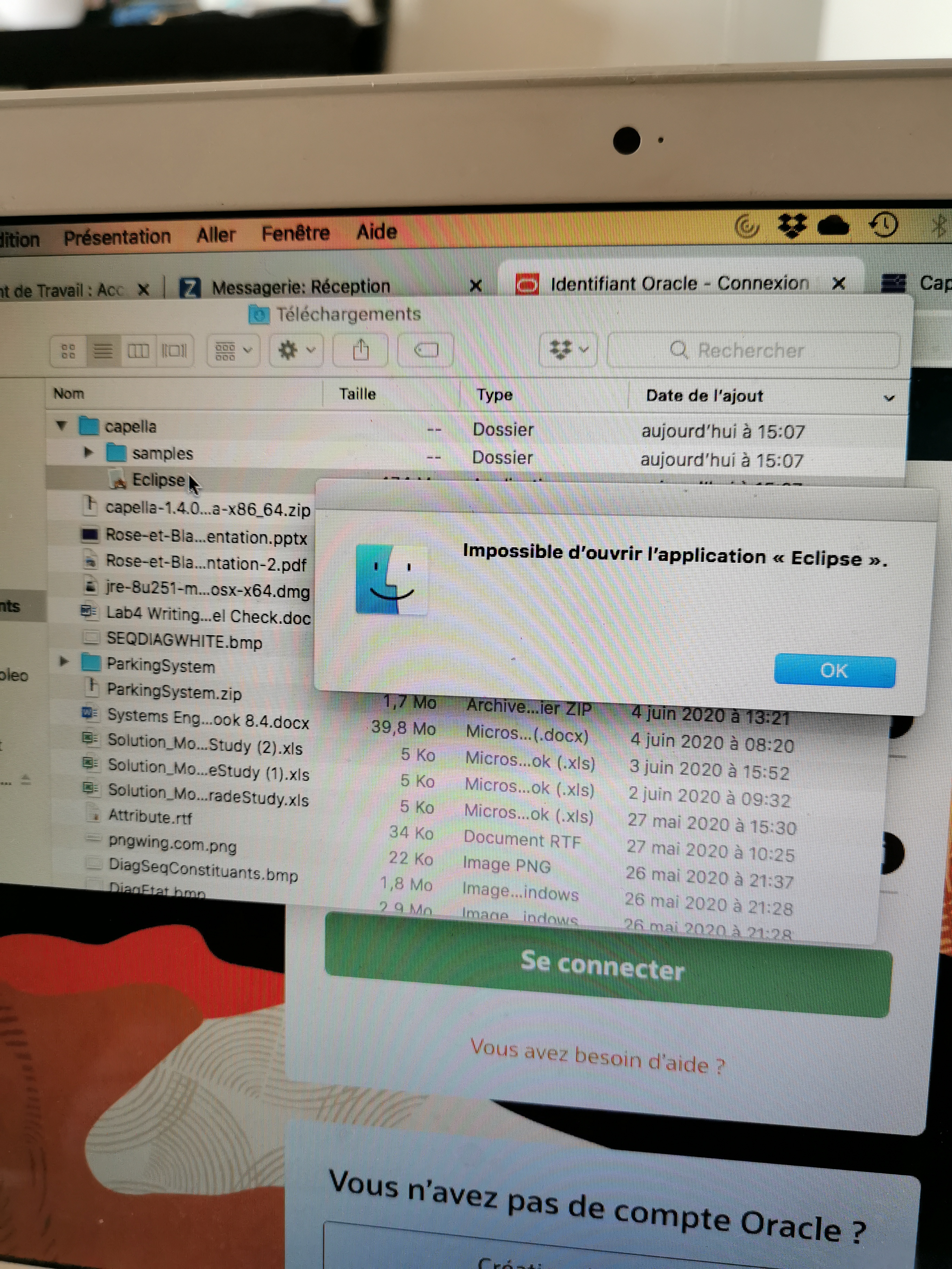

I downloaded capella for Mac but it's impossible to open it.
Everyone can help me?

Re: Capella problem [message #1828417 is a reply to message #1828369] Tue, 09 June 2020 09:11 Go to previous messageGo to next message
I did everything as you told me however it still doesn't work..
Thank you in advance for your help.
Re: Capella problem [message #1828422 is a reply to message #1828369] Tue, 09 June 2020 09:46 Go to previous messageGo to next message
Sorry I put the wrong screenshot.
This is the good one

Re: Capella problem [message #1828426 is a reply to message #1828422] Tue, 09 June 2020 10:08 Go to previous messageGo to next message
ok can you also share the log file that the popup is mentioning?

at org.eclipse.osgi.internal.framework.EquinoxBundle.loadClass(EquinoxBundle.java:620)
at org.eclipse.core.internal.registry.osgi.RegistryStrategyOSGI.createExecutableExtension(RegistryStrategyOSGI.java:196)
... 63 more
Caused by: org.osgi.framework.BundleException: Exception in org.polarsys.capella.core.sirius.analysis.activator.SiriusViewActivator.start() of bundle org.polarsys.capella.core.sirius.analysis.
at org.eclipse.osgi.internal.framework.BundleContextImpl.startActivator(BundleContextImpl.java:863)
at org.eclipse.osgi.internal.framework.BundleContextImpl.start(BundleContextImpl.java:791)
at org.eclipse.osgi.internal.framework.EquinoxBundle.startWorker0(EquinoxBundle.java:1013)
at org.eclipse.osgi.internal.framework.EquinoxBundle$EquinoxModule.startWorker(EquinoxBundle.java:365)
at org.eclipse.osgi.container.Module.doStart(Module.java:598)
at org.eclipse.osgi.container.Module.start(Module.java:462)
at org.eclipse.osgi.framework.util.SecureAction.start(SecureAction.java:493)
at org.eclipse.osgi.internal.hooks.EclipseLazyStarter.postFindLocalClass(EclipseLazyStarter.java:117)
... 73 more
Caused by: java.lang.NoClassDefFoundError: javax/xml/bind/JAXBException
at org.polarsys.capella.common.tools.report.config.registry.ReportManagerRegistry.<init>(ReportManagerRegistry.java:59)
at org.polarsys.capella.common.tools.report.config.registry.ReportManagerRegistry.getInstance(ReportManagerRegistry.java:111)
at org.polarsys.capella.core.commands.preferences.util.PreferencesHelper.<clinit>(PreferencesHelper.java:71)
at org.polarsys.capella.core.commands.preferences.service.AbstractPreferencesInitializer.<init>(AbstractPreferencesInitializer.java:36)
at org.polarsys.capella.core.sirius.analysis.preferences.DiagramPreferenceInitializer.<init>(DiagramPreferenceInitializer.java:20)
at org.polarsys.capella.core.sirius.analysis.activator.SiriusViewActivator.start(SiriusViewActivator.java:73)
at org.eclipse.osgi.internal.framework.BundleContextImpl$3.run(BundleContextImpl.java:842)
at org.eclipse.osgi.internal.framework.BundleContextImpl$3.run(BundleContextImpl.java:1)
at java.base/java.security.AccessController.doPrivileged(AccessController.java:554)
at org.eclipse.osgi.internal.framework.BundleContextImpl.startActivator(BundleContextImpl.java:834)
... 80 more
Caused by: java.lang.ClassNotFoundException: javax.xml.bind.JAXBException cannot be found by org.polarsys.capella.common.tools.report_1.4.0.201911211736
at org.eclipse.osgi.internal.loader.BundleLoader.findClassInternal(BundleLoader.java:512)
at org.eclipse.osgi.internal.loader.BundleLoader.findClass(BundleLoader.java:423)
at org.eclipse.osgi.internal.loader.BundleLoader.findClass(BundleLoader.java:415)
at org.eclipse.osgi.internal.loader.ModuleClassLoader.loadClass(ModuleClassLoader.java:155)
at java.base/java.lang.ClassLoader.loadClass(ClassLoader.java:521)
... 90 more
!SUBENTRY 1 org.eclipse.equinox.registry 4 1 2020-06-09 15:45:53.736
!MESSAGE Plug-in org.polarsys.capella.core.sirius.analysis was unable to load class org.polarsys.capella.core.sirius.analysis.activator.SiriusViewActivator.
!STACK 0
java.lang.ClassNotFoundException: An error occurred while automatically activating bundle org.polarsys.capella.core.sirius.analysis (635).
at org.eclipse.osgi.internal.hooks.EclipseLazyStarter.postFindLocalClass(EclipseLazyStarter.java:126)
at org.eclipse.osgi.internal.loader.classpath.ClasspathManager.findLocalClass(ClasspathManager.java:570)
at org.eclipse.osgi.internal.loader.ModuleClassLoader.findLocalClass(ModuleClassLoader.java:330)
at org.eclipse.osgi.internal.loader.BundleLoader.findLocalClass(BundleLoader.java:396)
at org.eclipse.osgi.internal.loader.BundleLoader.findClassInternal(BundleLoader.java:474)
at org.eclipse.core.internal.registry.ExtensionRegistry.createExecutableExtension(ExtensionRegistry.java:934)
at org.eclipse.core.internal.registry.ConfigurationElement.createExecutableExtension(ConfigurationElement.java:246)
at org.eclipse.core.internal.registry.ConfigurationElementHandle.createExecutableExtension(ConfigurationElementHandle.java:63)
at org.eclipse.sirius.common.tools.api.util.EclipseUtil.getExtensionPlugins(EclipseUtil.java:139)
at org.eclipse.sirius.common.tools.api.util.EclipseUtil.getExtensionPlugins(EclipseUtil.java:82)
at org.eclipse.sirius.business.internal.componentization.ViewpointRegistryImpl.initViewpointsFromPlugins(ViewpointRegistryImpl.java:709)
at org.eclipse.sirius.business.internal.componentization.ViewpointRegistryImpl.init(ViewpointRegistryImpl.java:194)
at org.eclipse.sirius.business.api.componentization.ViewpointRegistry$ViewpointRegistryHolder.<clinit>(ViewpointRegistry.java:137)
at org.eclipse.sirius.business.api.componentization.ViewpointRegistry.getInstance(ViewpointRegistry.java:123)
at org.polarsys.kitalpha.ad.integration.sirius.Activator.start(Activator.java:55)
at org.polarsys.kitalpha.ad.services.ToolIntegrationHelper.loadTools(ToolIntegrationHelper.java:27)
at org.polarsys.capella.core.af.integration.AFDelegateWorkbenchAdvisor.preStartup(AFDelegateWorkbenchAdvisor.java:25)
at org.polarsys.capella.core.model.handler.advisor.DelegateWorkbenchAdvisor$Helper.callPreStartup(DelegateWorkbenchAdvisor.java:45)
at org.polarsys.capella.core.platform.sirius.ui.app.CapellaWorkbenchAdvisor.preStartup(CapellaWorkbenchAdvisor.java:132)
at org.eclipse.ui.internal.Workbench$19.runWithException(Workbench.java:1703)
at org.eclipse.ui.internal.StartupThreading$StartupRunnable.run(StartupThreading.java:36)
at org.eclipse.swt.widgets.Synchronizer.syncExec(Synchronizer.java:236)
at org.eclipse.ui.internal.UISynchronizer.syncExec(UISynchronizer.java:146)
at org.eclipse.swt.widgets.Display.syncExec(Display.java:4975)
at org.eclipse.ui.internal.StartupThreading.runWithoutExceptions(StartupThreading.java:94)
at org.eclipse.ui.internal.Workbench.init(Workbench.java:1699)
at org.eclipse.ui.internal.Workbench.runUI(Workbench.java:2811)
at org.eclipse.ui.internal.Workbench.lambda$3(Workbench.java:623)
at org.eclipse.core.databinding.observable.Realm.runWithDefault(Realm.java:338)
at org.eclipse.ui.internal.Workbench.createAndRunWorkbench(Workbench.java:559)
at org.polarsys.capella.core.platform.sirius.ui.app.CapellaApplication.start(CapellaApplication.java:115)
at org.eclipse.core.runtime.internal.adaptor.EclipseAppLauncher.runApplication(EclipseAppLauncher.java:137)
at org.eclipse.core.runtime.internal.adaptor.EclipseAppLauncher.start(EclipseAppLauncher.java:107)
at org.eclipse.core.runtime.adaptor.EclipseStarter.run(EclipseStarter.java:400)
at java.base/jdk.internal.reflect.NativeMethodAccessorImpl.invoke(NativeMethodAccessorImpl.java:62)
at java.base/jdk.internal.reflect.DelegatingMethodAccessorImpl.invoke(DelegatingMethodAccessorImpl.java:43)
at java.base/java.lang.reflect.Method.invoke(Method.java:567)
at org.eclipse.equinox.launcher.Main.invokeFramework(Main.java:660)
at org.eclipse.equinox.launcher.Main.basicRun(Main.java:597)
at org.eclipse.equinox.launcher.Main.run(Main.java:1468)
... 73 more
... 80 more
... 90 more
!ENTRY org.eclipse.equinox.registry 4 1 2020-06-09 15:45:53.738
!STACK 0
!ENTRY org.eclipse.osgi 4 0 2020-06-09 15:45:53.833
!MESSAGE Application error
!STACK 1
java.lang.NoClassDefFoundError: org/polarsys/capella/common/tools/report/appenders/usage/UsageMonitoringLogger
at org.polarsys.capella.core.platform.sirius.ui.app.CapellaWorkbenchAdvisor.preStartup(CapellaWorkbenchAdvisor.java:140)
Re: Capella problem [message #1828429 is a reply to message #1828427] Tue, 09 June 2020 10:21 Go to previous messageGo to next message
Caused by: java.lang.ClassNotFoundException: An error occurred while automatically activating bundle org.polarsys.capella.common.tools.report.appenders.usage (523).
at org.eclipse.osgi.internal.loader.sources.SingleSourcePackage.loadClass(SingleSourcePackage.java:41)
at org.eclipse.osgi.internal.loader.BundleLoader.findClassInternal(BundleLoader.java:470)
... 26 more
Caused by: org.osgi.framework.BundleException: Exception in org.polarsys.capella.common.tools.report.appenders.usage.UsageAppenderPlugin.start() of bundle org.polarsys.capella.common.tools.report.appenders.usage.
... 35 more
Caused by: java.lang.NoClassDefFoundError: Could not initialize class org.polarsys.capella.core.commands.preferences.util.PreferencesHelper
at org.polarsys.capella.common.tools.report.appenders.usage.preferences.PreferencesInitializer.<init>(PreferencesInitializer.java:25)
at org.polarsys.capella.common.tools.report.appenders.usage.UsageAppenderPlugin.start(UsageAppenderPlugin.java:41)
... 42 more
!ENTRY org.eclipse.core.jobs 2 2 2020-06-09 15:45:54.604
!MESSAGE Job found still running after platform shutdown. Jobs should be canceled by the plugin that scheduled them during shutdown: org.eclipse.egit.ui.Activator$1
Re: Capella problem [message #1828430 is a reply to message #1828429] Tue, 09 June 2020 10:23 Go to previous messageGo to next message
ok so the problem is that Capella is picking up java 13 instead of java 8.
You can see it at this line at the beginning of your log file: java.version=13.0.2
Try uninstalling this java version.
Re: Capella problem [message #1828475 is a reply to message #1828430] Wed, 10 June 2020 08:14 Go to previous messageGo to next message
I downloaded java on your website https://www.oracle.com/technetwork/java/javase/downloads/java-archive-javase8-2177648.html but it's Java 13 and I didn't find Java 8. I don't know where I can find Java 8 version.
Re: Capella problem [message #1828485 is a reply to message #1828475] Wed, 10 June 2020 10:45 Go to previous message
ok in the url you mentioned, you should look for this file to download and install: jre-8u121-macosx-x64.tar.gz
This is java 1.8 update 121 64 bits and this will work on Capella.
Before doing this, you should also uninstall java 13 from your machine.
