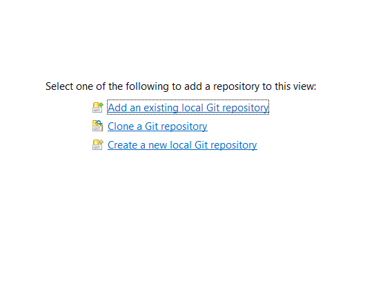

1. Add an existing local repository
index.php/fa/38219/0/

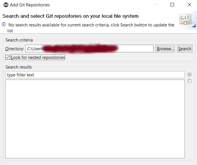

2. Go to the local path where the repository is available
index.php/fa/38220/0/
As we can see the projects are not getting listed in the search dialog box.

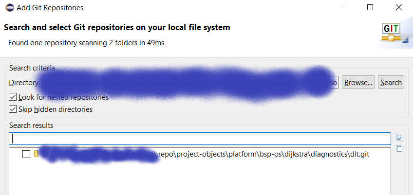

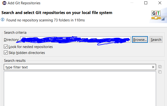

1) When I search the working dir, where the source code is available.
index.php/fa/38232/0/
2) When I search the .repo alone,
index.php/fa/38233/0/
Here we can see the .git inside the " .repo direcotry" is getting recognized, but we need the .git inside the source code folder to be recognized.

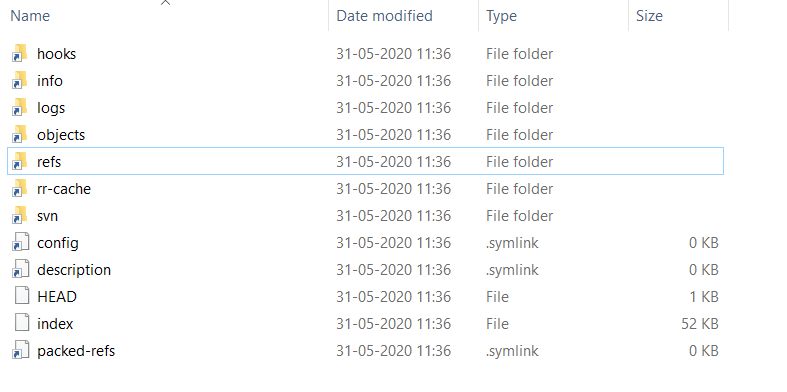

Also I could see , the sub directories such as objects, refs, inside .git of source code folder are symlinks pointing to corresponding objects, refs of .repo

Re: EGit not recognising git repositories downloaded using repo tool [message #1828195 is a reply to message #1828157] Wed, 03 June 2020 10:55 Go to previous message
Symlinks are not files. I'm not even sure JGit could work with such a fake .git directory. And JGit doesn't support git-worktree (multiple working trees per git repo) yet.
