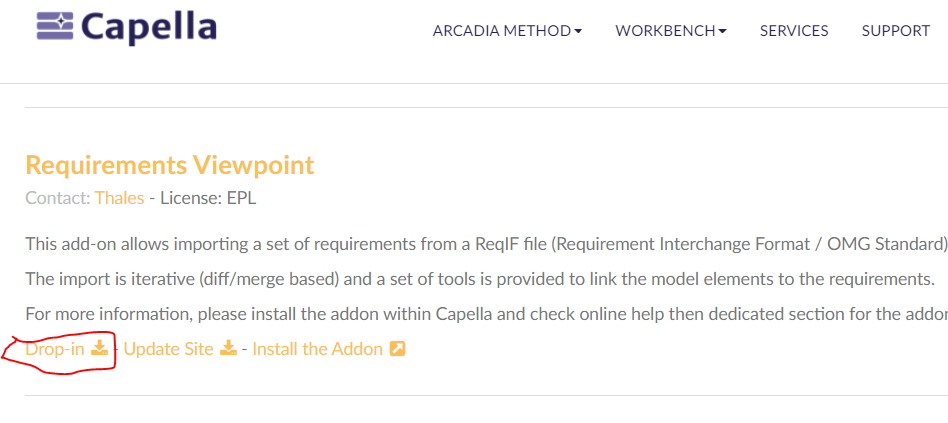

1- Open this link that leads to the set of capella viewpoints and download the requirements addon in this case.
https://www.eclipse.org/capella/addons.html
index.php/fa/38099/0/

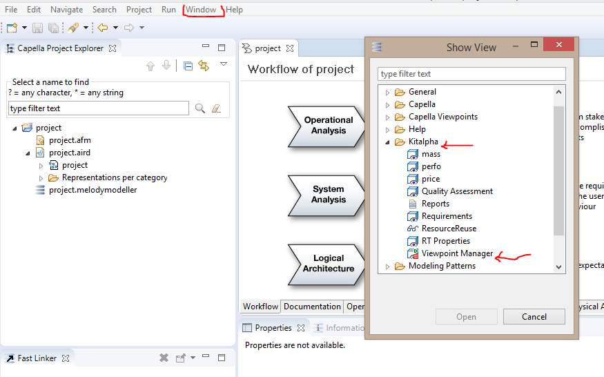

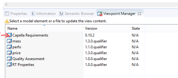

5- Once capella starts, open the viewpoint manager in the menu "window => show view => other => kitalpha"
index.php/fa/38100/0/
index.php/fa/38101/0/
6- Right Click on the viewpoint entry and choose refrence with green play button. You will notice that the state of the viewpoint changes to "active".

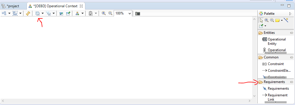

7- You can toggle now the layer provided by the requirements viewpoints as follows
index.php/fa/38103/0/
You will notice that a new tool folder apprears in the tools palette.
