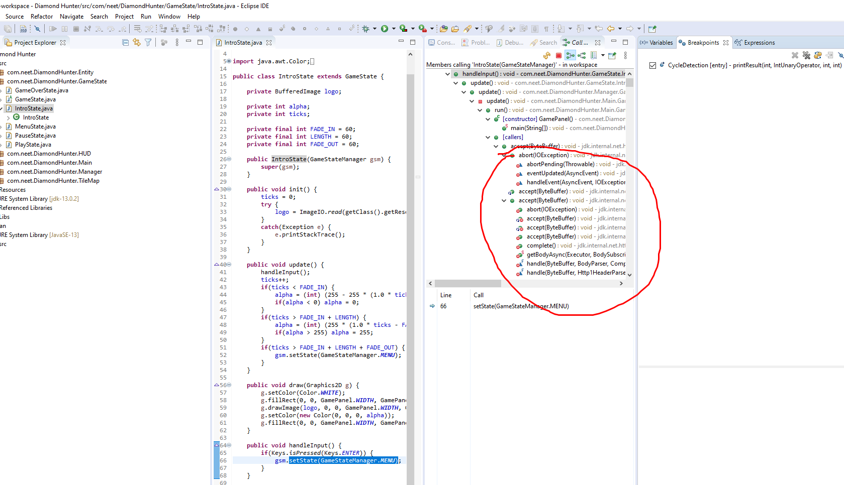

why is the limit in call hierarchy

Likely for performance reasons. I guess your actual question is "can I increase Call Hierarchy view's depth?" in which case the answer would be:
  1. Open Call Hierarchy view's menu (the reverse triangle in the upper right corner)
  2. Filters...
  3. Increase "Max call depth" value
As a side note, "this picture will show you here" is not really an explicit title. Please use a clearer one next time (e.g. "How do I increase the depth of the Call Hierarchy view?"): people from the forum will be more likely to read your question and answer it, and people facing the same issue will more easily find this thread.
