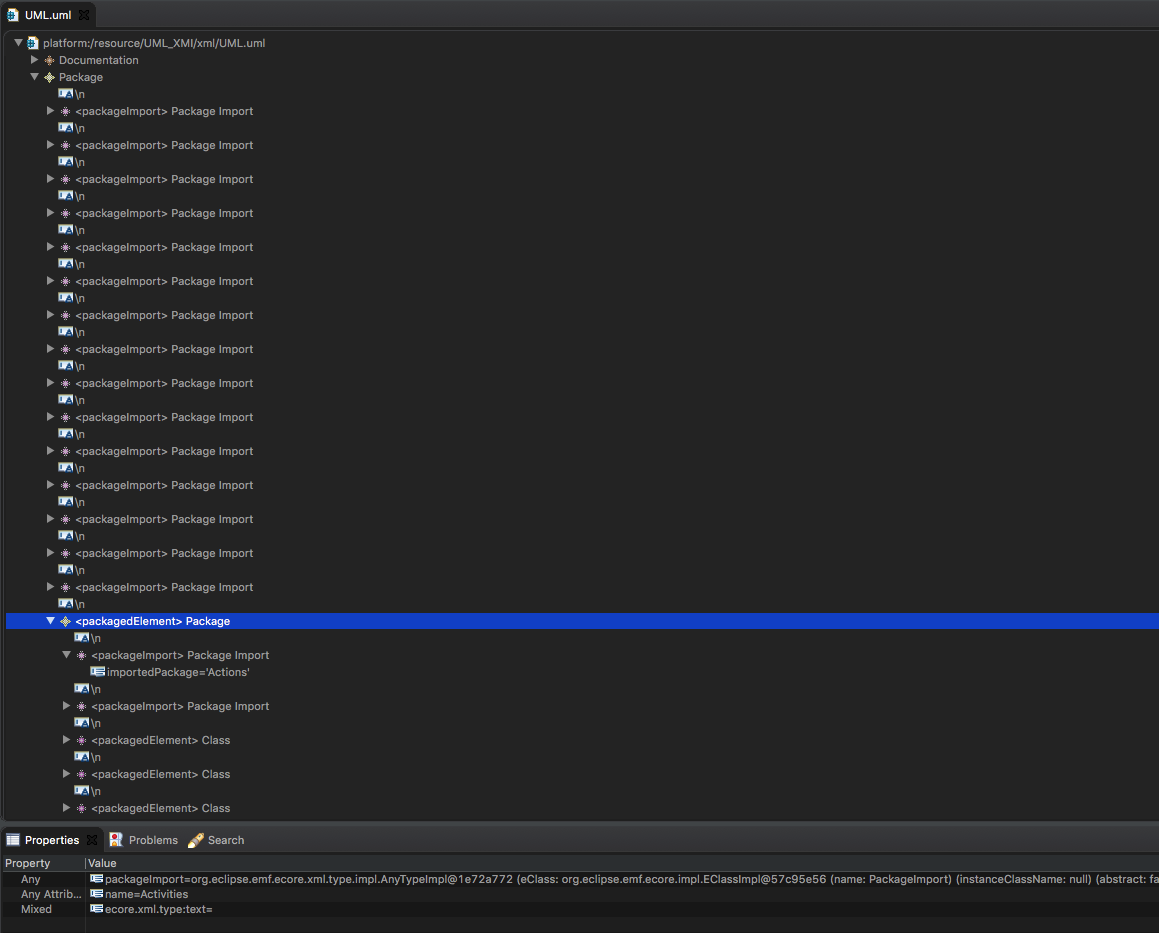

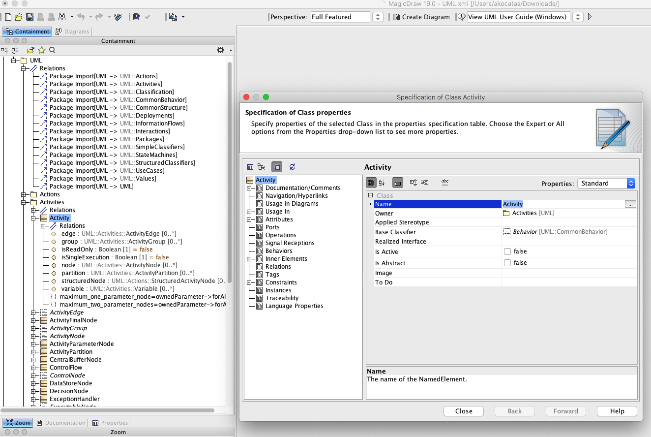

In order to better understand the relations between elements of the UML metamodel, I have downloaded the abstract syntax metamodel from OMG for latest UML specification (UML 2.5.1).
I have successfully imported the UML.xmi file into MagicDraw, which is a commercial tool, however, I could not succeed using either Papyrus or Eclipse Modeling Tools IDE.
There were past topics about opening xmi files, I have reviewed them all. The only solution which kind of works for me is to rename the UML.xmi file as UML.uml and then open with the UML diagram editor. Then, I can open the file, but the way the elements are viewed looks like a bit problematic.
I have attached a screenshots of the views I get in both tools.
Is this normal behavior? Or am I missing something? Is there any way that I can get a nice view of the metamodel in Eclipse, just like the one in MagicDraw?

The UML project only supports the exact URIs for which it was built. These are probably for exactly UML 2.5. My attempts at making it externsible for development/later versions have been rebuffed.
OMG churns URIs amost as if they wanted to guarantee that tool interoperability fails.
If your *.xmi is erxactly UML 2.5 it might work.
Much better to change to *.uml AND change to the http://www.eclipse.org/uml2/5.0.0/UML URI. It looks as if you only made the first change.
In general take a working *.uml file and make your file look the same.
If you post your UML 2.5.1 file it could be investigated.

Thanks a lot for your responses. I have managed to load the UML.xmi from OMG using the find/replace suggestions and commenting out the documentation block at the beginning and moftext tag at the end of the document. Afterwards, the UML.xmi can be directly opened with UML Model Editor.
Isn't it interesting that MagicDraw can load the document without any complaints? I have checked the loaded model there and could not find the text stated in the <documentation> tag in the beginning. Therefore, it looks like MagicDraw just ignored it without any complaints. As for the primitive types, it looks like it has resolved them.
