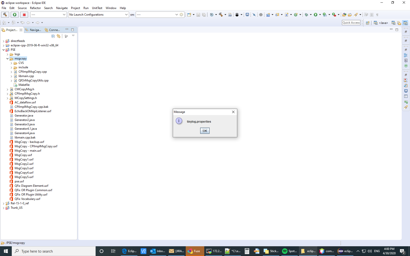

Re: How to use tinylog in Eclipse plugin [message #1826766 is a reply to message #1826753] Thu, 30 April 2020 04:03 Go to previous messageGo to next message
thanks for the suggestion!
eclipse.ini :
-startup
plugins/org.eclipse.equinox.launcher_1.5.100.v20180827-1352.jar
--launcher.library
plugins/org.eclipse.equinox.launcher.win32.win32.x86_64_1.1.800.v20180827-1352
-product
org.eclipse.epp.package.cpp.product
-showsplash
org.eclipse.epp.package.common
--launcher.defaultAction
openFile
openFile
--launcher.appendVmargs
-vmargs
-Dosgi.requiredJavaVersion=1.8
-Dtinylog.configuration=tinylog.properties
-Dosgi.instance.area.default=@user.home/eclipse-workspace
-XX:+UseG1GC
-XX:+UseStringDeduplication
--add-modules=ALL-SYSTEM
-Dosgi.dataAreaRequiresExplicitInit=true
-Xms256m
-Xmx1024m
-Dbundles.configuration.location=configuration
I modified my code to use JOptionPane to show
public Object execute(ExecutionEvent event) throws ExecutionException {
IWorkbenchWindow window = HandlerUtil.getActiveWorkbenchWindowChecked(event);
generateUTSrc(event);
return null;
public void generateUTSrc(ExecutionEvent event)
JOptionPane.showMessageDialog(null,System.getProperty("tinylog.configuration"));
Logger.debug("generateUTSrc");
please kindly check attached file content.

Re: How to use tinylog in Eclipse plugin [message #1826767 is a reply to message #1826765] Thu, 30 April 2020 04:05 Go to previous messageGo to next message
that's great. then it's UMLet issue. cheers!
