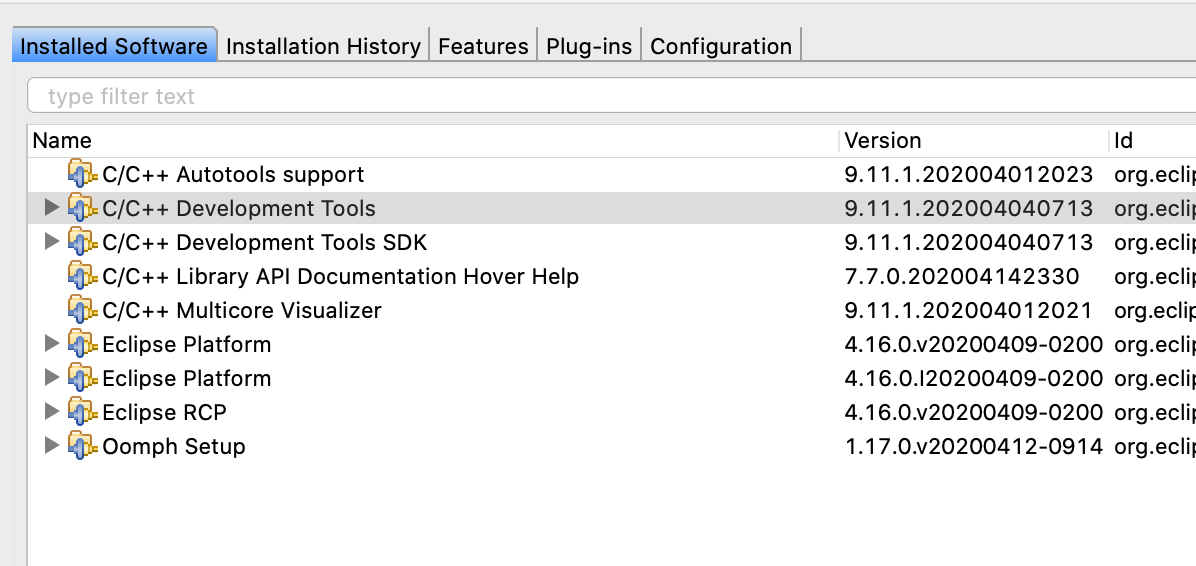

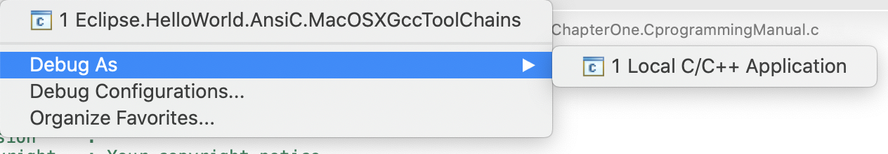

I found that >50% of the time when I attempt to debug, the system progress hangs. I'll keep debug as I have time.
When I hit the 'debug' button, the progress indicator will stall around 96%. The the debugger is started, and can be terminated or relaunched. Whether relaunched or using the 'debug' button, the % success is no better then 50% of the time. Once successful, the debugging session is 100% functional.
I've attached a list of the installed Eclipse components, a picture showing that I'm only using local debugging, and a picture showing the "debug" windows stalled and functioning processes.
Any suggestions on debugging further?
sw config
GDB 9.1, MacOS 10.15, Eclipse 2020/06, CDT 9.11.1.202004040713, Java 1.8.0_131-b11

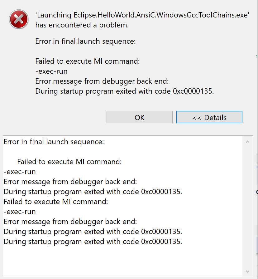

Re: Problems with GDB with Eclipse for C/C++ on MacOS [message #1826552 is a reply to message #1826546] Mon, 27 April 2020 00:40 Go to previous messageGo to next message
On Windows 10 (1909) with Java 8u241 and GDB 9.1-1 and the same Eclipse 2020-06 (CDT 9.11.1) release, I am consistently getting:
Error in final launch sequence:
Failed to execute MI command
-exec-run
Error message from debugger back end:
During startup program existed with code 0xc0000135
I'd say :) cool :) - cause
a) Eclipse / CDT launched GDB
b) seems to have tried a few MI commands
c) fails on the exec-run for unknown reason
I'd prefer to stick with MacOS, though, anyone know how to monitor the communication between Eclipse and GDB so I can see what's happening more (either OS)?

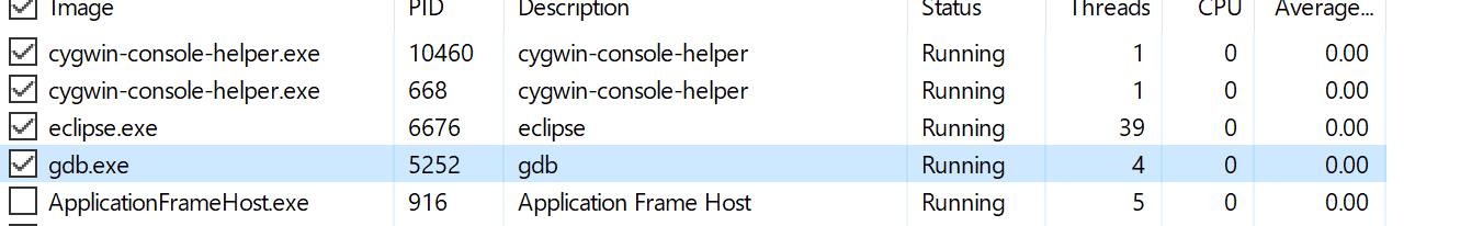

Re: Problems with GDB with Eclipse for C/C++ on MacOS [message #1826553 is a reply to message #1826552] Mon, 27 April 2020 00:52 Go to previous messageGo to next message
seems I am having a different issue than Kirk Bailey had, as gdb is a running process (see attachment) under windows.
I also found two IBM articles, with some details, yet no description of tools to monitor the communications between eclipse and gdb.
Anyone have info on how to monitor?
I will do on either Windows or MacOS, yet prefer to stay on MacOS.

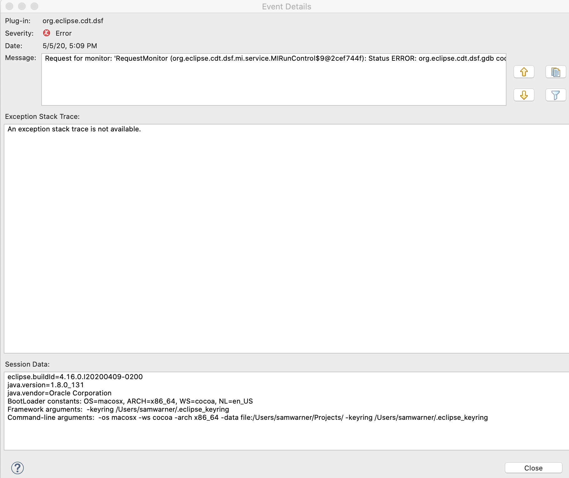

Re: Problems with GDB with Eclipse for C/C++ on MacOS [message #1826996 is a reply to message #1826554] Tue, 05 May 2020 20:23 Go to previous messageGo to next message
More info, in case anyone else is encountering the same issue.
In the "error.log" tab (once shown via selecting under "Show View") there is a record for every failed launch of GDB with:
Request for monitor: 'RequestMonitor
org.eclipse.cdt.dsf.mi.service.MIRunControl$9@e0fbf58):
Status ERROR:
org.eclipse.cdt.dsf.gdb code=10001
Context cannot be suspended.
null' resulted in an error.
and "An exception stack trace is not available."
with session data of:
eclipse.buildId=4.16.0.I20200409-0200
java.version=1.8.0_131
BootLoader constants: OS=macosx, ARCH=x86_64, WS=cocoa, NL=en_US
Framework arguments: -keyring /Users/samwarner/.eclipse_keyring
Command-line arguments: -os macosx -ws cocoa -arch x86_64 -data
file:/Users/samwarner/Projects/ -keyring
Re: Problems with GDB with Eclipse for C/C++ on MacOS [message #1827007 is a reply to message #1826996] Wed, 06 May 2020 02:08 Go to previous messageGo to next message
During startup program existed [exited?] with code 0xc0000135
0xC0000135 is a Windows error code.
It's often caused by a missing DLL or a DLL that didn't initialize properly.
It's seems to be occurring when GDB tries to start the program to debug
see exec-run in
https://sourceware.org/gdb/onlinedocs/gdb/GDB_002fMI-Program-Execution.html#GDB_002fMI-Program-Execution
You'll have to figure out what went wrong and fix it.
Fixing Windows problems is out side the scope of this forum.

Re: Problems with GDB with Eclipse for C/C++ on MacOS [message #1827048 is a reply to message #1827024] Wed, 06 May 2020 07:57 Go to previous messageGo to next message
https://www.eclipse.org/forums/index.php?t=msg&th=1103519&goto=1826552&#msg_1826552
For my Windows redo of the Mac configuration using Eclipse/CDT/GDB, the error was only occurring >50% of the time.
We have different definitions of the word consistent
I tend to call the latter intermittent
You seem to be focusing on Eclipse's response to GDB giving up.
Granted, it could be better.
That you got the Windows error at all is a big clue.
It's not being caused by Eclipse although possibly caused by the runtime setup.
It really means Windows encountered a problem and GDB is telling you it happens at program start.
Fixing the execution and load path is only one of the possible solutions.
It's an old fallback error message which used to result in a blue screen on occasion.
https://wikifixes.com/errors/0x/0xc0000135/
https://stefanoborini.com/windows-dll-search-path/
That same problem is likely causing the similar Mac response as well.
But do feel free to spin your wheels.
Good luck.
