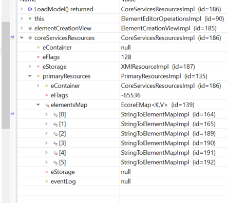

The very first time I load the file, there is no problem. If there are two elements
in the file, I see two elements in memory.
index.php/fa/37917/0/
If I then add a new element, I see three elements in memory. I then save the model, and see three elements in the file.
I then load the file again, and now I see six elements in memory.
index.php/fa/37918/0/
If I add a new element and save, there are now seven elements in the file.

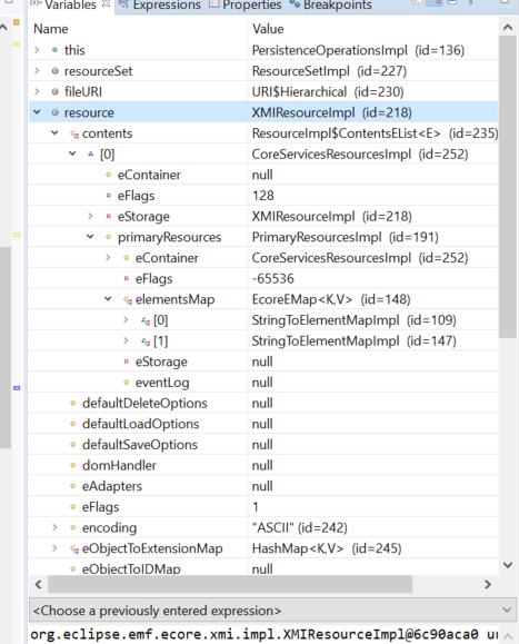

What strikes me in your debugging session is that you have two different resources loaded in memory (CoreServicesResourceImpl id=114 and id=186) but they share the same in memory elementsMap (ECoreEmap id=139). So this explains the observed behavior.
The question is how did you end up with two different resources sharing the same elementsMap?
can you share the code of your loadModel() method ?

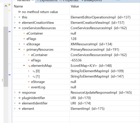

Here are the results of another debugging session, this time with a breakpoint in the StringToElementMapImpl constructor, as Ed suggested.
The file contains one element e1.
I load the file, and add element e2. At this point the model in memory looks like this:
index.php/fa/37919/0/
I save the model to file, and then load the file again.
I have a breakpoint inside the StringToElementMapImpl ctor, so I can check to see how the map is looking at this stage. It should be empty, but it is not:
index.php/fa/37920/0/
Interestingly, as German pointed out earlier, although the coreResources object is new, the primaryResources (and the elementsMap inside) have the same id. I don't know why that is - in our model coreResources has an EReference to primaryResources, and the Containment property is set to true.

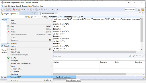

Your problem sparked my curiosity, so I made a small project trying to recreate your problem, you will find it attached to this post.
For me it is working as expected in EMF 2.20 and 2.21
I defined an ecore model similar to yours ... now I know how maps work in EMF :) .. and added a menu entry to start the test.
just right-click on a project and you will find the menu
index.php/fa/37923/0/
I copied a variation of your code in class test.mypackage.MyHandler, and made my own versions of adding to the map and saving.
Everything seems to be working as expected. Can you test my project in your configuration ?
  • Attachment: testmap.zip
    (Size: 40.85KB, Downloaded 50 times)
  • Attachment: testmap.png
    (Size: 67.87KB, Downloaded 207 times)

Ah - found the problem.
I had originally thought that primaryResources was going to be loaded once and held in memory as a singleton. So to make that happen I overrode createPrimaryResources in CoreFactoryImpl.java. Here's the offending code:
	 * <!-- begin-user-doc -->
	 * Overridden the default in order to create a singleton.
	 * <!-- end-user-doc --
	public PrimaryResources createPrimaryResources() {
		if (primaryResources == null) {
			primaryResources = new PrimaryResourcesImpl();
		return primaryResources;
I'd completely forgotten that I'd done that! It wasn't until I started putting breakpoints around the PrimaryResources constructor that I found it again. I deleted my method, regenerated the code and now everything's fine.
Many thanks to everyone for taking the time to help me out with this, I really appreciate it.
