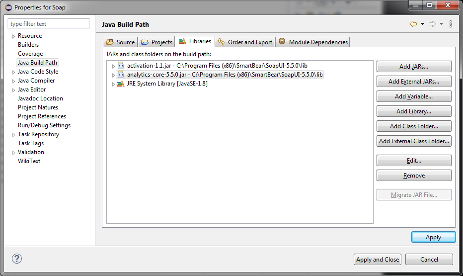

It did appear to happen when I tried to add multiple External JARs at the same time.
Going through one by one doesn't mess up the path.
In that case, when going through the Java Build Path > Library, is there a way to add all JARs from a directory without having to add and apply each one individually?
  • Attachment: jars.png
    (Size: 54.47KB, Downloaded 221 times)
Re: Illegal Char <*> error in jar path [message #1824282 is a reply to message #1824280] Sun, 12 April 2020 12:38 Go to previous messageGo to next message
You would need to use multiple selection to select the many jars you want to add.

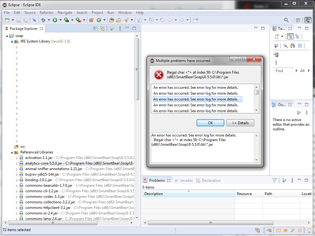

Is there a limit to how many JAR files can be imported? Seems at some point I get the <*> error even when adding individually
Re: Illegal Char <*> error in jar path [message #1824287 is a reply to message #1824285] Sun, 12 April 2020 19:42 Go to previous messageGo to next message
For reference (attached), after adding around 72 external jars, the error popped up and clicking on any jars part of the current project gets the same error.
  • Attachment: eclipse.png
    (Size: 123.58KB, Downloaded 208 times)
Re: Illegal Char <*> error in jar path [message #1824289 is a reply to message #1824287] Mon, 13 April 2020 00:02 Go to previous messageGo to next message
I was able to add 101 just now, so no I don't think there is a limit. The message suggests there is still a file with a *.jar specified in it. This information is stored in each project in <project>/.classpath. This file is hidden by default. Use the view menu icon (the vertical ... ) and use Filter... to not hide ".* resources". Then you can use Search -> File... to search for "*"; you'll need to escape it, i.e., search for "\*" in files named .classpath.
