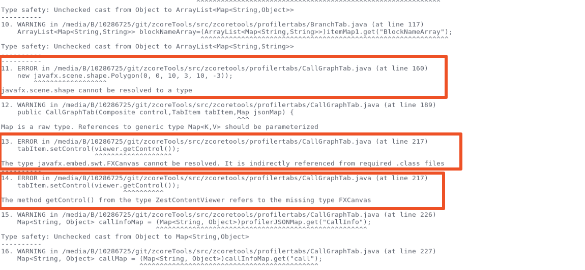

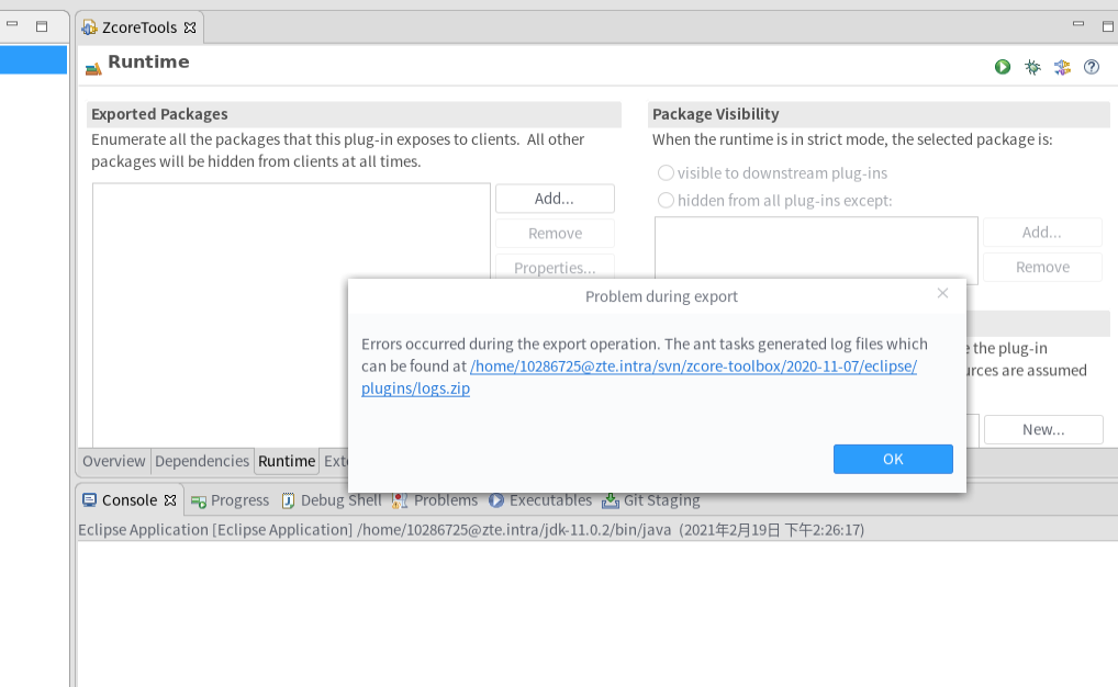

Re: How to - set up eclipse development with open JFX Java > 8 [message #1838238 is a reply to message #1822581] Fri, 19 February 2021 03:26 Go to previous messageGo to next message
i follow the procedure as you described above, so i can successfully debug and
run gef,javafx based eclipse plugin application,but when i export the plugin and install the plugin,i got errors from eclipse shown below.
my question is ,what should i do to export the eclipse plugin successfully?
