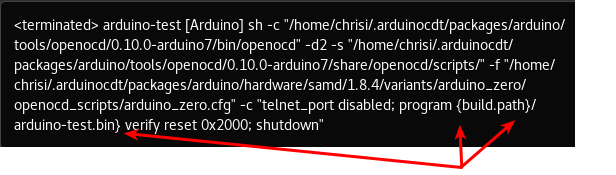

I am trying to program an Arduino Zero with Eclipse but I think the problem I'm having isn't too specific to not be solved here. If this is the wrong subforum, sorry, it's my first post and it seemed appropriate.
When trying to upload a freshly built binary to the board I get the following error on the console (relevant part at the end):
** Programming Started **
auto erase enabled
Error: couldn't open build.path/arduino-test.bin}
embedded:startup.tcl:477: Error: ** Programming Failed **
in procedure 'program'
in procedure 'program_error' called at file "embedded:startup.tcl", line 536
at file "embedded:startup.tcl", line 477
I have checked and the build runs fine. I even tried moving around arduino-test.bin a bit to see if it would be found but that didn't happen.
Then I realized that when I move my mouse over the top line in the console it would show me the command it used for uploading to the Arduino. At least I think it shows this command. As you can see on the picture I think it has mismatching brackets.
index.php/fa/37472/0/
What do you guys think? Can I solve this problem? I think I could by changing the corresponding file but I am not too used to reading these errors, so I can't deduct how the file is called. Or am I totally on the wrong path here?
