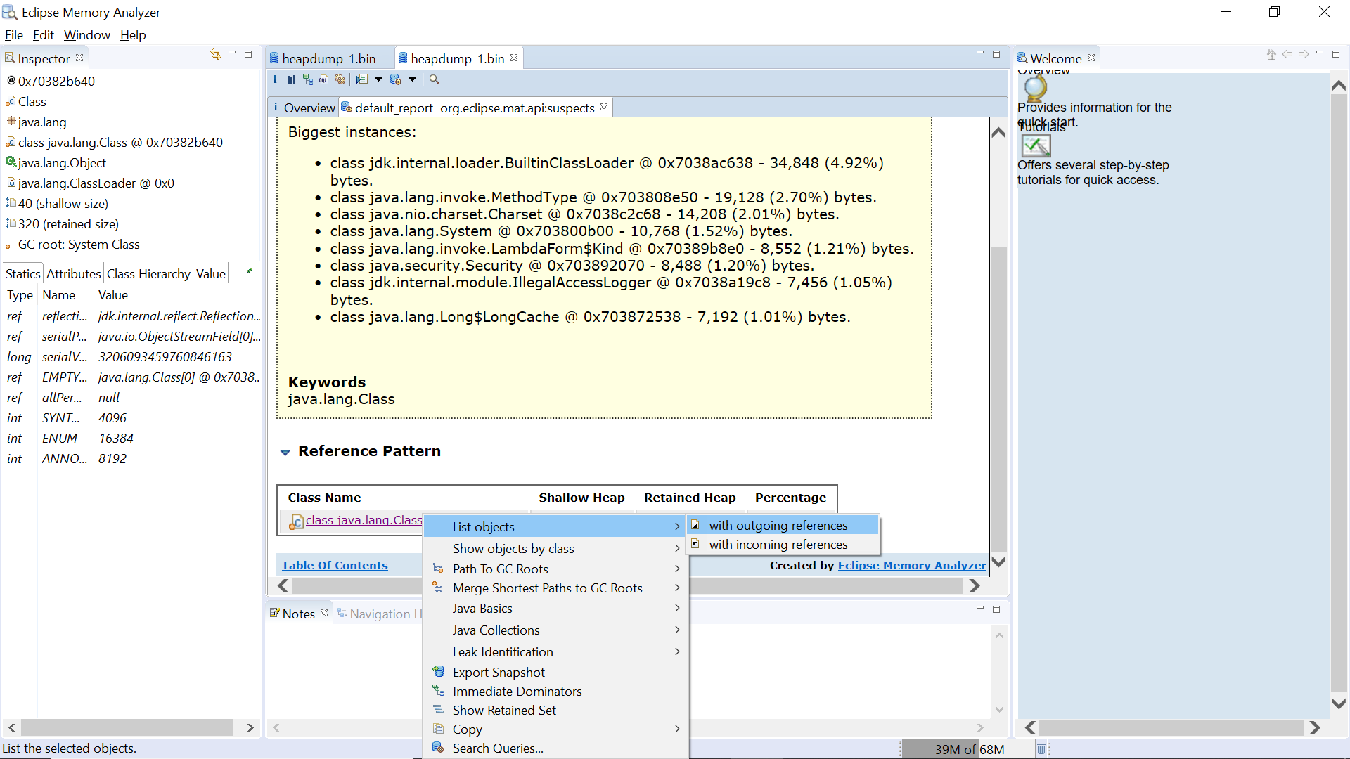

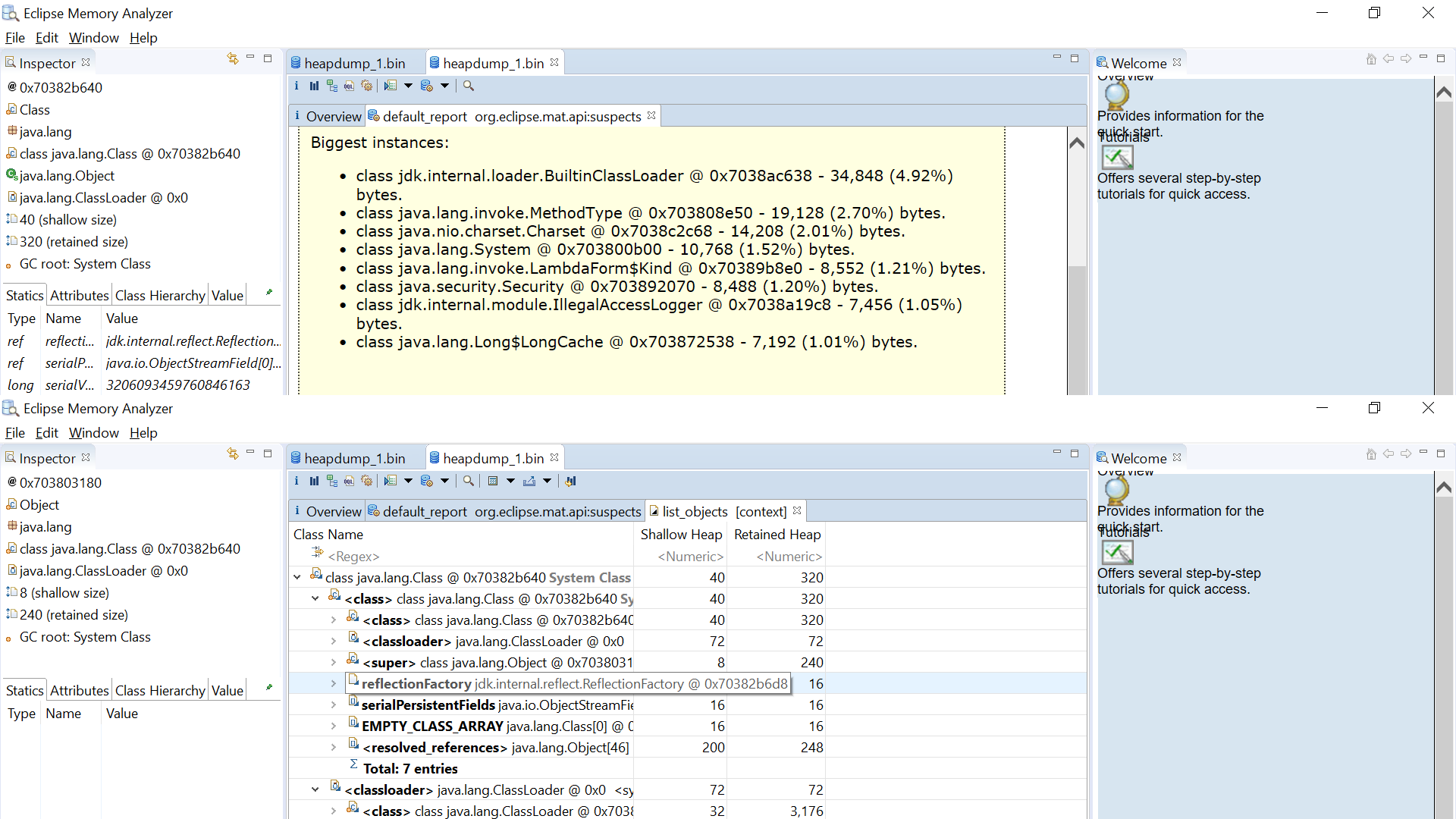

Hello, I am trying to generate a HTML viewable report using the ParseHeapDump.bat file. I am able to the suspect , overview and top components report. I need to be able to browse the list_objects properties of the suspects in the same tree manner that is shown in the GUI (see image 1&2).
I tried to run it as a query like this:
query name="Dominator Tree">
		<command>dominator_tree</command>
		<command>list_objects</command>
</query>
This causes an error to be thrown which says parameter objects is required for list_objects. I have no idea how to pass this parameter, for example for java.lang or some other suspects. Please advice

There is not a way to do this directly from the leak suspects report.
The list_objects command expects object addresses or class names or patterns or an OQL query but there isn't a way to extra that from the leak suspects report to add to a new report. To test the command line then use OpenQuery Browser > Search Queries to bring a up a command line where you can type:
list_objects 0x12345678
or
list_objects java.lang.*
If there isn't enough information in the report and it seems a general problem then in a future release we could enhance the suspect report.
I suppose you could parse the report yourself and run a new report with the extracted information. See https://wiki.eclipse.org/MemoryAnalyzer/Extending_Memory_Analyzer#Reports_in_Memory_Analyzer for how to write reports. You can pass in command line parameters as
-myparm=myvalue
which can then be read using
${myparm}
in the XML of a new report definition.
