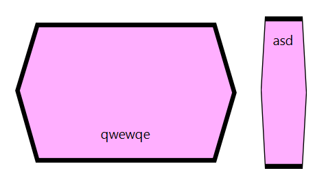

It seems that svg shapes aren't fully supported. Please see attached screenshot. There are 3 problems:
1) A node label is not centered vertically.
2) Border is scaled. I added vector-effect="non-scaling-stroke" but it doesn't help.
3) Also when I drag a node it's resized randomly.
Can you please help to fix it?
Here is the svg shape:

Sorry for spam. As always you spend hours to fix something. Then just ask an answer and the problem is auto-fixed.
Label vertical alignment is fixed by using org.eclipse.sirius.diagram.customBundledImageShape. See https://www.eclipse.org/forums/index.php/t/1102384/
Random node resizing could be related to odesign and svg files updating.
However I still have ugly scaled borders (please see the screenshot above). Can it be fixed somehow?

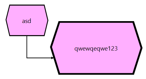

Actually I don't need exactly this attribute. I need all the lines on the diagrams to have the same width. Please see the attache screenshot. Line widths depends on shape sizes.

Stroke width scaling is a normal svg behaviour. I think it's ok for most of the applications. If one resizes an ordinary image, he expects that all parts of the image are scaled. However it's not desirable for a diagram editor.
